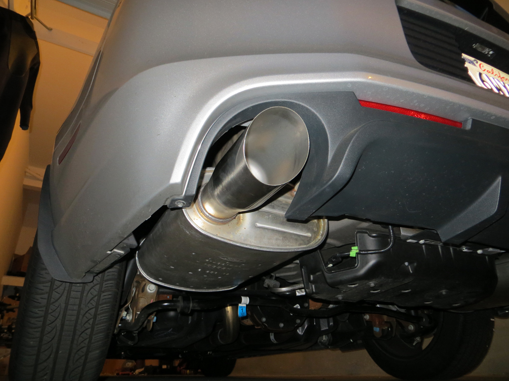

Installing the new mufflers was nearly impossible, by myself, without taking off the hanger brackets. I figured this out after about 30 minutes of unsuccessfully trying to guide the passenger side muffler into the brackets. In fact, it's only the one hanger without the stopper on it that I couldn't get into the bracket. Anyway, the driver side bracket is held on with three 13mm hex bolts and is super easy to take off after the stock mufflers are out.

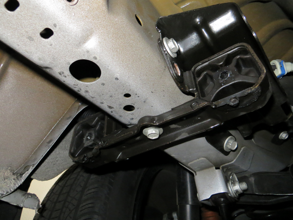

The passenger side hanger bracket is held on by two of the same screws. In my photo, it looks like there's a third screw in the back, but that's not connected to the bracket.

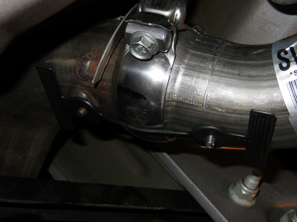

Unlike I had read in other forum posts and seen on YouTube, the mufflers I ordered came supplied with a tack-welded pipe clamp and 13mm hex bolt. So, I did not have to reuse the stock clamp (which I discovered only after I had wiggled it off!) and bolt. That was a nice surprise. In case you do have to re-use your hardware, I recommend twisting the clamp, as this seems to break the weld very quickly and cleanly.

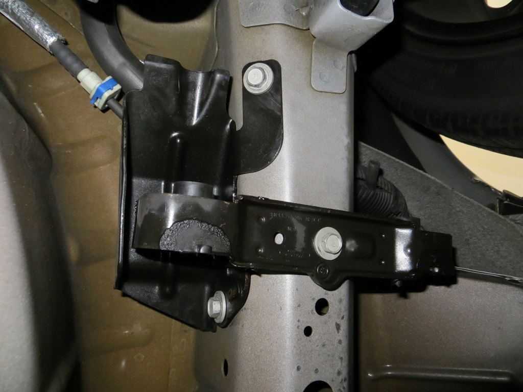

To re-mount the hanger bracket, I just held up the muffler with one hand while I threaded the upper bolt(s) with the other. After that, I used both hands to thread the lower bolt, which has maybe only 1" of clearance above the muffler. I had to use a 13mm wrench to tighten the bolt, since it is in such a tight spot, but it eventually got the job done.

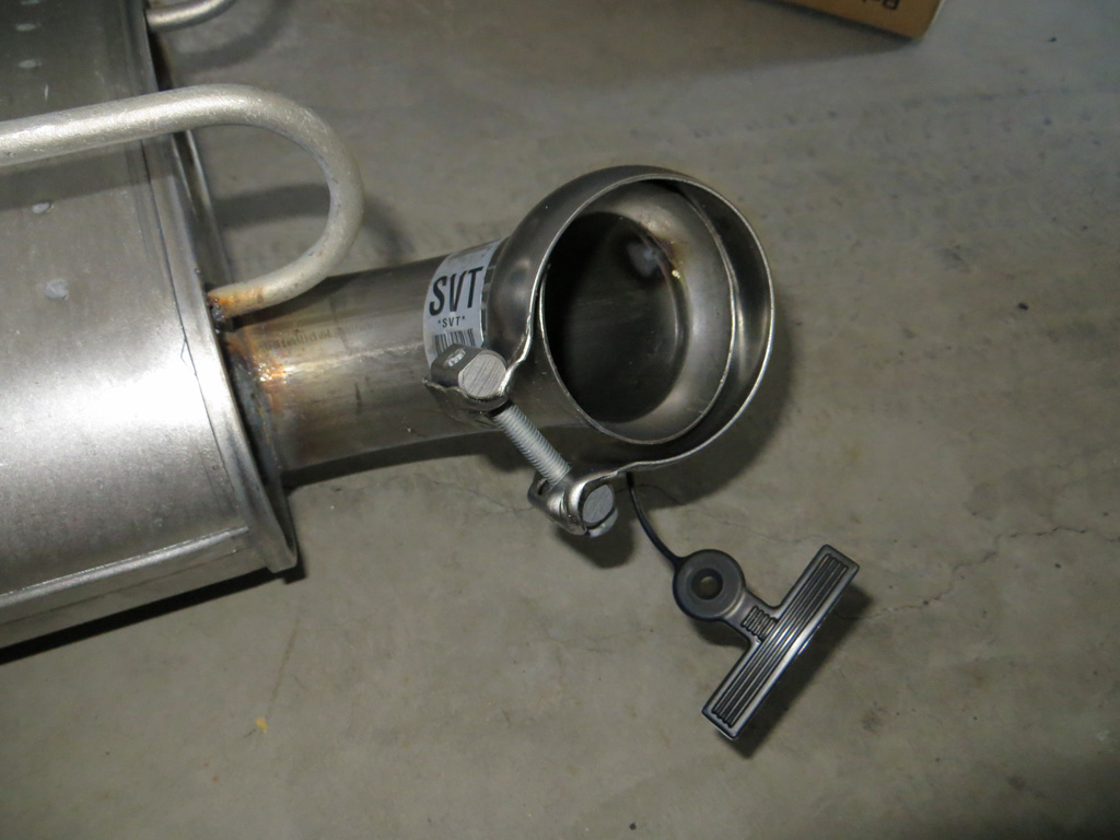

I'm not sure what this rubber connector is for, other than to ensure the exhaust is adequately connected. I took it off after the installation, since I think it will melt if I leave it there (?).

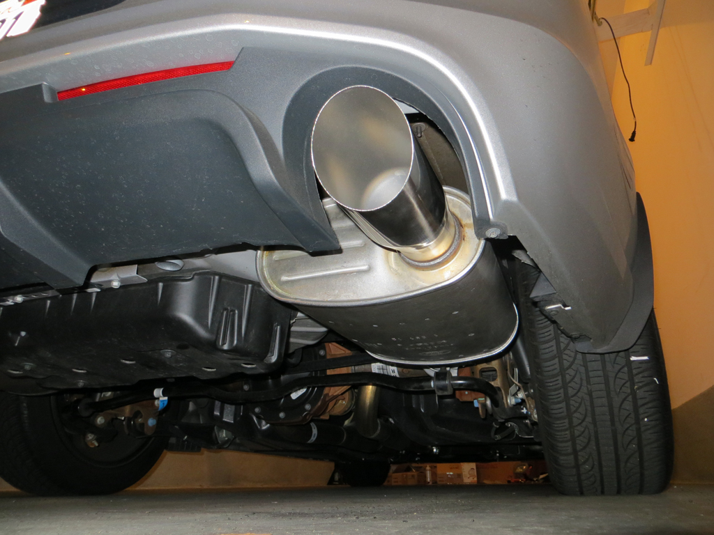

And, finally, pictures of the GT500 axle backs installed:
