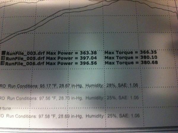

I just got my car tuned with the SCT programmer and a C&L intake. I gained about 30 HP!

Very nice, in those high temps too!

Was this Doug's tune?
Can you post a pic of the whole dyno sheet...I'm interested in seeing it

All thanks to the C&L intake

there saying its mostly the tune...... not the intake.... most of us around here know you barely get anything of a cold air intake on these new models

I didn't really mean it was all from the intake but I guess I should have been more clear -__-

Too funny, the air temp read on the dynosheet is at the dyno electronics not the car....

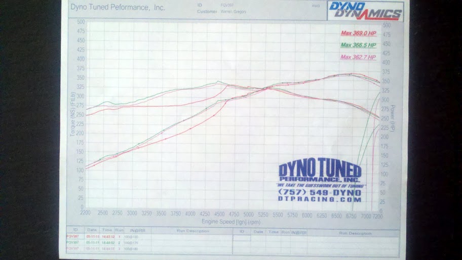

409 on a canned tune....that same tune gave me this. Installed a CAI and a custom dyno tune and netted 395/381.

Yikes. Was the canned tune not leaving as much of a margin of safety perhaps?

The SCT 91 octane strategy tune seems conservative. On my car it made 409 rwhp / 382 rwtq with 30 degrees of total timing and a very rich 11.8:1 air/fuel ratio. I think it could be leaned out a little for some extra power, but I'd rather keep it on the safe side where it is.
