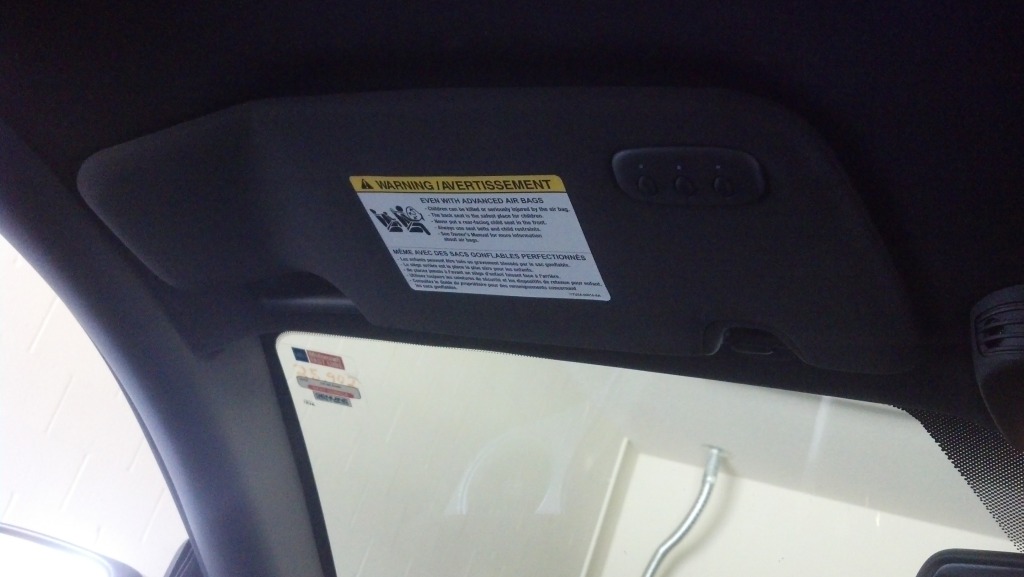

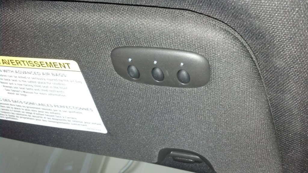

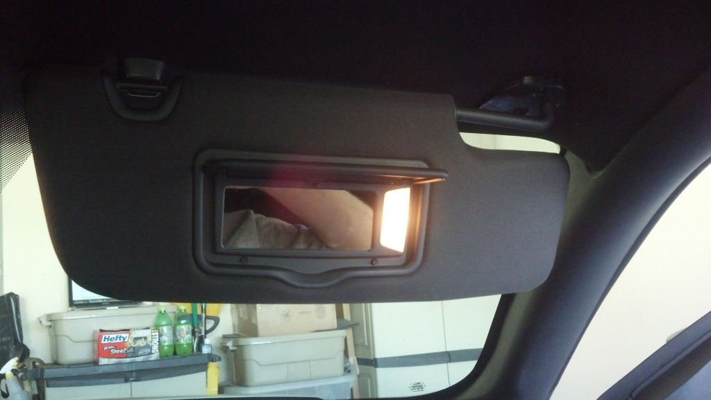

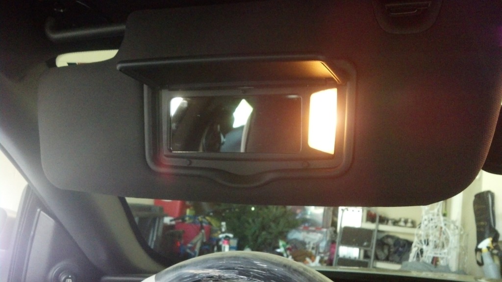

Lighted visors and rriver side w/homelink:

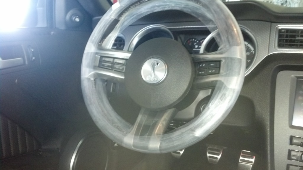

New steering wheel installed!!

Which steering wheel is that?
Old Jan 30, 2013 | 04:53 PM
  #58
R3troGT's Avatar
Joined: October 18, 2006
Posts: 372
It's a Shelby Steering Wheel.
Old Jan 30, 2013 | 05:07 PM
  #59
MyStang2010GB's Avatar
Posts: 2,586
From: Lithia, FL
^^^ This ^^^ My original wheel was wearing on the black suede material from the original owner. It was bothering me. I am very picky so I had to replace it.
