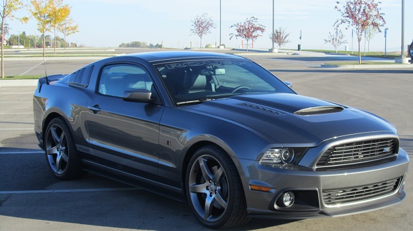

Any one having trouble with a lot of headlight flashes from on coming cars?
My son was driving in front of me and said when he looked in the mirror it was like looking into the sun, extremely bright. I then got caught at a light and he was able to get a few blocks ahead, but said he knew exactly where I was cause of the glow of the headlights.
I am wondering if Roush forgot to adjust the headlights when doing the suspension mod for my Stage 2 or is that something they just don't do?
I have an appointment with the dealer next week to get them checked. Will let you know.
Here's my beast...
