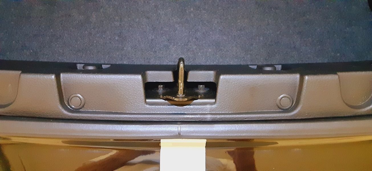

I found these I might try -

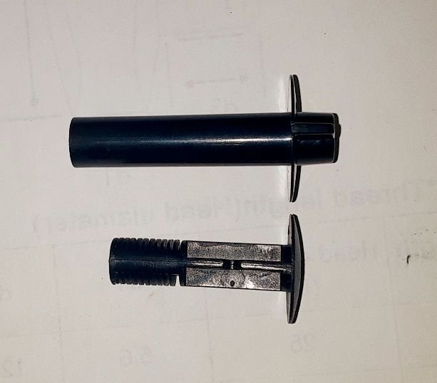

Not so much a good find as they are too long. Stock ones (that came out) and the Amazon units.

So I'm either going with the arrow insert in the trimmed new units they sell. Or the M6-1.0 female standoff and a knurled ****. Gonna start off with the **** and see how that goes.

I bought some new OEM units for the two behind the taillights, when they get here I will go to the archery shop and get the M6x1.0 inserts and try those. I also purchased the *****, internal threaded stand-offs etc. as well as the new top and rear retainers and see which I like best.

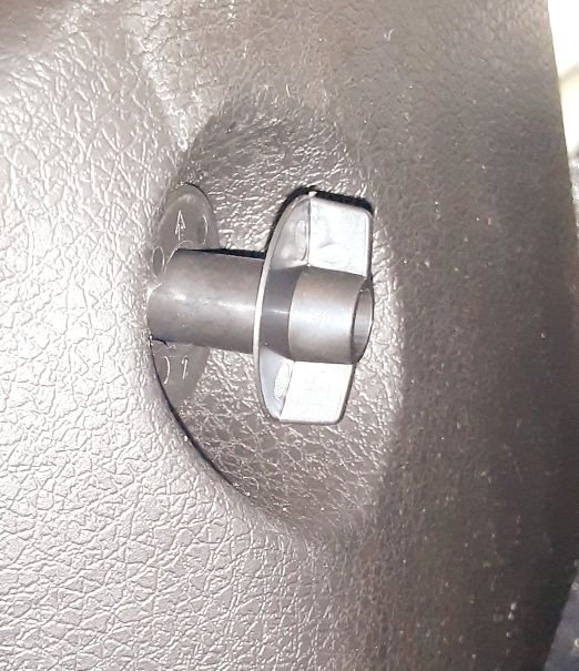

Okay so last night I did this install and it works real well. I used a jam nut behind the threaded stand-off though.
