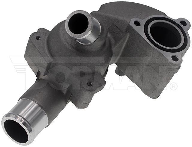

Dorman Aluminum Thermostat Housing
Normally I wouldn't buy Dorman; however; this pic looks great so I have one coming to replace my leaky plastic one. Seems the plastic ones don't work so well on the S197 V6. Only weird thing is, it says it has a 120deg thermostat installed. Not sure if that is a typo. Anyone else have experience with this one? https://www.dormanproducts.com/p-131857-902-1997.aspx

Every place I look says the same 120 Degrees ... perhaps an E-mail inquirey to Dorman is in order? Likely a misprint on them and every vendor repeated it?

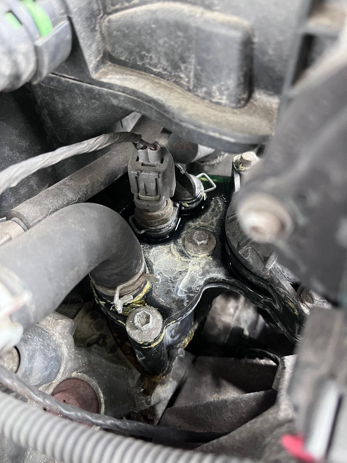

I am new here and I’m glad to have found this thread. I noticed some leaking residue on top of my housing and I figured it must need a replacement. What is the difference between the cheaper one from Tom and the more expensive one from Simmons?
Coolant residue
