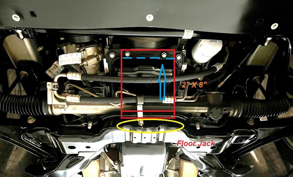

I see the front of the engine oil pan in my pic here, it wont dent the oil pan lip?

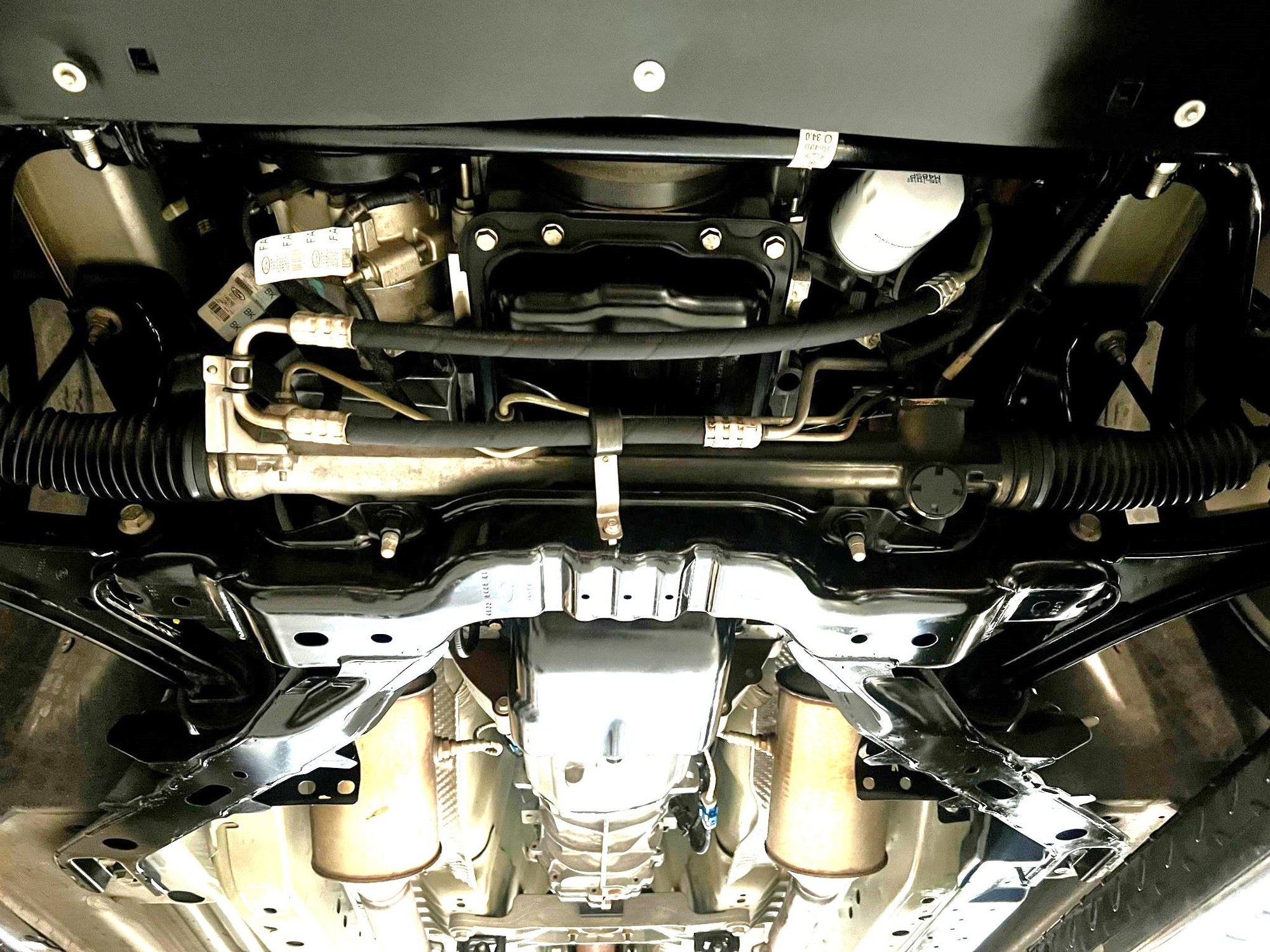

Okay like this? The front?
