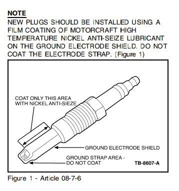

I got the XL-2 Motorcraft High temp Nickel Anti Seize and will be coating the plugs per the TSB. None on the threads huh?, okay.
Postscript: After torque I was all pleased with myself and then it hit me these are one piece design. Did I need to use anti seize on the barrels?

I have no idea what BTMO stands for... However, you do not install as is... You must gap the spark plugs first before installing on a forced induction application and always gap the spark plugs according to the supercharger's recommended specs...
Originally Posted by rocknrod
Okay done.
Never under any circumstances do you apply nickel anti-seize anywhere but on the barrels, this also includes one-piece design spark plugs... Appling nickel anti-seize on the threads will effect the accuracy of the torque value.

Yep I didnt put it on the threads?
And of course in any torque chart there is a dry and lubed torque value.
