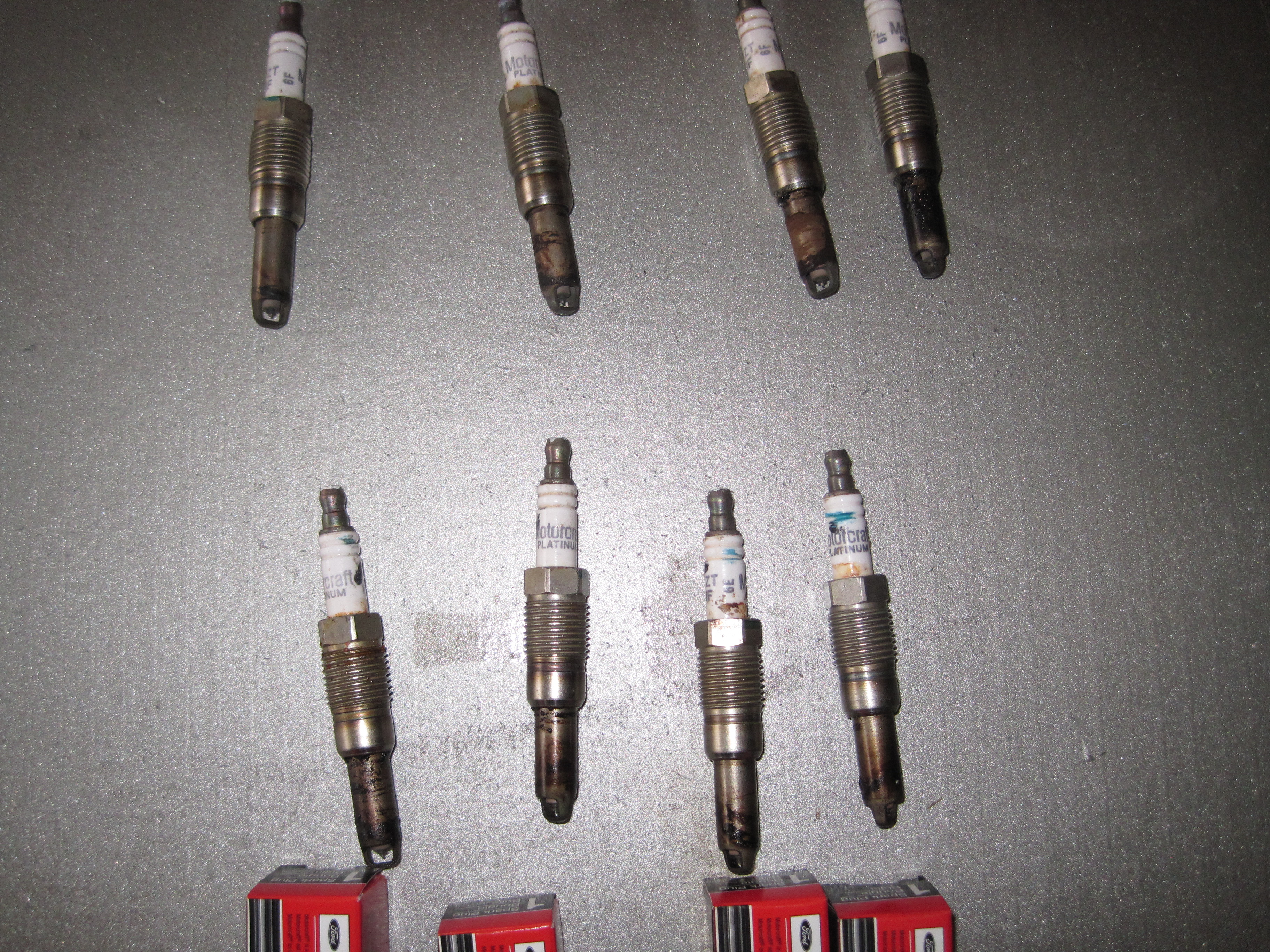

Replaced my plugs with Motorcraft. Car only had 27,000 miles, but they were eight years old, Cheap insurance to replace them when the carbon build-up was minimal. PB Blaster, and patience were my best friends... although it sounded like I was torturing the engine while they were coming out. Haven't hear that much creaking. groaning, and cracking since... well, I won't go into that here...
Here's a pic of the old ones... they weren't bad at all!
Attached Thumbnails S-197 Spark Plug for 4.6 Discussion N/A & Supercharged!-img_3286.jpg
