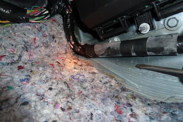

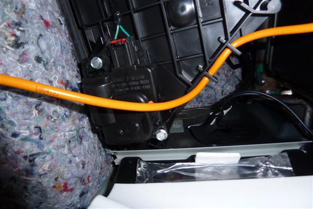

check this out
here are 2 pics.
One looking up. See the drops on the white tape, there was water coming in here. Also, next pic see dripping under junction box? This appeared to be coming from under the junction box.
KNOCK WOOD. This leak seems to have stopped after doing the grommets and the pinch weld seam with 3 M Seam Sealer.
How are you water testing this? Where are you putting the hose? Make sure you read the TSB. Check diagrams of possible water path.
Good luck.
