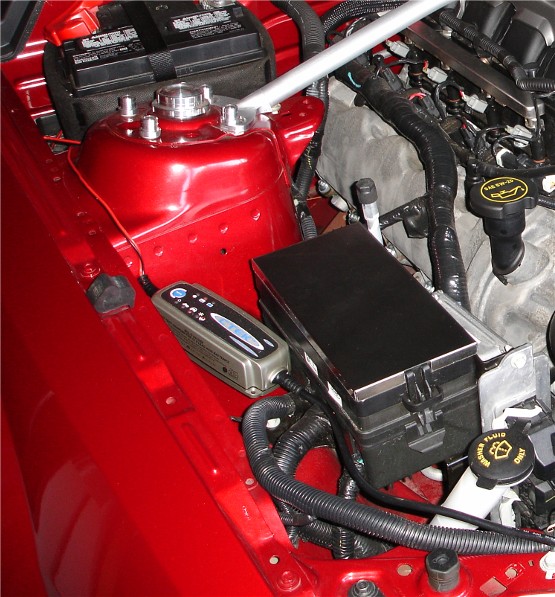

For the past two winters I've used a Ctek charger. I permanently attached the pigtail to the battery, which tucks out of the way behind the battery when not in use. The charger is small enough that it fits next to the fuse box. Then I simply drop the power cord down through the engine compartment to the floor and hook it up to an extention cord. The hood closes all the way, the car cover goes on and It's good till spring.

Charlie: there's no wiring harness involved. The pics I posted, are the factory terminal cables, in which the (-) terminal cable is connected directly from the battery, to the strut tower location. While the (+) terminal cable is connected directly from the battery, to the fuse box.
All you need to do is..Disconnect the negative terminal cable, at the strut tower location. Then attach your (-) ring terminal wire on top of the terminal cable lead, then re-attach both the ring terminal, and cable to the strut tower. Then disconnect your positive terminal cable at the fuse box, attach your (+) ring terminal wire, on top of the terminal cable lead, and then re-attach both the ring terminal, and cable to the fuse box..

Charlie: my NAPA maintainer includes only red and black terminal wires, along with the AC plug. As I mentioned before, the unit's ring terminal wires are attached directly to the factory terminal cables, mounted at the strut tower, and fuse box locations.
As for the unit itself. It stays mounted along side the strut tower, opposite the fuse box..There's already an exsisting hole, so there's no need for drilling an additional one.
Although, I usually don't drive my Stang in wet weather conditions. I'll either wrap the entire unit in plastic, or I'll just un-install it altogether.
Being as the unit's ring terminal wires, are attached directly to the factory cable terminals. There's really no need to worry about water causing them to short out.
Besides.. as long as the unit itself is un-plugged while the vehicle is running.. Water cannot short out the leads anyhow.
Just make sure you dry the leads off, before plugging the unit in, and you'll be just fine.
I'd post some better pics, but my camera battery just died. So I'll have to post some older ones instead.
If your able to zoom the image size..You'll notice exactly where I have the unit mounted.
Anyway, hope this helps out Charlie..
