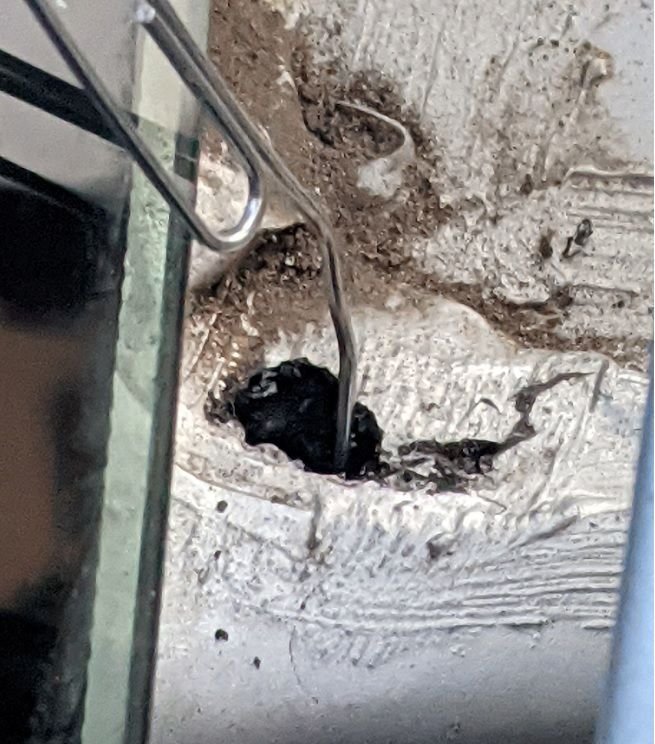

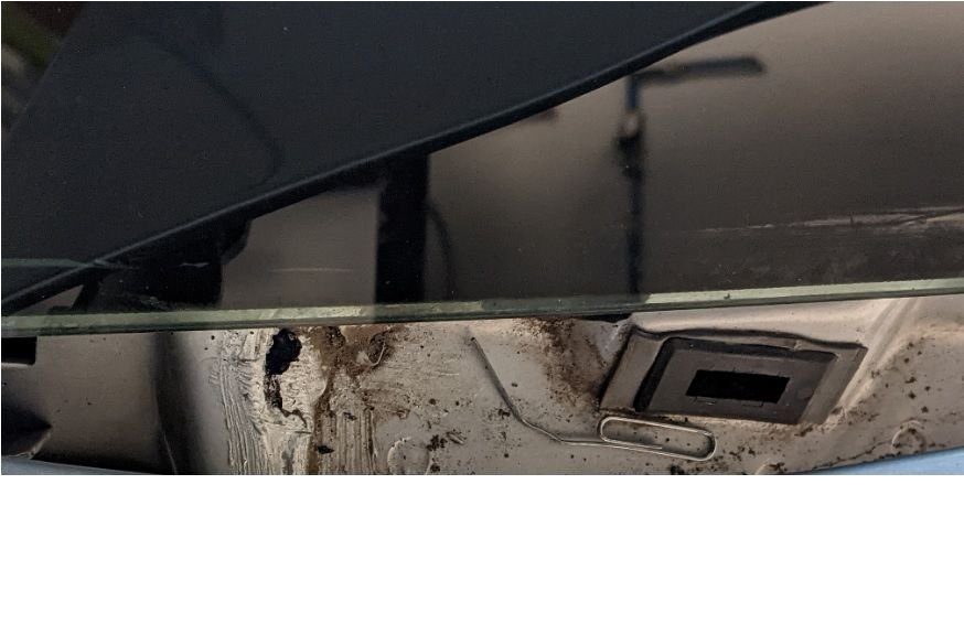

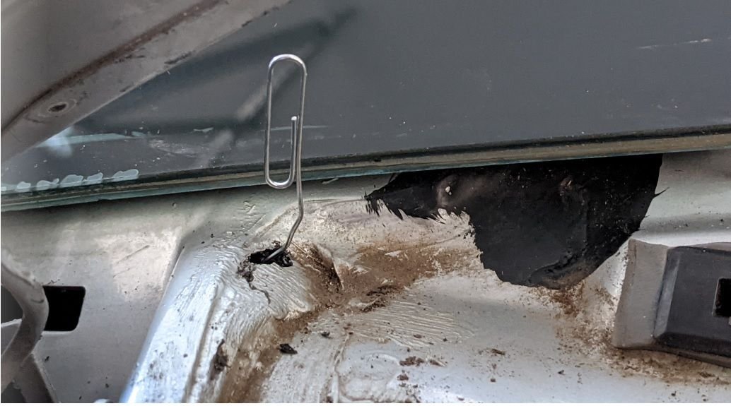

I too have had this same issue on my 2005 Mustang. Water started rushing in when I turned a corner after a rain storm. I cleared out the drain plugs
in the cabin filer compartment and the leak stopped for a year or so. Recently the leaking has started up again but its not the same issue as before.
I took the cowl off and noticed this small hole near the drain hole in the cowl. I stuck a paperclip in it to see how far it would go in. I am pretty sure this
is the cause of my latest leak (see pic). The water comes in on the right side of the glove compartment and drains down into the circuit board in front
of the passenger side door. What is the best way to repair this hole? Some kind of silicon sealant? I currently have my carpetting removed
until I am 100% sure the car is waterproof again lol.
FYI I know there is a one of those rectangle grommets missing in the pic, it fell off while I was removing the cowl. It was in place when I took it off tho
so I don't think that s the issue
Thanks for any advice
Mike
Old Jan 14, 2021 | 01:24 PM
SpectreH's Avatar
Joined: February 5, 2015
Posts: 4,247
Likes: 1,155
From: Yukon, OK
Is that just some body sealer that got old and cracked? If so, I'd apply more in that area. Hoping it is not rusted out instead.
Old Jan 14, 2021 | 01:34 PM
m05fastbackGT's Avatar
Joined: May 11, 2006
Posts: 10,661
Likes: 2,528
From: Carnegie, PA
Also hope that hole isn't rusted out? But no doubt, it definitely requires some body sealer for sure.
Old Jan 14, 2021 | 01:58 PM
jetter's Avatar
Joined: January 14, 2021
Posts: 12
it looks like a weld to me. There is no rust anywhere else on the car so I dont think its rust. I have had so many water leaks lately I wouldnt be
surprised if its rust tho I guess lol.
