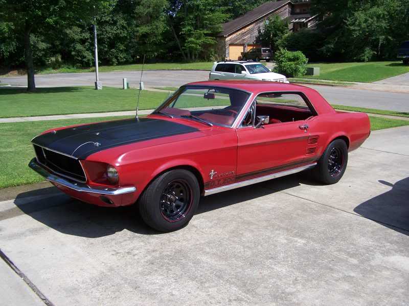

Messed around in my garage when I got home from work. Took the hood off my '68 Cougar getting ready to tear down the top end. Here's a pic of the right bank rocker studs, look back to the 5th and 7th stud and you'll see they are 'taller' than the others. Same situation on the left bank. Pulling the heads and having screw in studs installed. kennyg

Cougar Project Update: Picked me up some wheels and tires
if they look familiar they should. Thanks Jake for a good deal and nice to meet you. I'm debating, with myself, about whether to buy chrome or black lug nuts. Opinions? Also, I've decided to install the screw in studs myself. I picked up a good sized drill press, talked to a machinist friend and he suggested using the press to center the tap, that was my biggest concern with doing it by hand and getting the studs crooked. I'll start a build thread soon. To be continued...kennyg

Good to meet you too. The color lug nut is a hard decision. I think either set would look good. I only went with chrome because they were priced right when I ordered the cragars.

paint the nuts the same color as the car

Bought the black lugs and they look good, a real quality product that I found on theebay for $21.25 for the set of 20. I'm painting the drums, hubs, and new grease caps black. kennyg
