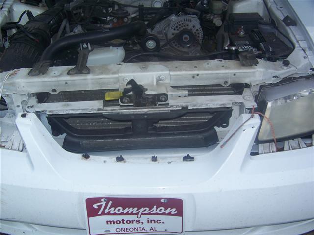

I had taken the fender and hood off earlier in the week so the engine is exposed. When I went out this morning and the EZ Up Canopy had collapsed on top of the car. It was staked on two corners and had a landscape paver on a third corner. Amazingly as mangled and twisted as the EZ Up was the metal was not touching the body anywhere. I think the damage to the canopy was a combination of the wind and the water on top. The center post was resting on the plenum and the nylon canopy had fallen between the mangled frame and was on top of the engine compartment full of water. Three of us carefully moved it off of the car and separated the canopy from the frame. The frame was beyond repair and is now in the trash pile. The white canopy was dirty and greasy so it is now covering the engine.
KennyG called this morning and hopefully will be painting parts today. If all goes as planned control arms will be finished this evening. Anyone know where to get poly urethane spring insulators locally?

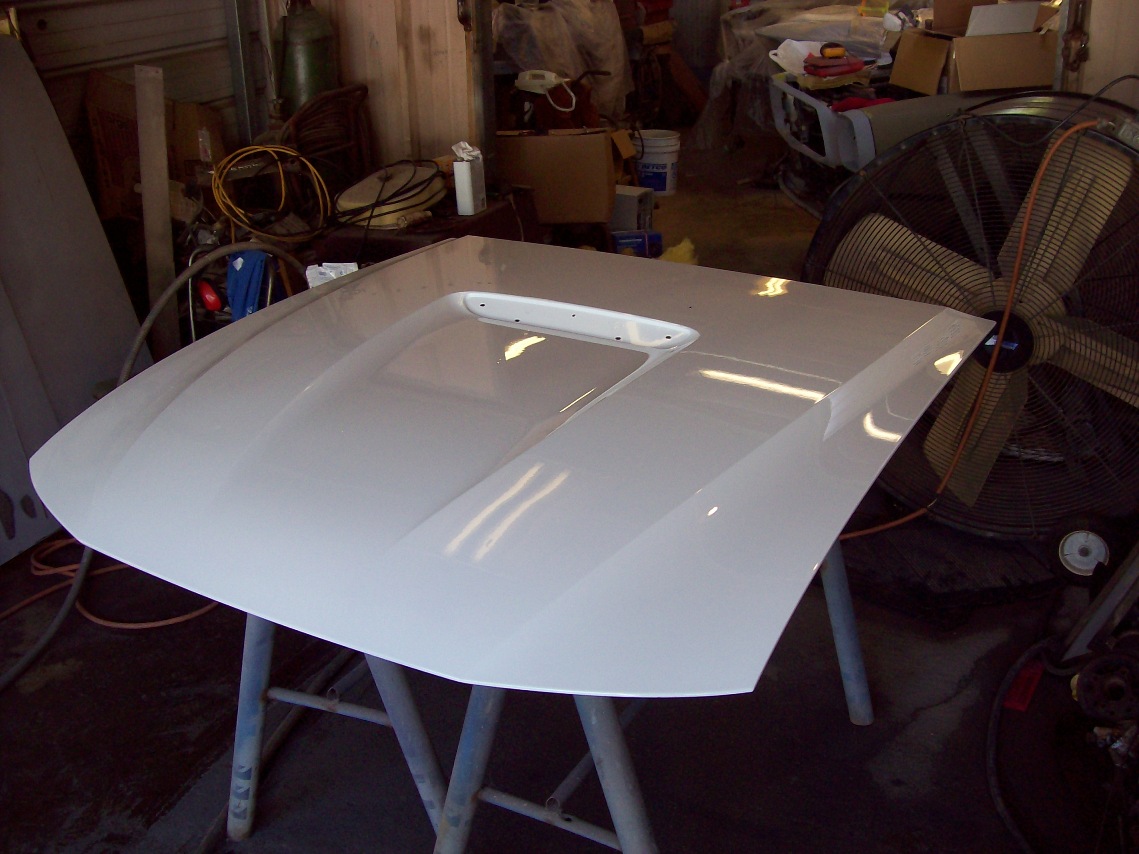

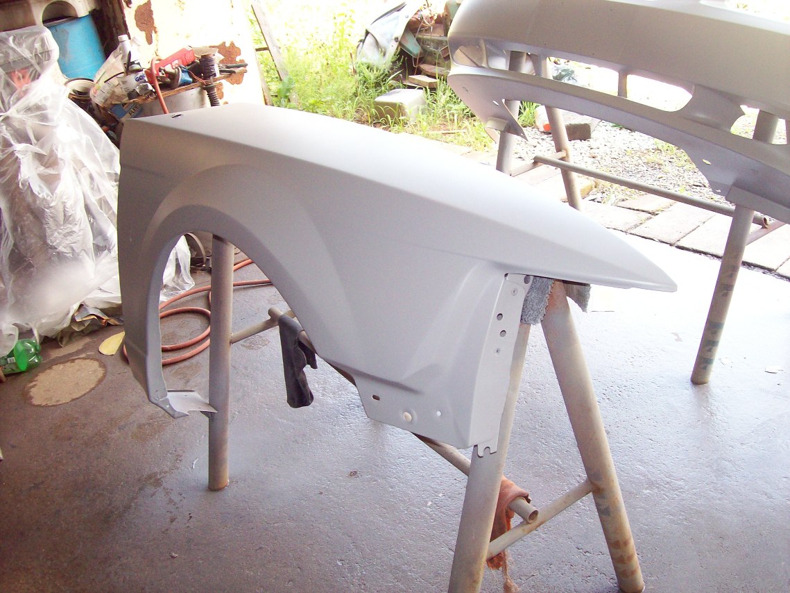

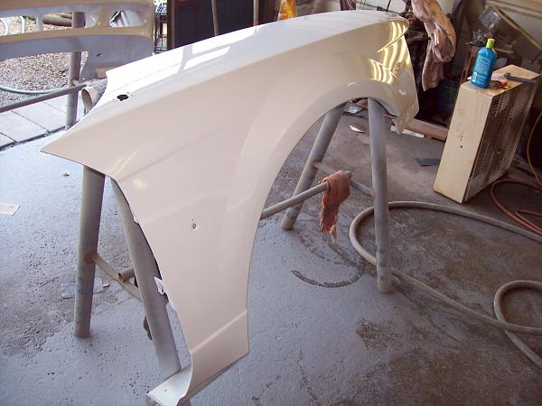

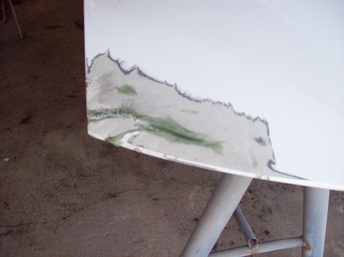

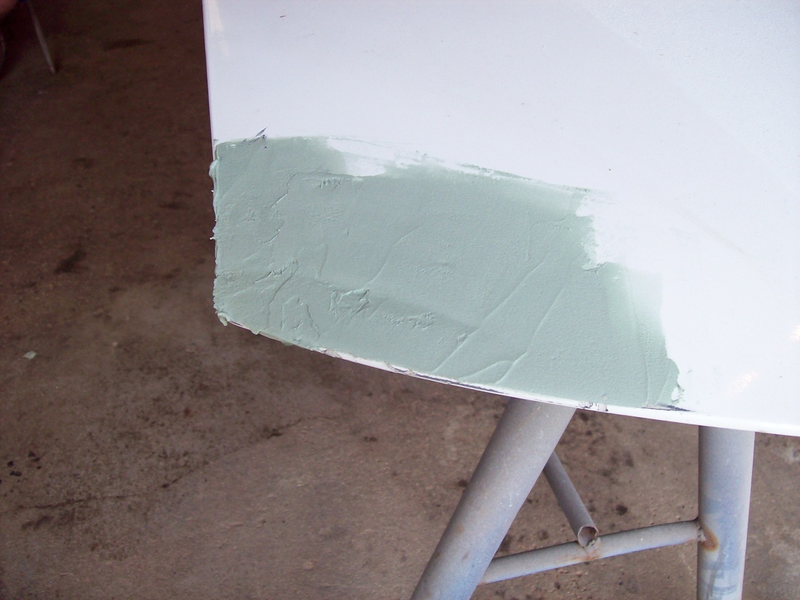

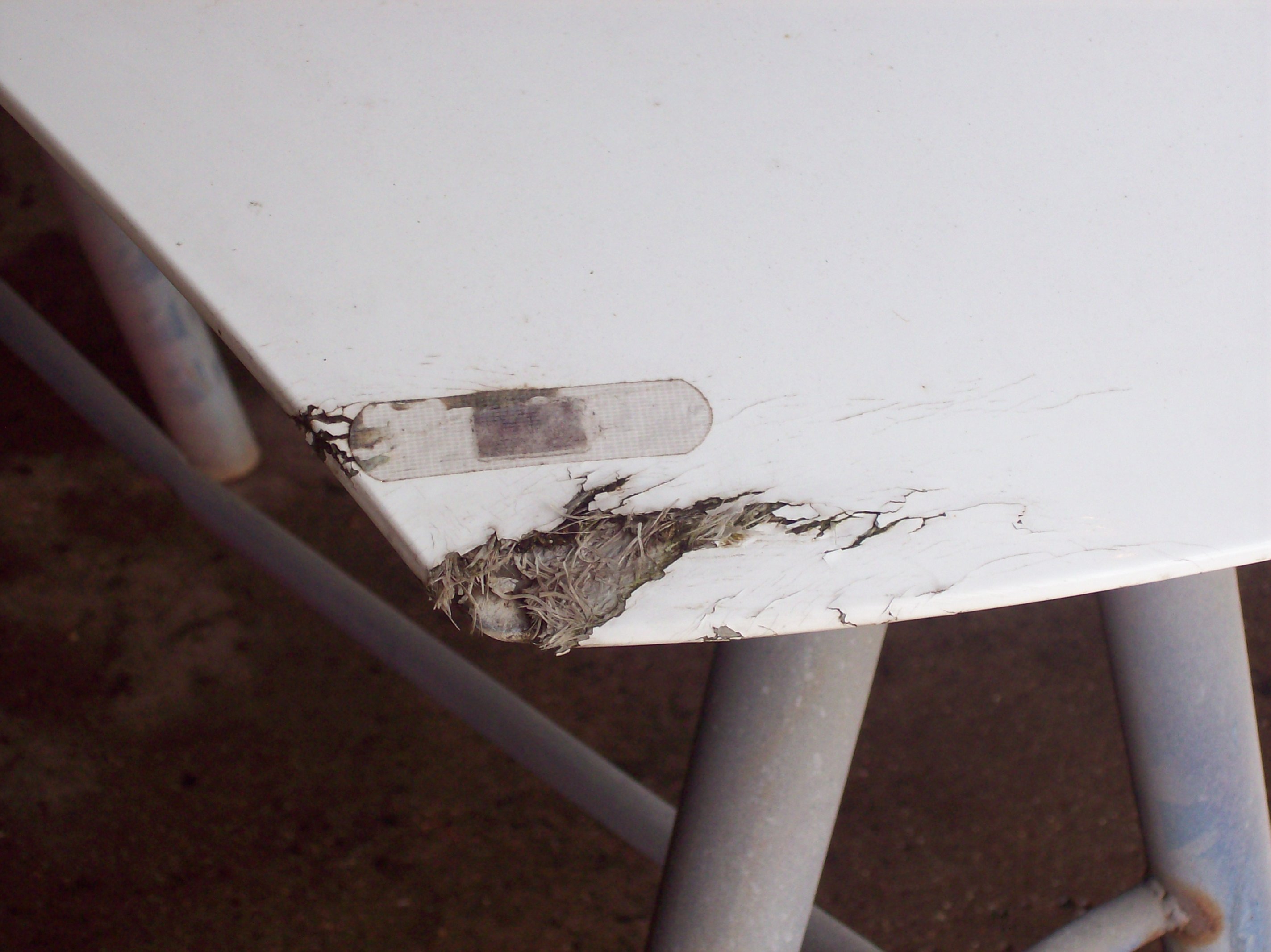

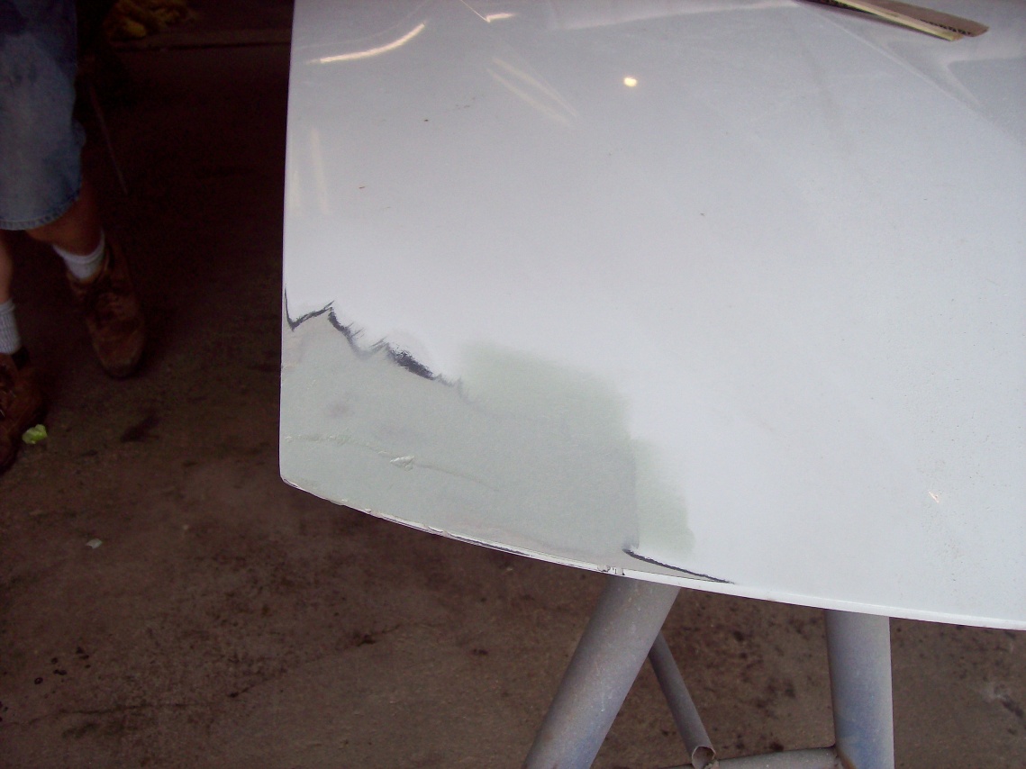

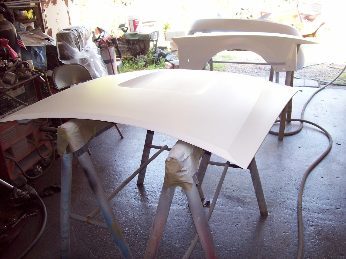

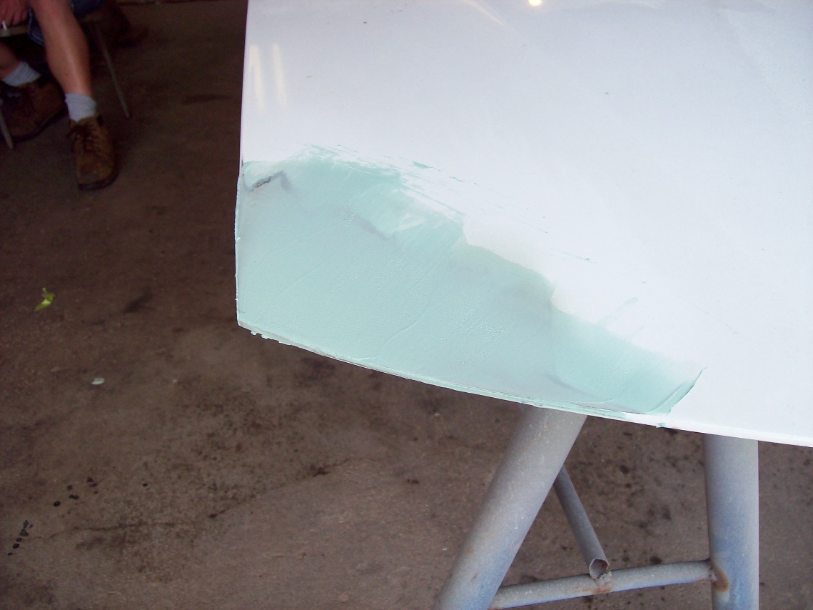

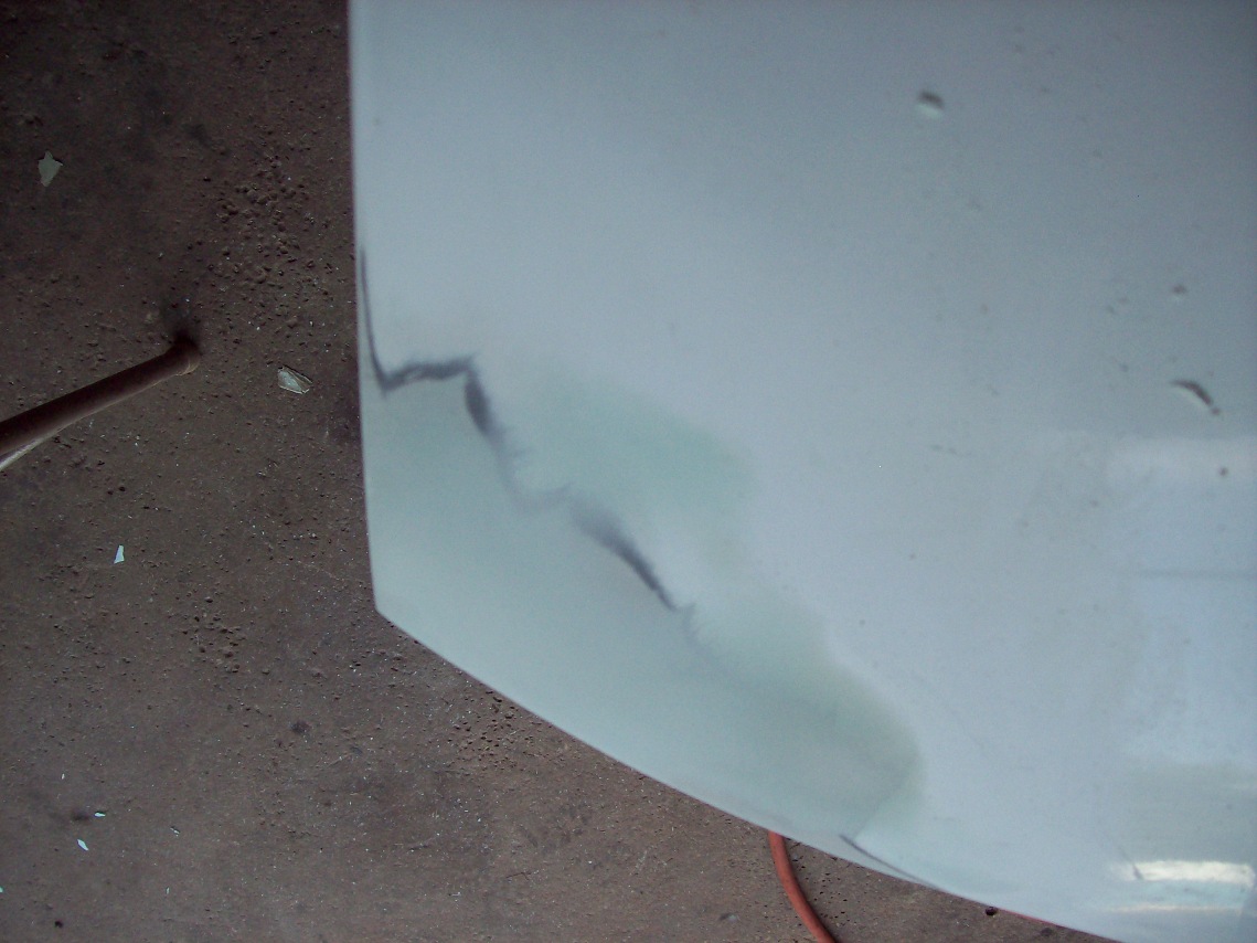

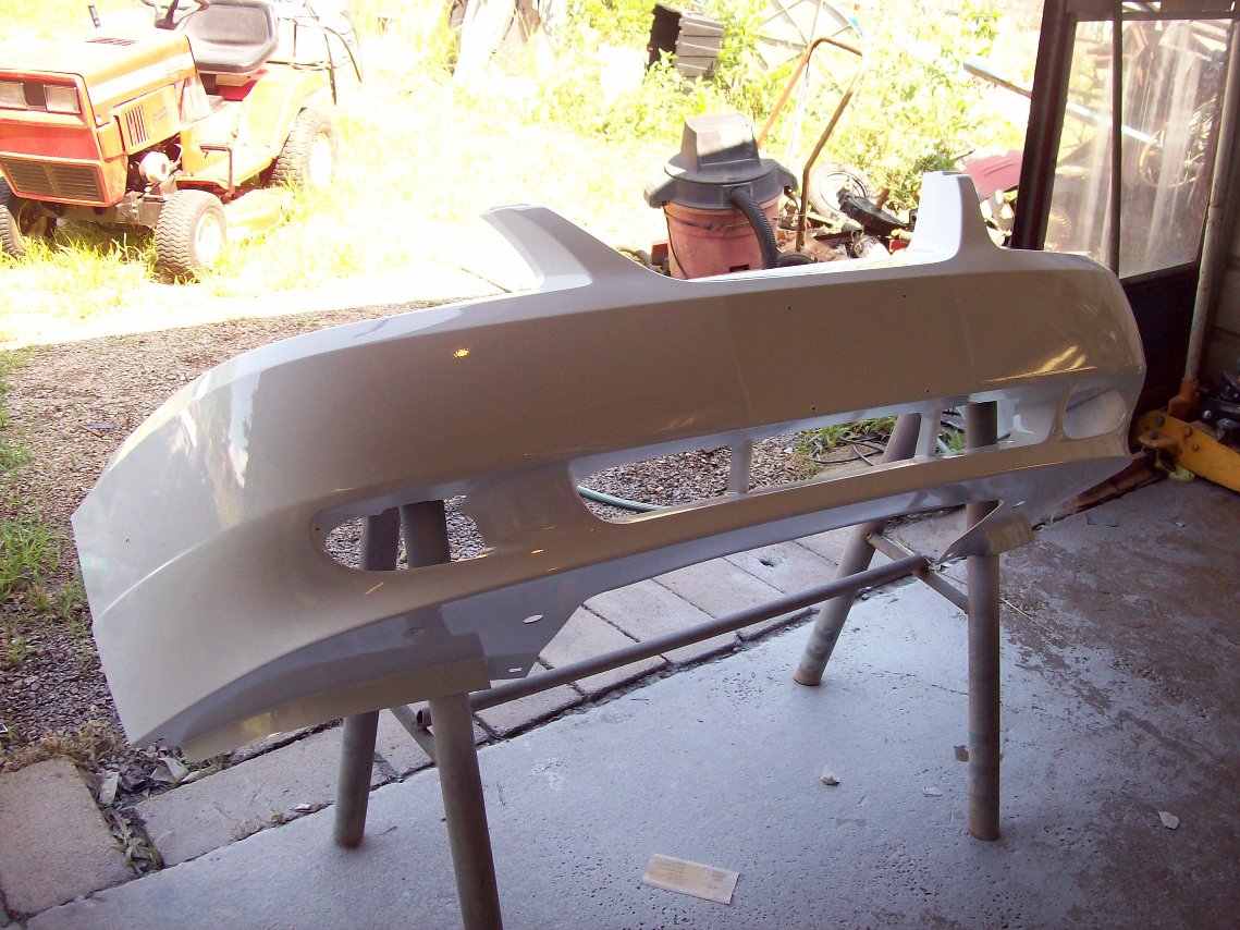

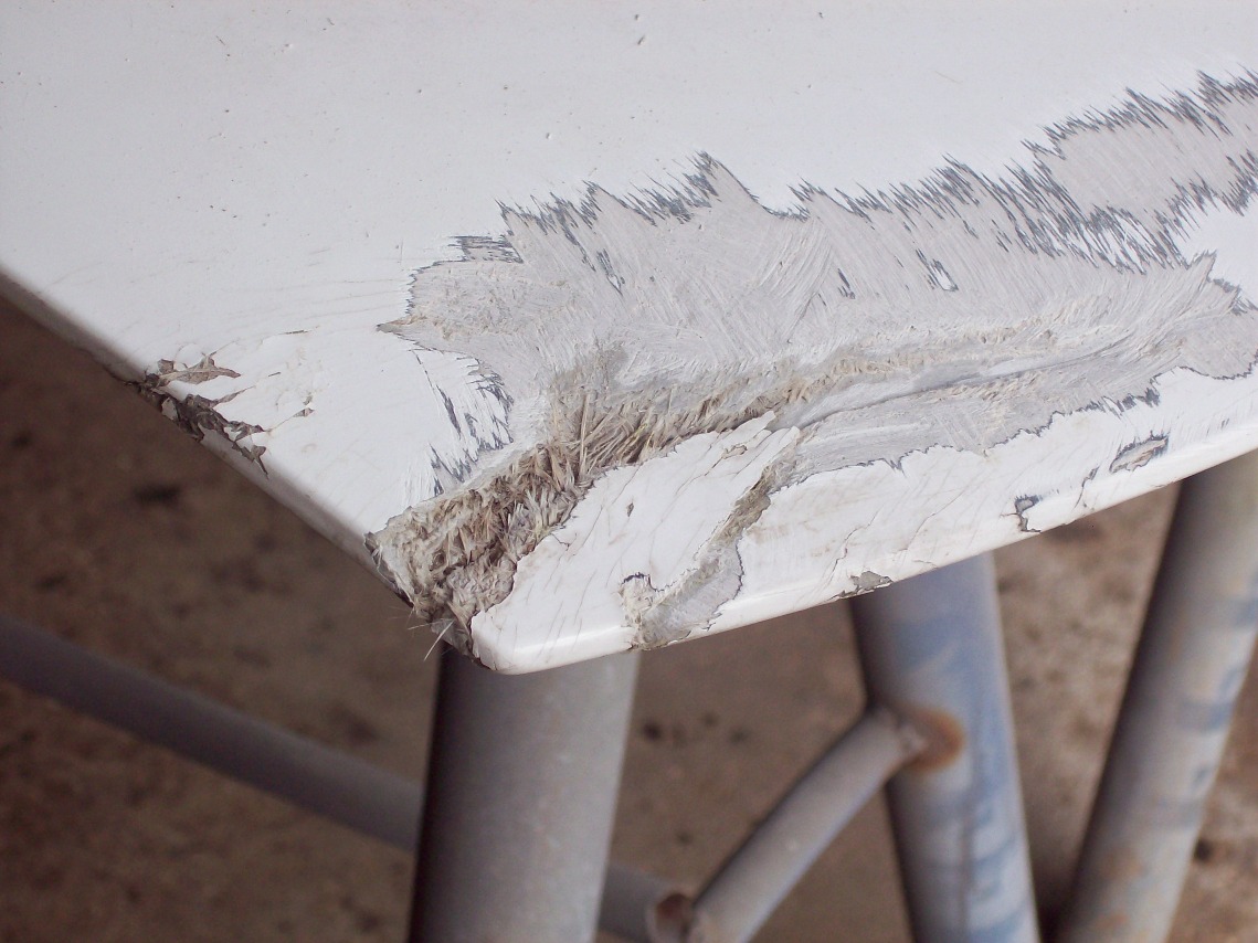

Almost ready to prime the repairs and paint. Monday, monday, monday. Doing hardwood floors this weekend otherwise I would do it tomorrow. Here's a couple of pics, mostly of repairing the hood. The corner was damaged and broken off, but fortunately garagewear got the broken piece with the Stang. Prepped the damaged area and reattached the corner of the skin with fiberglass resin. Ground out a bunch of cracks, then built the area up with polyester filler, sanded between coats, applied a higher grade filler, then finished sanded. The fender has several issues and are almost smoothed to my liking. The bumper will be a cinch. To be continued...kennyg
Attached Thumbnails Bought another 2000-2000hood1.jpg   Bought another 2000-2000hood2.jpg   Bought another 2000-2000hood3.jpg   Bought another 2000-2000hood4.jpg   Bought another 2000-2000hood5.jpg
Bought another 2000-2000hood6.jpg   Bought another 2000-2000hood7.jpg   Bought another 2000-2000hood8.jpg   Bought another 2000-2000fender1.jpg   Bought another 2000-2000bumper1.jpg

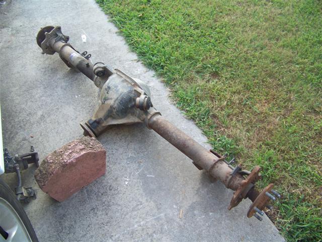

Started working on the control arms yesterday and when I got it up in the air I thought I would check the axles. Left axle is bent. Has about an inch of wobble to it. Can't tell by looking if the housing is bent so I guess I will replace the whole rearend.

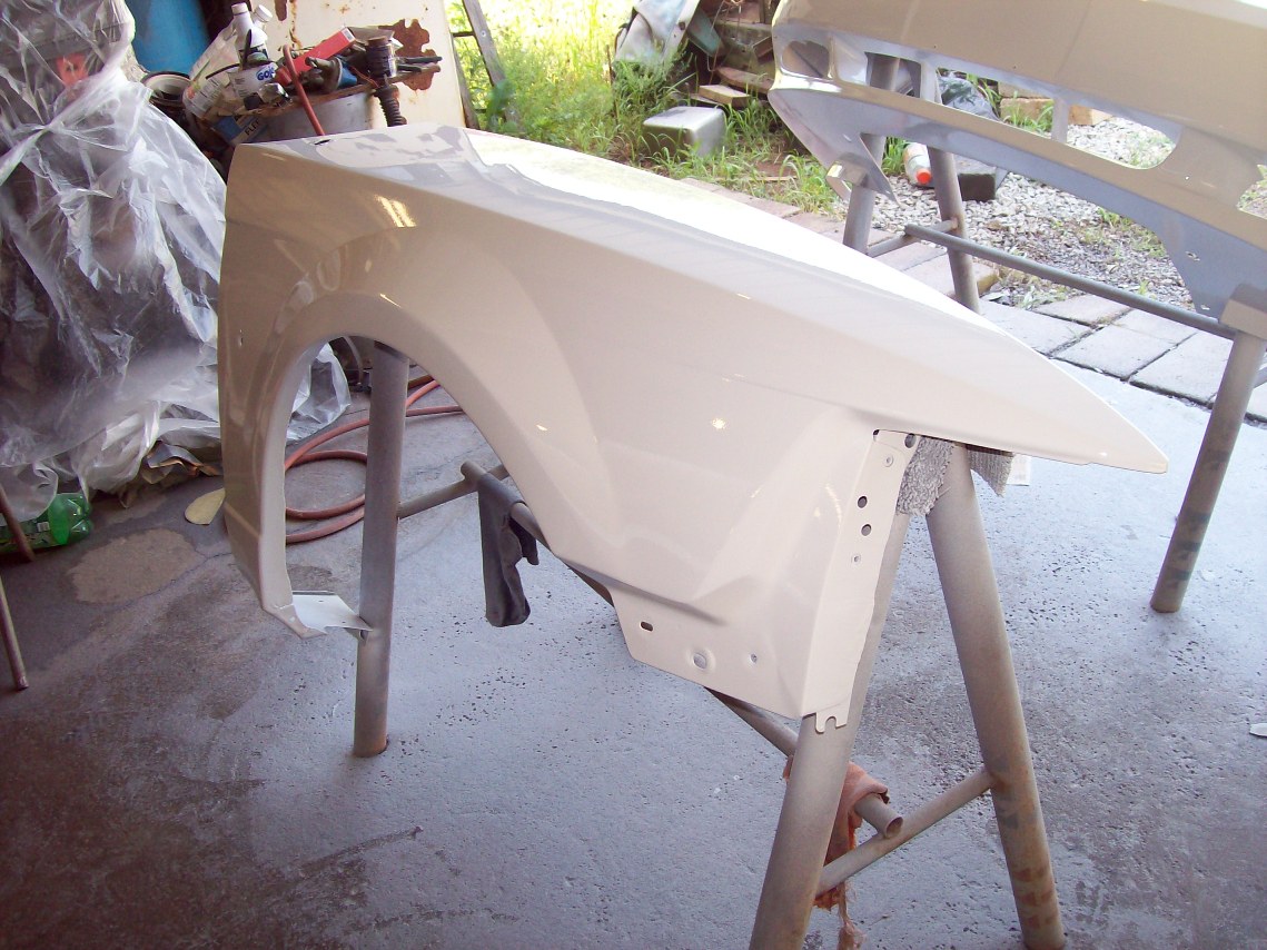

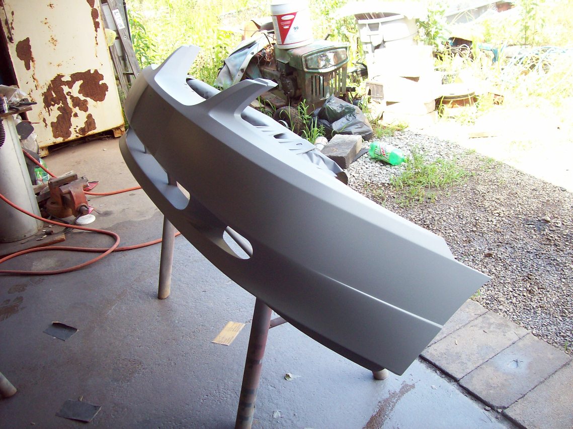

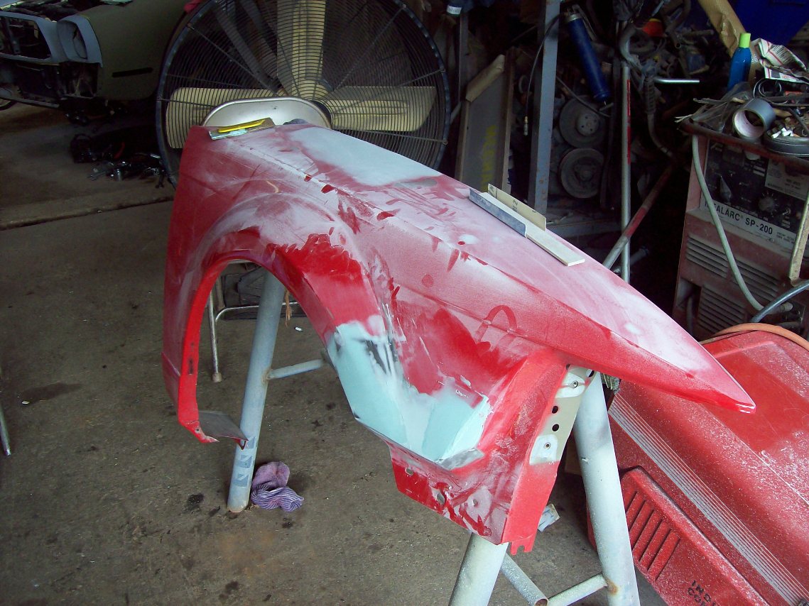

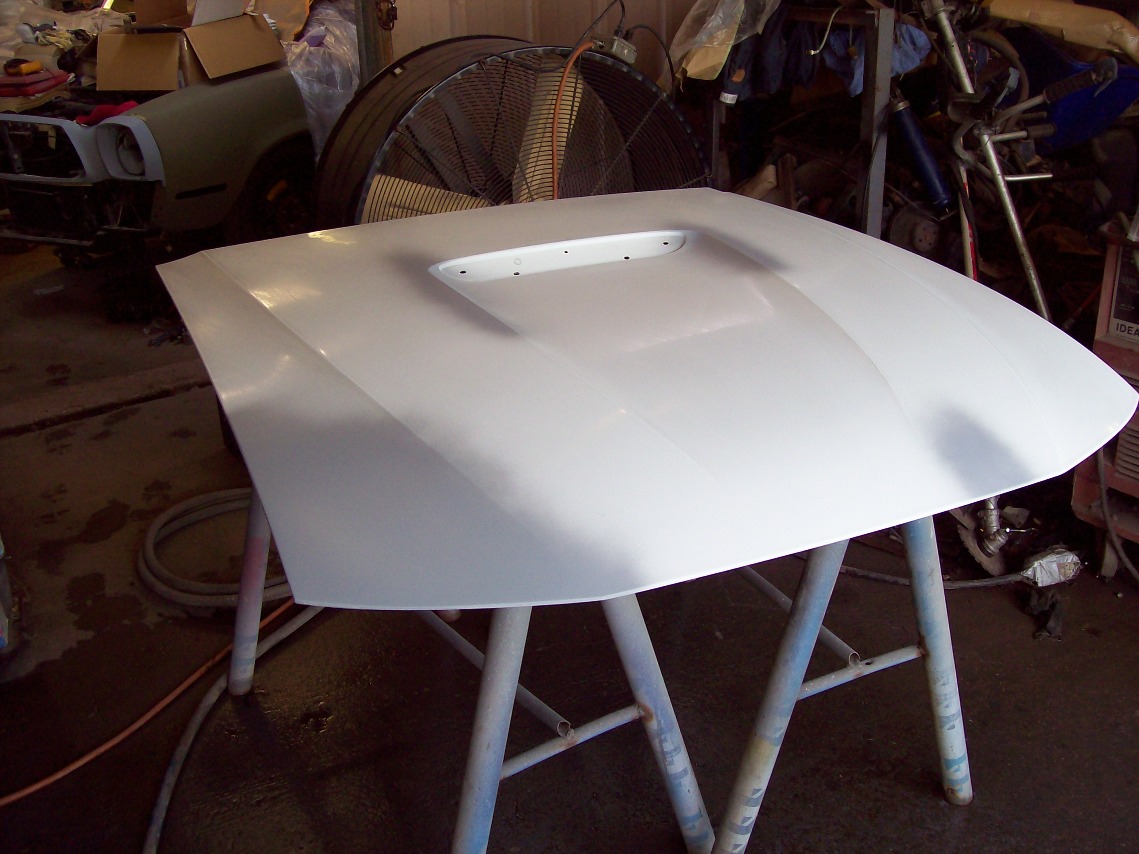

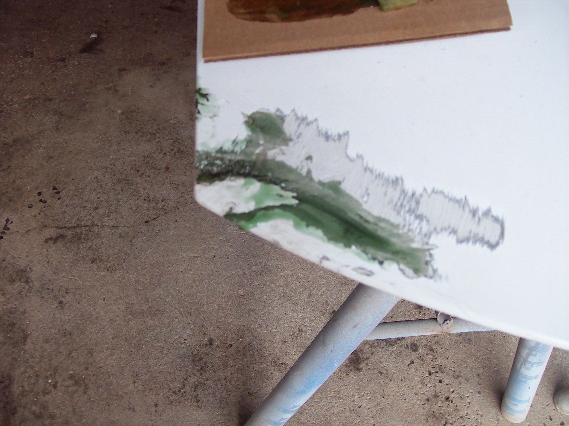

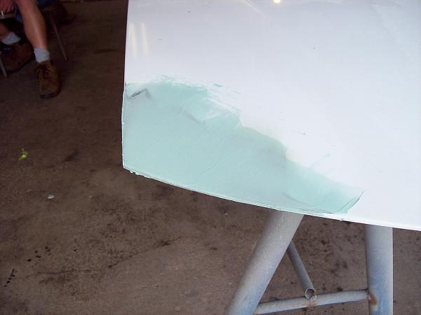

Rain makes corn, corn makes...HOLD ON. Rain helped cool things off a little and keep the dust down and I was able to paint yesterday. Here's a couple of pics. kennyg
Attached Thumbnails Bought another 2000-2000paint1.jpg   Bought another 2000-2000paint2.jpg   Bought another 2000-2000paint3.jpg   Bought another 2000-2000paint4.jpg   Bought another 2000-2000paint5.jpg
Bought another 2000-2000paint6.jpg   Bought another 2000-2000paint7.jpg   Bought another 2000-2000paint8.jpg

Fender and hood are back on car. Pulled the rearend last night in prep for the replacement one. When the car slammed the curb on the left side it ripped the upper control arms and bent the lowers. It also bent the left axle. I thought there would be damage to the brackets so I bought a torque box repair kit and tubular control arms. What I did find for damage underneath is the drive shaft and pinion slammed the bottom of the right floor board and put a pretty good size dent as well as crimped the fuel line. I am thinking I can get away with a splice using a compression fitting or just cut it and replace the back 3 feet of the line.

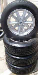

What size are the 06 wheels and how much, can you post pics ?
Old Jun 23, 2010 | 03:50 PM
garagewear's Avatar
Joined: February 24, 2007
Posts: 258
From: Harvest, AL
They are 16". Look just like the ones in the post at the top of this page. Includes Ford spinners. Asking $250. They have tires that probably have about 8 to 10K miles left on them. I think the tires are 225/65

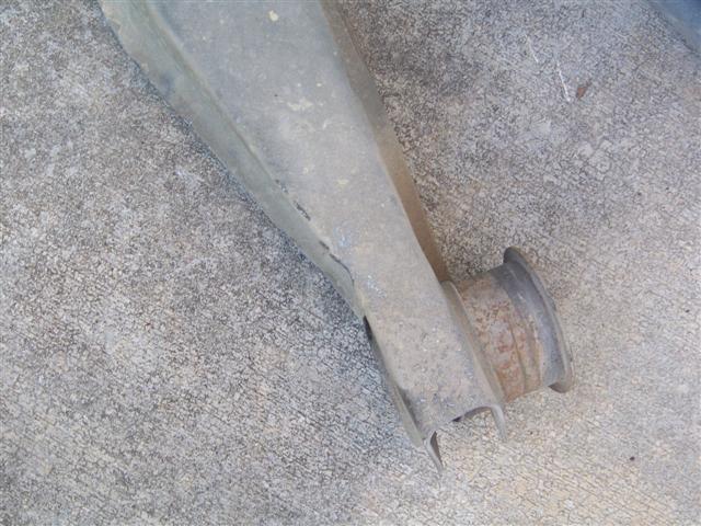

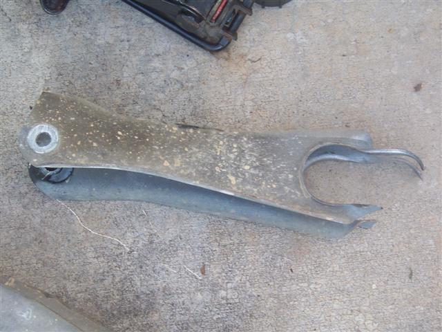

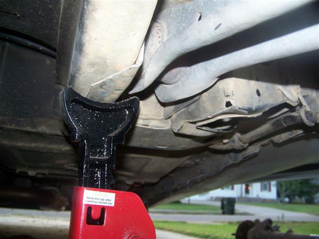

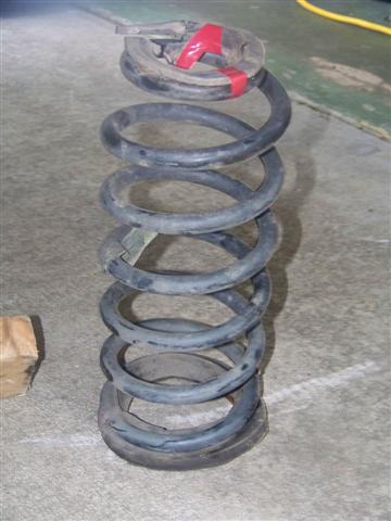

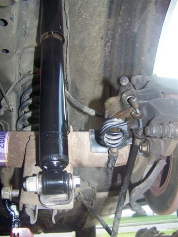

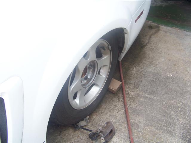

These shots show the rear of the car with no springs or lower control arms installed. We pulled it up onto the rollback with just the uppers not knowing the condition of things.
The left axle was bent, left upper control arm bent and the right control arm ripped apart.
The previous owner had started taking things apart. When I went to get it I put the bolts in the upper control arms to the rearend and put the wheels on it. The rear end was offset to the right about 4".
Attached Thumbnails Bought another 2000-no_springs.jpg   Bought another 2000-bent_upper_control_arm.jpg   Bought another 2000-ripped_upper_control_arm.jpg   Bought another 2000-old_rear.jpg

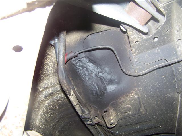

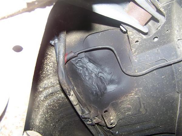

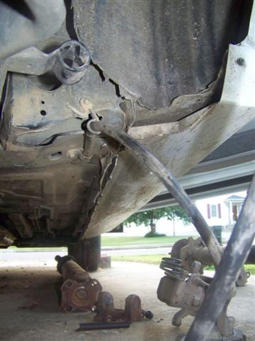

The left rear wheelhouse was bent all along the edge on the wheelhouse to body seam. Had to hammer it straight and undercoat it. It would have quickly sliced up a tire.
When the rearend shifted to the right the rear u-joint beat the living daylights out of the tunnel and floor. You see a clip in the tunnel. That was pushed up about 90 degrees. The rounded corner of the floor was ripped and pushed up into the car about 3". We took the rear seat out and I beat the bend down then I had my daughter hold the sledge hammer as a dolly then I worked it from the bottom side. The rip was about 3" long and you could almost get your hand through it. We got it shaped and closed the gap to about 1/4" by 1 1/2". Close enough for tape on the top and caulk and undercoat on the bottom.
You can see the bent vent line. The fuel line was crimped when the floor was beat up. I cut about 4" out of the line and thought I could flare it with a double flare tool. No luck. I put a piece of 5/16" rubber line on it. Will have to check it when I put the battery back in. It is good and tight but I don't want it to come off so may go back with a compression fitting.

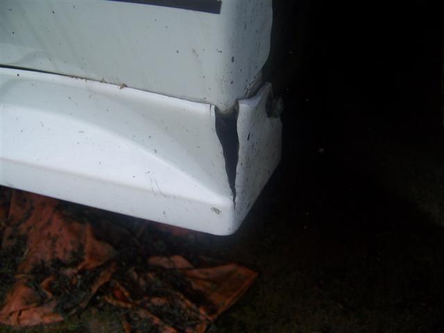

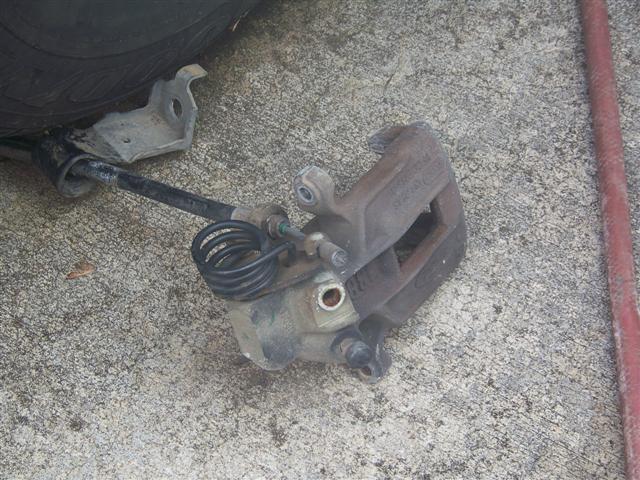

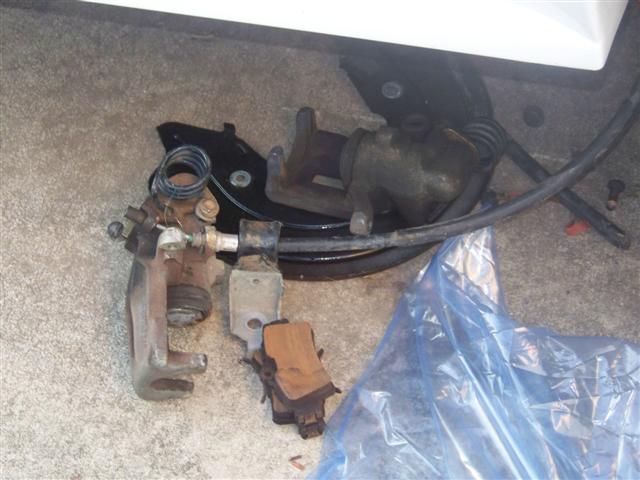

Other shots show the dangling caliper and some brake parts. The last pic shows the mangled pinch weld where the rocker cover is supposed to attach. Have to remove both rockers and straighten the pinch weld to even get the clips back on the rockers. It looks to me like it must have gone over a curb or something.
Attached Thumbnails Bought another 2000-fixed_floor.jpg   Bought another 2000-loose_caliper.jpg   Bought another 2000-brake_stuff.jpg

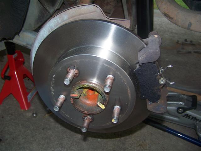

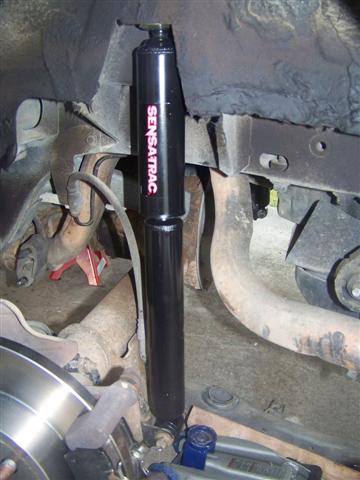

This shows the rear end in and the right side installed.
Attached Thumbnails Bought another 2000-lower_control_installed.jpg   Bought another 2000-new_rotor.jpg

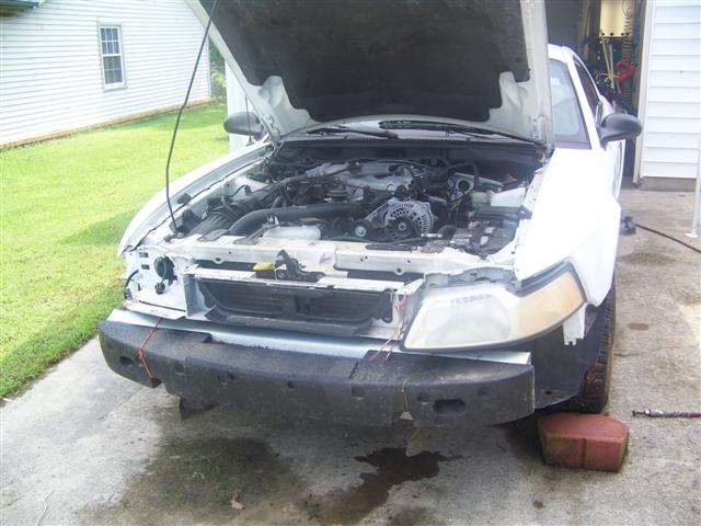

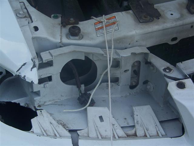

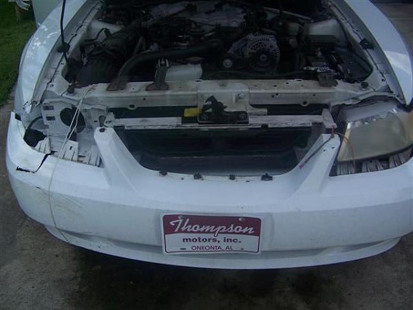

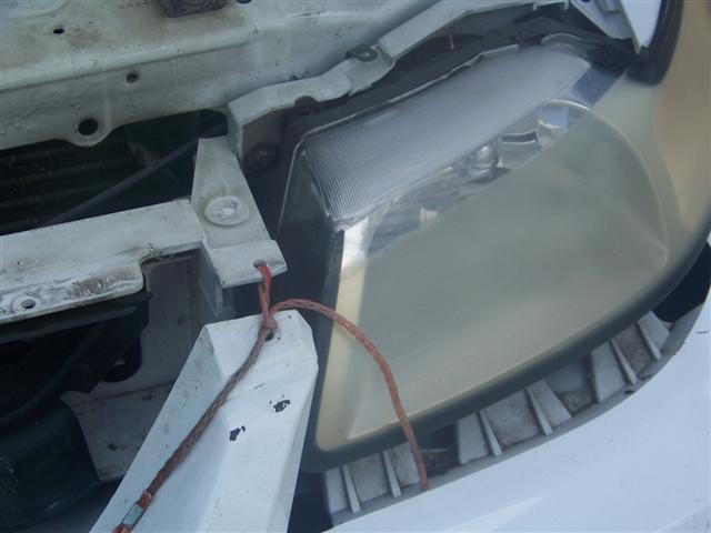

Old front. Notice the bumper was tied on.
Attached Thumbnails Bought another 2000-header.jpg   Bought another 2000-tie_left.jpg   Bought another 2000-tie_front.jpg   Bought another 2000-tie_front_2.jpg   Bought another 2000-no_bumper.jpg

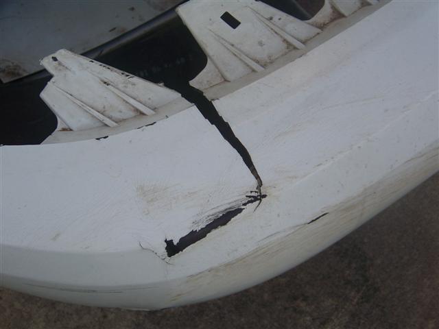

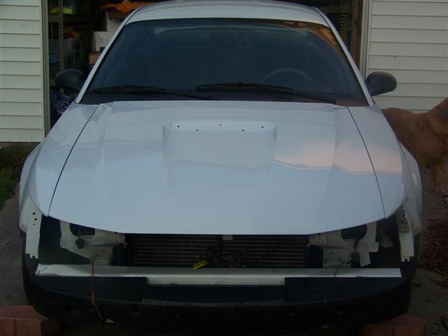

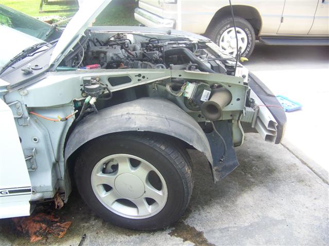

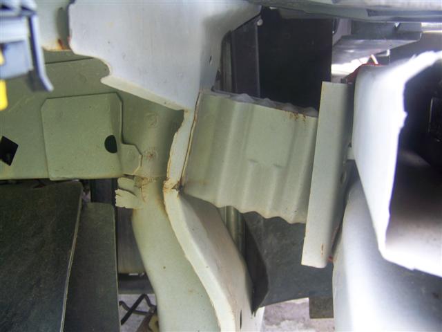

Front progress

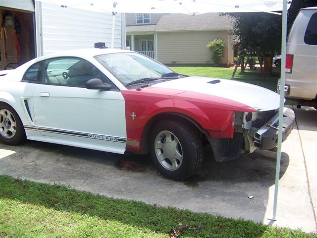

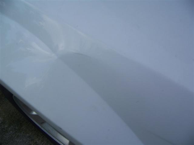

Attached Thumbnails Bought another 2000-fender_kink.jpg   Bought another 2000-fender_kink_lower.jpg   Bought another 2000-fender_removed.jpg   Bought another 2000-no_fender.jpg   Bought another 2000-ripped_bumper.jpg

Old Jul 1, 2010 | 09:12 PM
  #40
garagewear's Avatar
Posts: 258
From: Harvest, AL

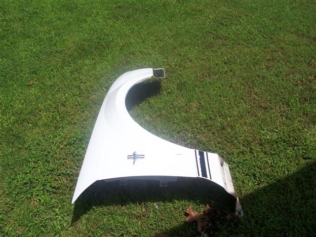

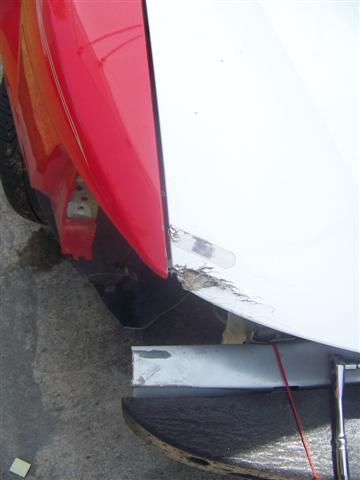

Test fit of the fender before it went to KennyG.
Reassembly of the front end.
Damage to the rail.
Attached Thumbnails Bought another 2000-red_fender.jpg   Bought another 2000-right_rail.jpg   Bought another 2000-h_f_installed.jpg
