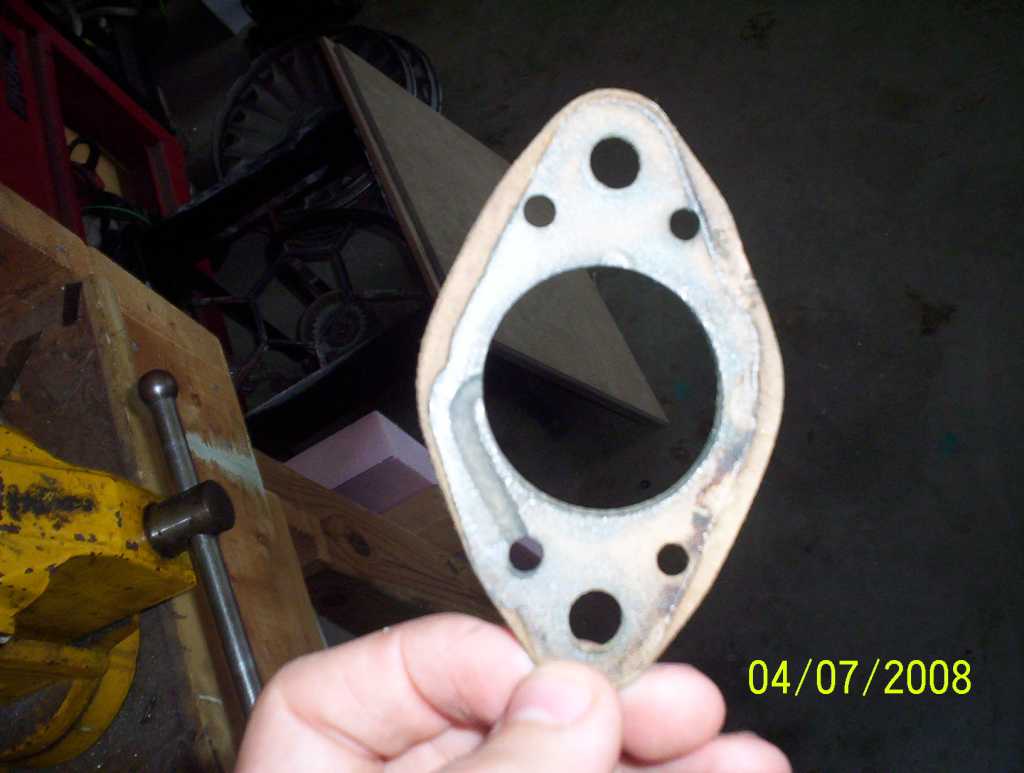

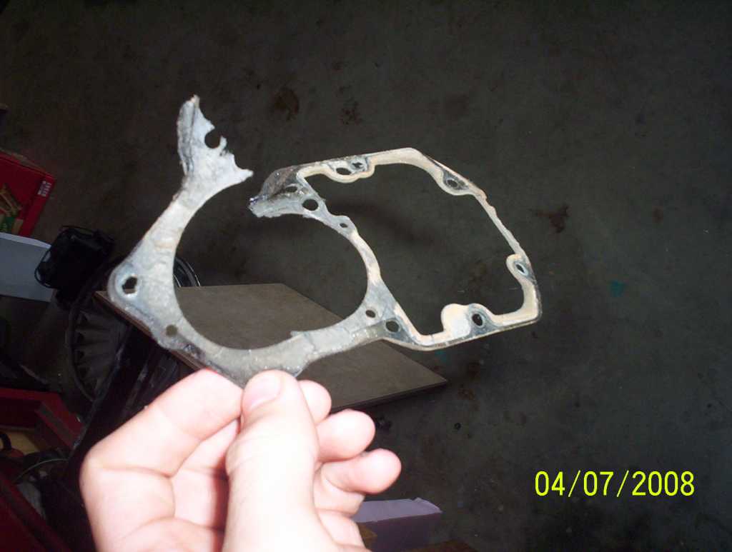

Cleaned the rust, replaced the needle, the choke gasket, main gasket, diaphram, some metal ball things, and the gaskets between log and carb. The fuel filter is still on there. I can't take it off because I don't have a fitting to fit the hole. So the old filter is on and we also have a new filter. I will get some pictures of the carb if I can find my memory card for the camera.

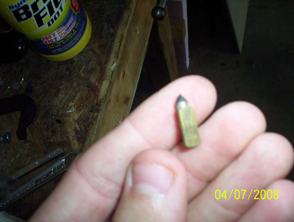

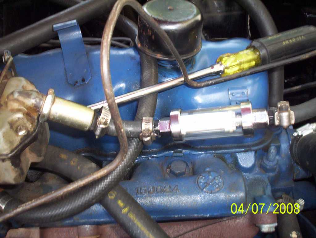

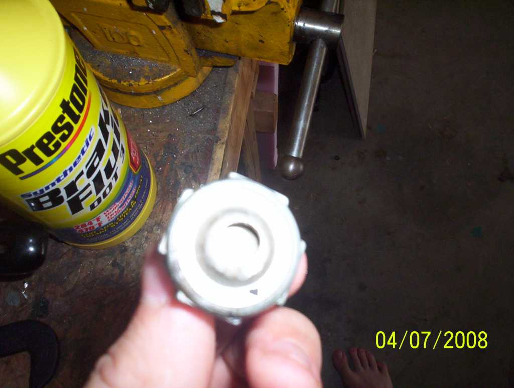

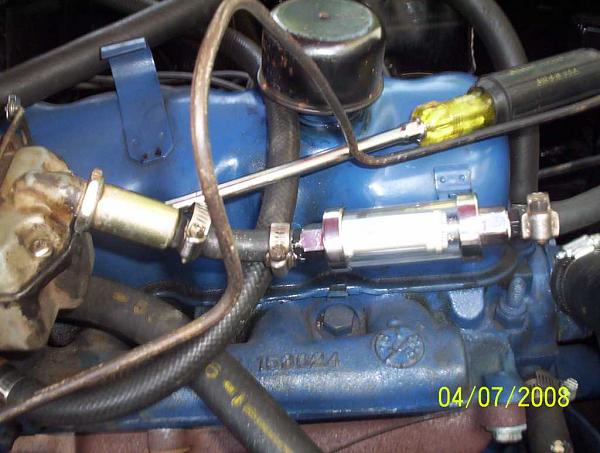

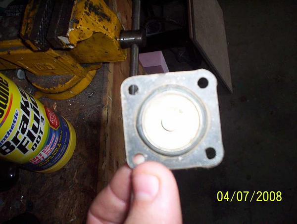

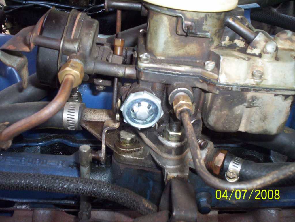

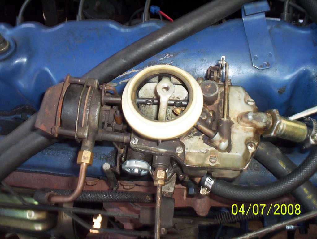

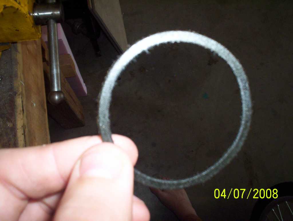

Old Jul 4, 2008 | 10:51 AM
BA Mustang's Avatar
Joined: June 29, 2007
Posts: 4,133
From: Huntsville, AL
Some of the pictures are blurry because the flash went off.
Attached Thumbnails Big Problem-106_6956.jpg   Big Problem-106_6957.jpg   Big Problem-106_6958.jpg   Big Problem-106_6959.jpg   Big Problem-106_6960.jpg
Big Problem-106_6961.jpg   Big Problem-106_6962.jpg   Big Problem-106_6963.jpg   Big Problem-106_6964.jpg

Well the freaking carb rebuild didn't work.... It died on me twice yesterday and also found out it is squirting gas out between the diaphram and the metal. And all the screws are tight...
Old Jul 10, 2008 | 02:48 PM
Puter's Avatar
Joined: January 19, 2007
Posts: 1,494
From: Huntsville, Alabama
Did you test your float? If you replaced both needle AND seat, floats sometimes break or crack and do not float anymore.
What diaphragm are you referring to?
Old Jul 10, 2008 | 03:08 PM
BA Mustang's Avatar
Posts: 4,133
Accelerator pump
Old Jul 11, 2008 | 06:33 AM
Puter's Avatar
Posts: 1,494
There should be a metal ball or an umbrella at the accelerator pump. If it is squirting gas, that means there is a tear in the diaphragm itself, or something keeping the metal housing from mating to the body. Take that apart again and inspect. Find out where it is squirting gas and disassemble and inspect.
