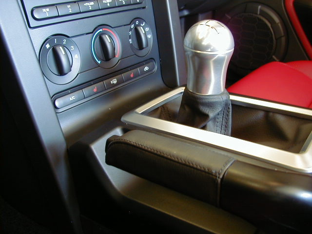

Doug & Hotlap, if you guys have any questions about the e-brake install let me know as I just did the swap in mine. It's a bit of a job, takes about the same effort as swapping out the shifter. You'll be surprised when you get the part (if you don't have it yet) as it is the entire emergency brake assembly! When the box arrived, I was like "what the heck is this thing?" It weighed a ton! I thought Kevin had sent me the wrong part- LOL!
Tres - thanks for the offer - I'll PM you with questions if I have any.....I'm sure you looked - but is there any way to just swap out the leather covered piece of the handle so you don't have to change everything out?

Not that I could see. It appears to be bonded to the arm somehow. Also the arm is not easily removed from the brake assembly, so it appears the easiest route is to replace the whole darned thing (although that doesn't really qualify as "easy" ) Someone needs to come up with a leather sleeve that installs over the stock grip, that would probably achieve the same look but would sure be cheaper and easier!
Tres - after spending some time checking it out, the leather grip is bonded to a plastic sleeve that slides over the end of the metal e-brake handle. I've tried to slide the plastic sleeve off - but it doesn't want to budge. Doesn't appear to be bonded (can't see any glue residue) but can't figure how it is attached to the handle. You can see inside the hollow shaft (where the release lever runs - but I can't see a tab or anything that appears to be a release for the sleeve...) and I'm afraid of damaging it by pulling any harder and the leather "skin" is bonded so well - probably destroy it trying to get it off.

Interesting! Oh well, it's not the end of the world to replace the whole assembly. If you're planning on doing a shifter anyway then replacing the e-brake will only take a few more minutes!
