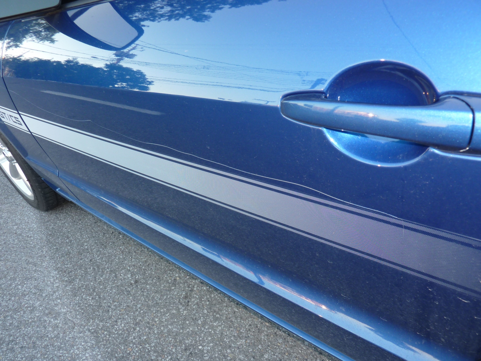

Nasty Surprise - what would you do??
So last week I went out to my car only to find that someone was kind enough to key one full side of it. Today I went to a reputable body shop to get an estimate for the repair. My dilemma is whether to make an insurance claim on it or not. The shop will disassemble anything that touches the panels so there would be no ridges or tape marks in the paint. All three panels on the left side need paint, so the shop would remove the side stripe, rocker panel, front inner fender liner, belt line moldings, door handle, mirror, taillight... everything. The basic cost for the job would be about 1200$, plus another 175$ for the replacement stripe, plus and additional 400$ or so for a full final sand and polish (a full day job).
My deductible is 500$, and the shop says my insurance company won't want to pay for the final sanding, so best case I'm out 900$, or ~1750$ if I decide not to claim. I haven't had any claims for the past 10 years or so.
Would you make the claim?

File the claim, get it down correctly and forget it ever happened. If you don't, you will always remember. The insurance should pay for the final sanding.

If it's not paid for as part of the insurance, if the final sand is an option that's not factory, then yes, it could be exactly that, they won't pay.
But I'd be not letting a shop tell me what the insurance does. Unless the shop is the actual adjuster, and even then, I think I'd be calling my agent to verify, at the very least.

I'd find a different shop first. They're saying the ins co won't pay for things that shouldn't be needed. The sanding, buffing, and denibbing should be kept to a minimum if the paint is applied properly in a clean environment. I would find a better shop, then file the claim. Obviously, when the factory applies the paint they're not spending hours on each wet-sanding them. Take at the look at the orange peel as evidence. Heck, some of your better painters will tell you that the hardest thing about painting a car is getting enough orange peel on the car to match the factory finish for an invisible repair.
File the claim, find a different shop IMO. They're matching a Ford factory paint job, not some custom show-car finish.

The shop is used by a good friend who's a car broker. It's where he sends his high value vehicles to be done. The shop can do all levels of work, the owner showed me some quick and dirty jobs, a job where a final sand might not be necessary, both next to a 160k$ Mercedes.
Basically his opinion was that when doing smaller sections it's easier to get the surface finish right, but it's a lot harder when doing the whole side, when there would need to be more blending of the clear coat passes from one panel to the next (i.e. the quarter gets done, then the door, then the front fender).
I should add that the guy isn't insisting on the final sanding, he's suggesting it given the car's good condition and my pickiness.

Our cars already have a ton of orange peel from the factory...I wouldn't want one side to look THAT much better than the rest of the car.
If you're going to do it, do it right and have the rest of the car sanded as well. If you are that picky, then you'll appreciate the results! Me, I'm resigned to the ripply paint, lol.

So I got the car back from the shop yesterday. I decided just to bite it and not make a claim, I hope history proves that to be the wrong decision (i.e. no more claims!). It took them about 10 days to get the car done, they had to redo the front quarter and the door, a couple of the guys in the shop mistook it for a regular job and not a high end one. I am very satisfied with the work though, I'll post pictures once I get it washed and waxed, and the stripe applied (still waiting for that to arrive by mail). By the end, the owner was fussing over it as if it was his own car. He was feeling proud that the job met my exacting standards...
