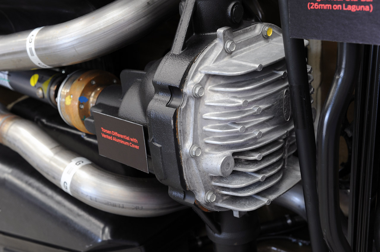

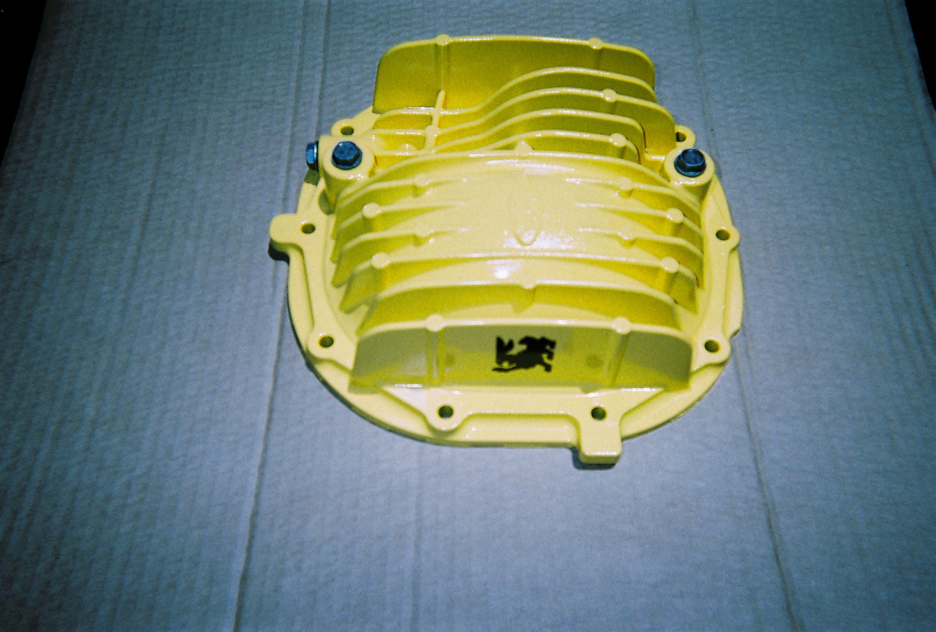

Hey all,I got me one of these off ebay for $ 108.00 shipped,I am now having it painted and drilled out / taped for fill and drain plugs ,its suppost to help keep rear end gear oil cooler .,I will post more pictures later .Name:  !B7wK4N!Bmk~$(KGrHqIOKigEzQnQ00d0BM1HmDCsf!~~_12.jpg
2012 Boss rear end cover .-11-2012-boss-302-underside.jpg ------------Ford part # number for the Boss cover ( longer ) bolts is ( 6L1Z-4346-AA ).
2012 Boss rear end cover .-10-2012-boss-302-underside.jpg -------------Ford Part # number for Boss rear end cover is ( M-4033-k ).

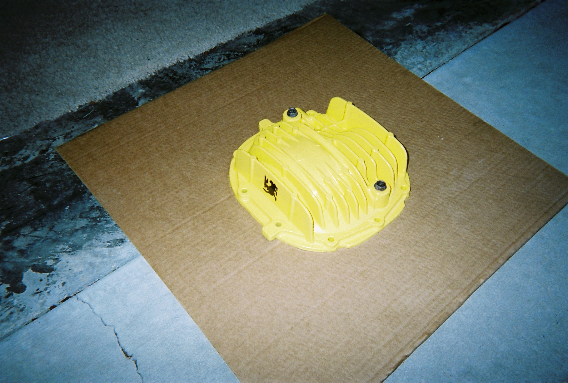

Hey all,I got me one of these off ebay for $ 108.00 shipped,I am now having it painted and drilled out / taped for fill and drain plugs ,its suppost to help keep rear end gear oil cooler .,I will post more pictures later .Attachment 87468
Attachment 87469
Attachment 87470

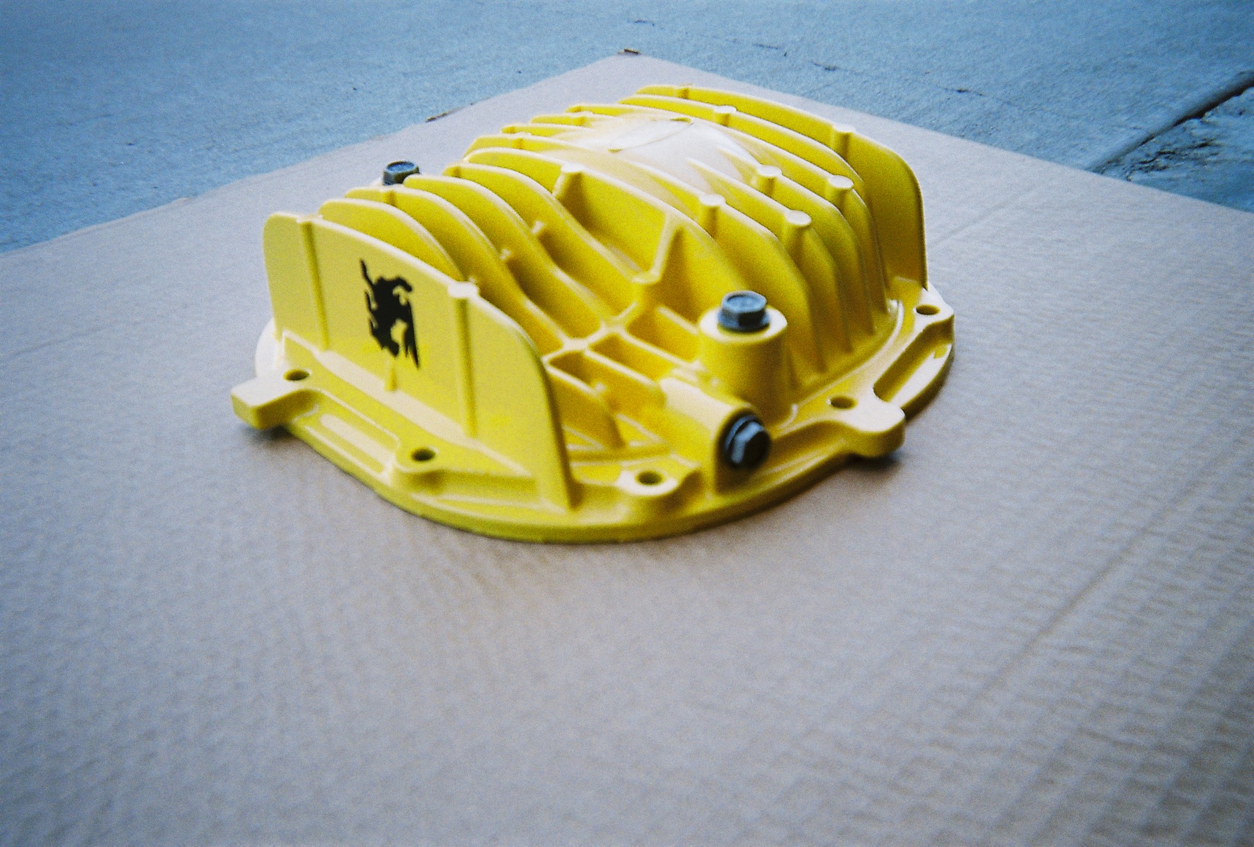

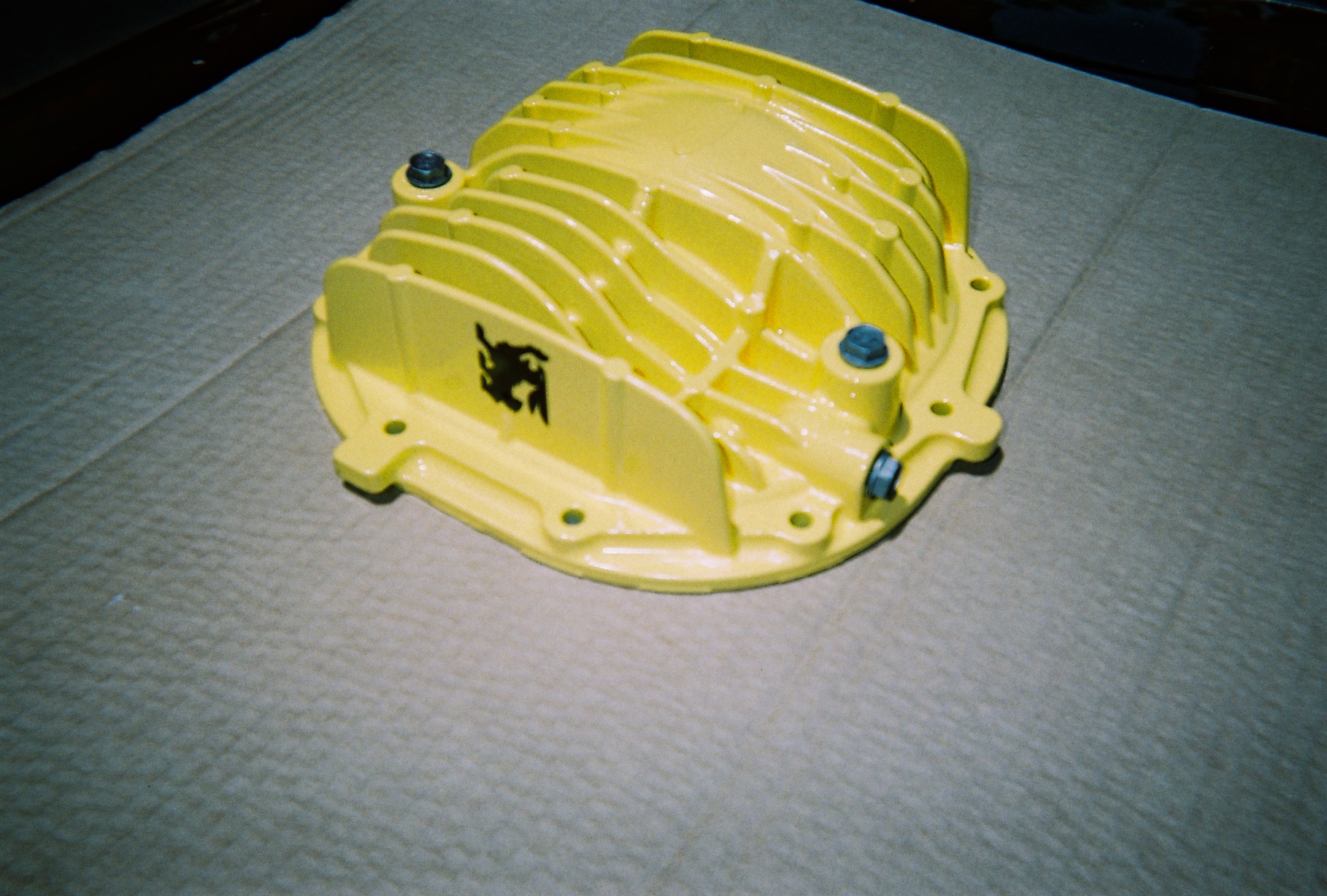

here are a few new pictures after paint and drill tapes in ( fill and drain plugs installed ) you can see the difference , ,,,,,,,,,,,,,2012 Boss rear end cover .-000260-r1-09-16a.jpg
2012 Boss rear end cover .-000260-r1-19-6a.jpg Thank's to all for looking in,,I will post more pictures after I get it on .

Hey your rear end is yellow!!! lol
Old May 8, 2011 | 09:36 PM
Good find Rick. Yet another mod I see in my future. Minus the yellow paint of course.

yes I know ,,,here is something really funny ,I just ordered the rear end cover bolts that are used with this Boss cover from Ford ,cost me $ 100.00 ,for 10 of them ,they are longer than the stock ones ,so by the time I'm done with this little Mod ,I'll have just over $ 300.00 dollars in everthing ,,the cover ,bolts ,Royal Pupple Max-Grear synthetic oil,( SAE 75W-140 ),$ 18.00 a quart ,,and Ford friction Modifier,$ 6.00 at Ford dealership 4fl oz bottle .but it should last for many miles and years to come,,but most important ,it will be alot better than it is stock now.

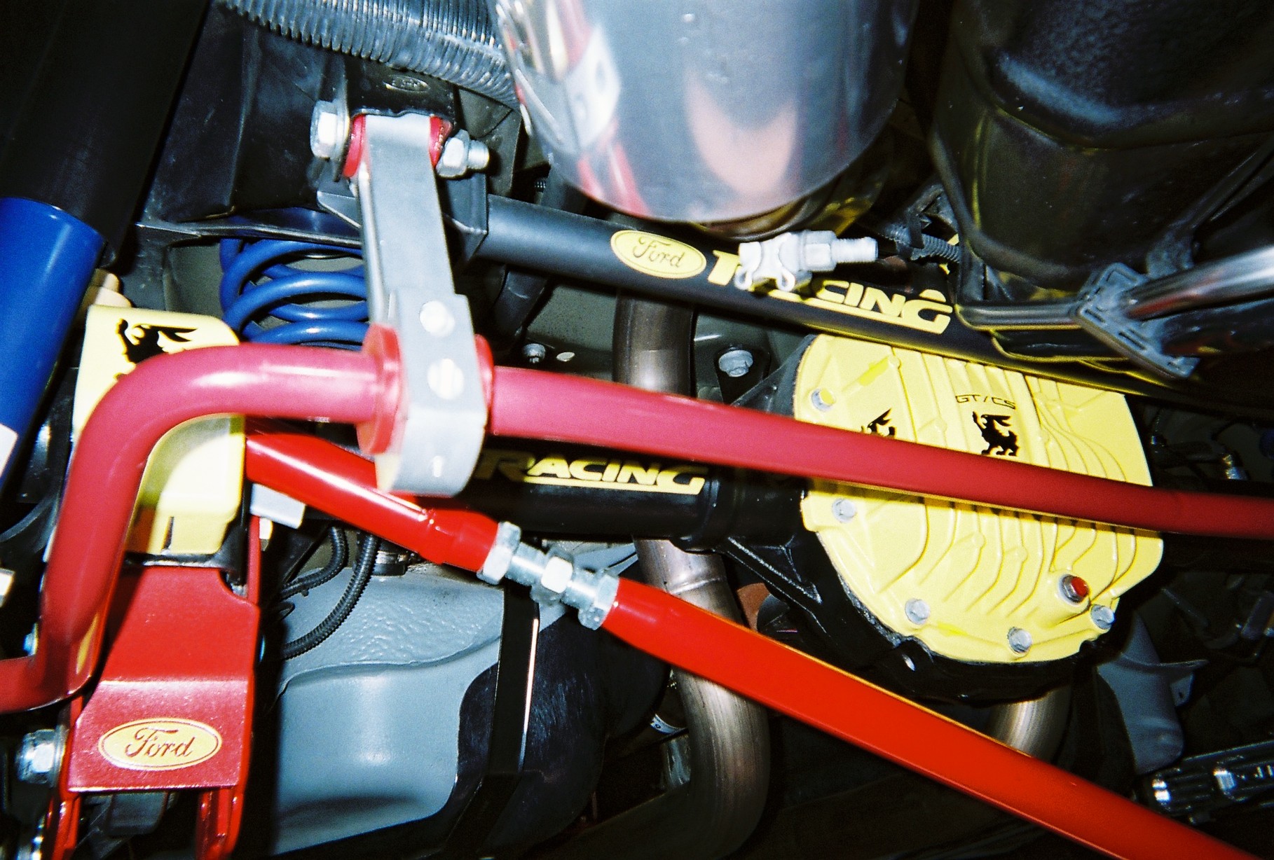

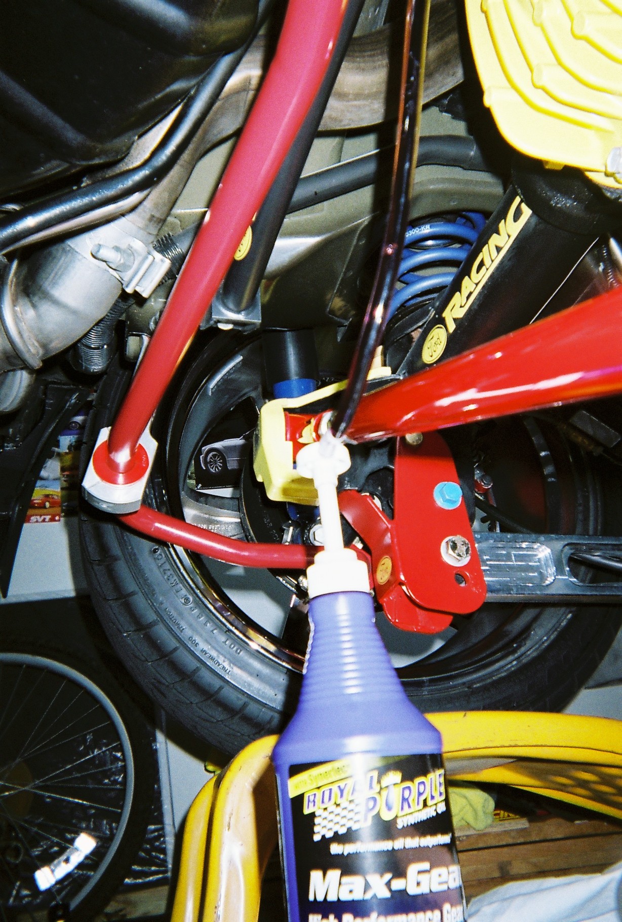

here are a few pictures of the install ,, ,,,2012 Boss rear end cover .-000143-r1-22-21a.jpg be sure to clean off the old gasket really good before instlling .
2012 Boss rear end cover .-000143-r1-20-19a.jpg no stopping now . I got the pump thing at Wal-Mart cost me $ 10.00.

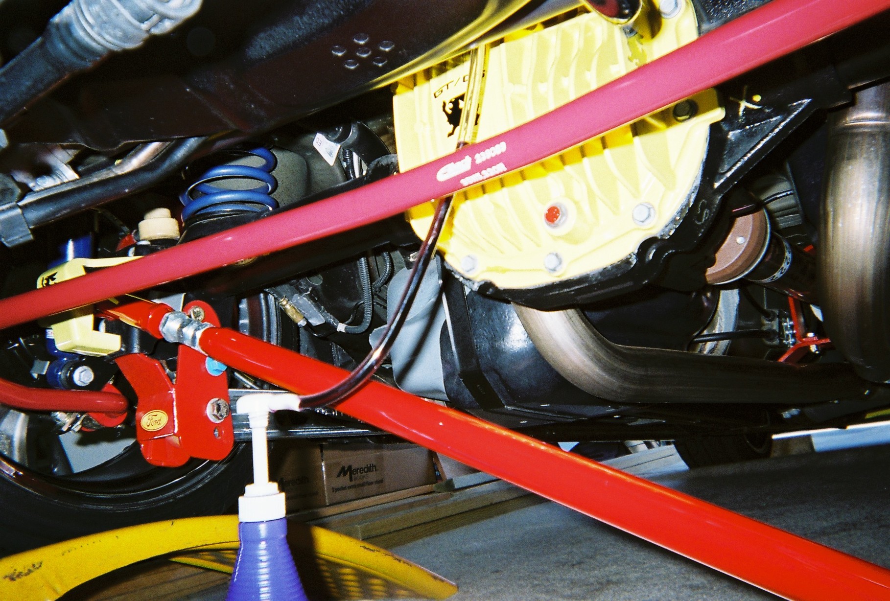

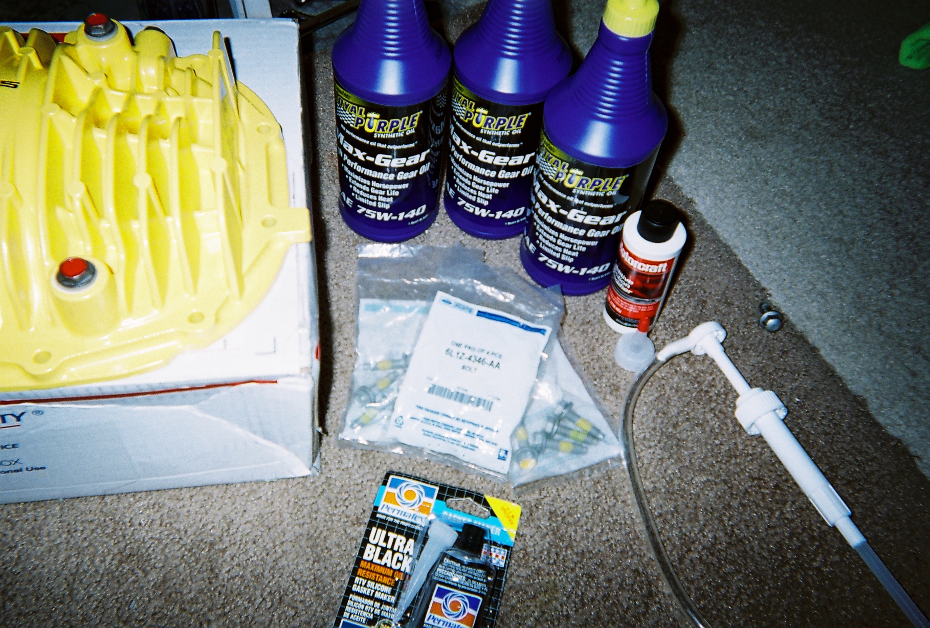

ricksGT/CS's Avatar
Joined: February 18, 2008
Posts: 1,511
From: Biloxi,Mississippi
Talking
here are a few pictures of the install ,, ,,,Attachment 88033
Attachment 88034
Attachment 88035 no stopping now .

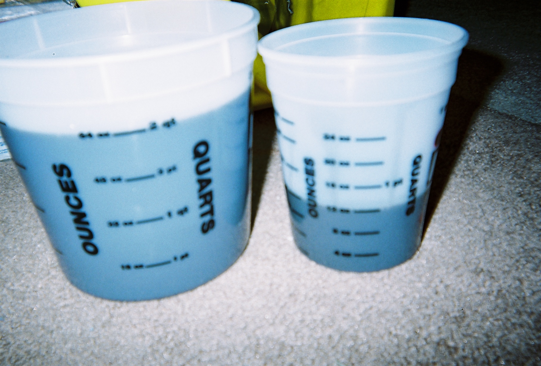

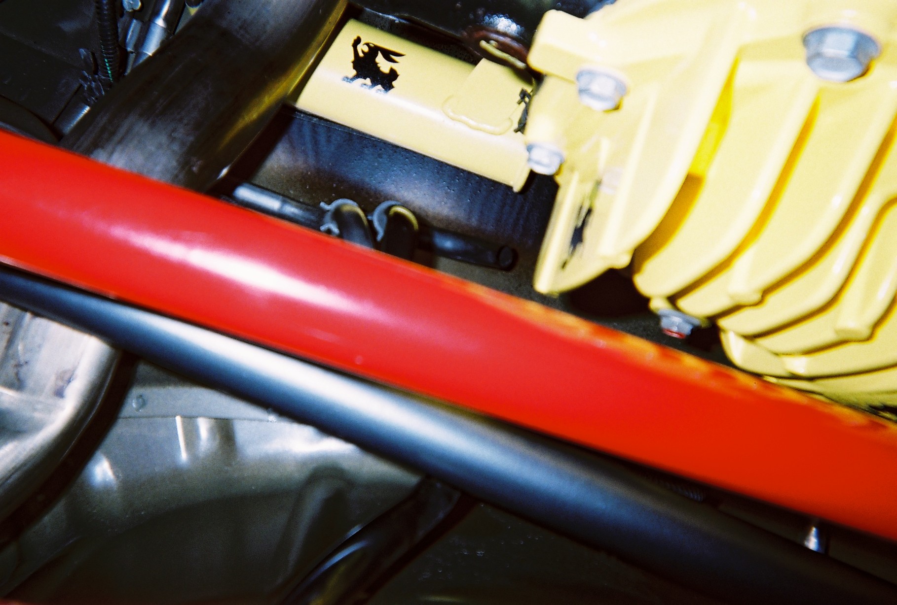

2012 Boss rear end cover .-000143-r1-03-2a.jpg I got out 76 oz's of old gear oil ,thats two ( 2 ) quarts and and 12 oz's.
Old May 17, 2011 | 06:12 PM
ricksGT/CS's Avatar
Posts: 1,511
Talking
2012 Boss rear end cover .-000143-r1-01-0a.jpg All and all it went pretty easy ,I like it .

thanks ,,,and I had a engine rebuild shop do the drilling and tapping ,cost me $ 30.00 to do two holes in front sizes 7/16 -20 thread ,with the short bolts and plastic washers too,

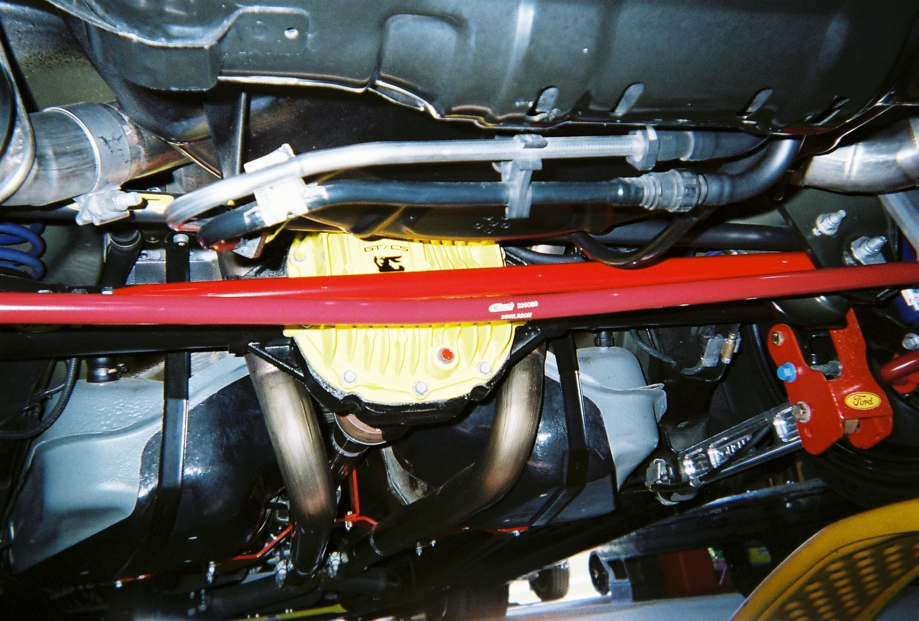

Old Jun 8, 2011 | 08:26 PM
ricksGT/CS's Avatar
Posts: 1,511
Talking

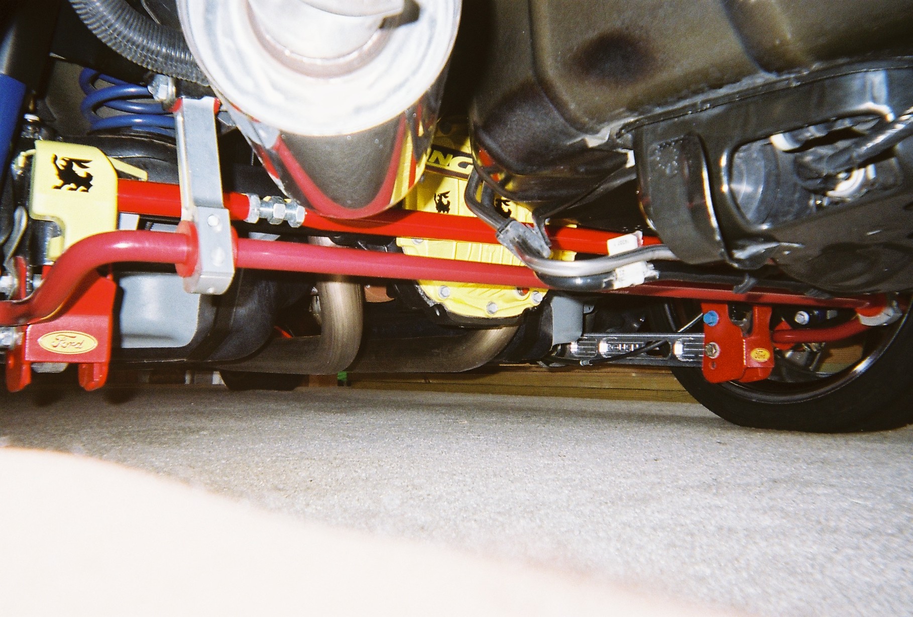

still going strong ,I put over 1300 miles on it two weeks ago, on a tripe to mid Florida to see a friend and back ,here is a picture as of today ,on the ground ,,Rick does good work 2012 Boss rear end cover .-000392-r1-07-6a.jpg
