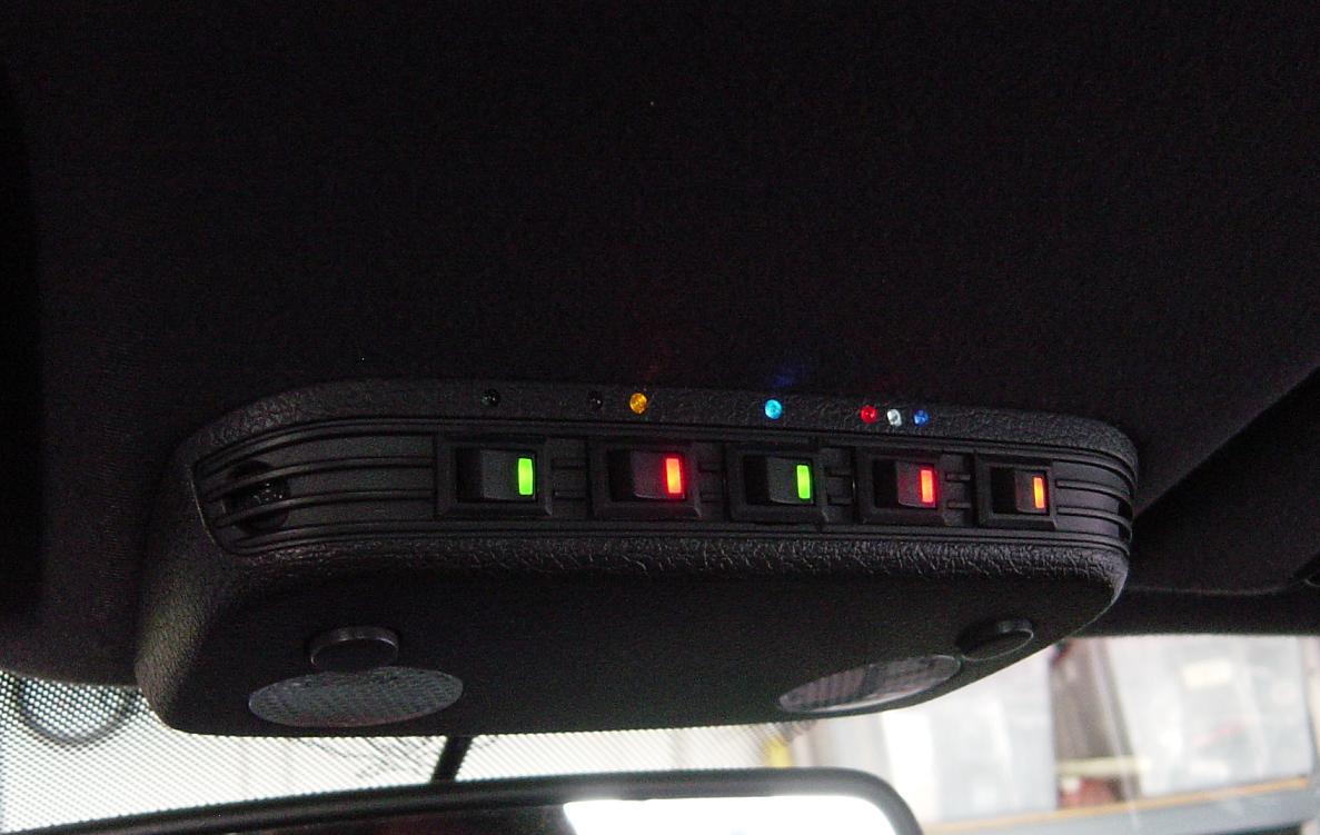

I have installed a series of switches and indicator LEDs on my overhead console. Okay, one pic only.... Sorry, no description.

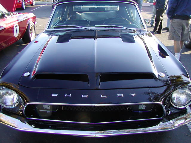

Actually, It's the 68 hood revisited.

Actually, you missed the point.
My reference was associated to the turbulance of the 1967 hood which appears you are not aware of. Designing and producing a hood for cosmetic looks and nostalgia is one thing, making sure it is without flaws on a car with different dynamics is another.

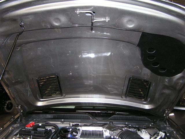

*update* My buddy had his shop install a baffle and all the issues with running lean are history
