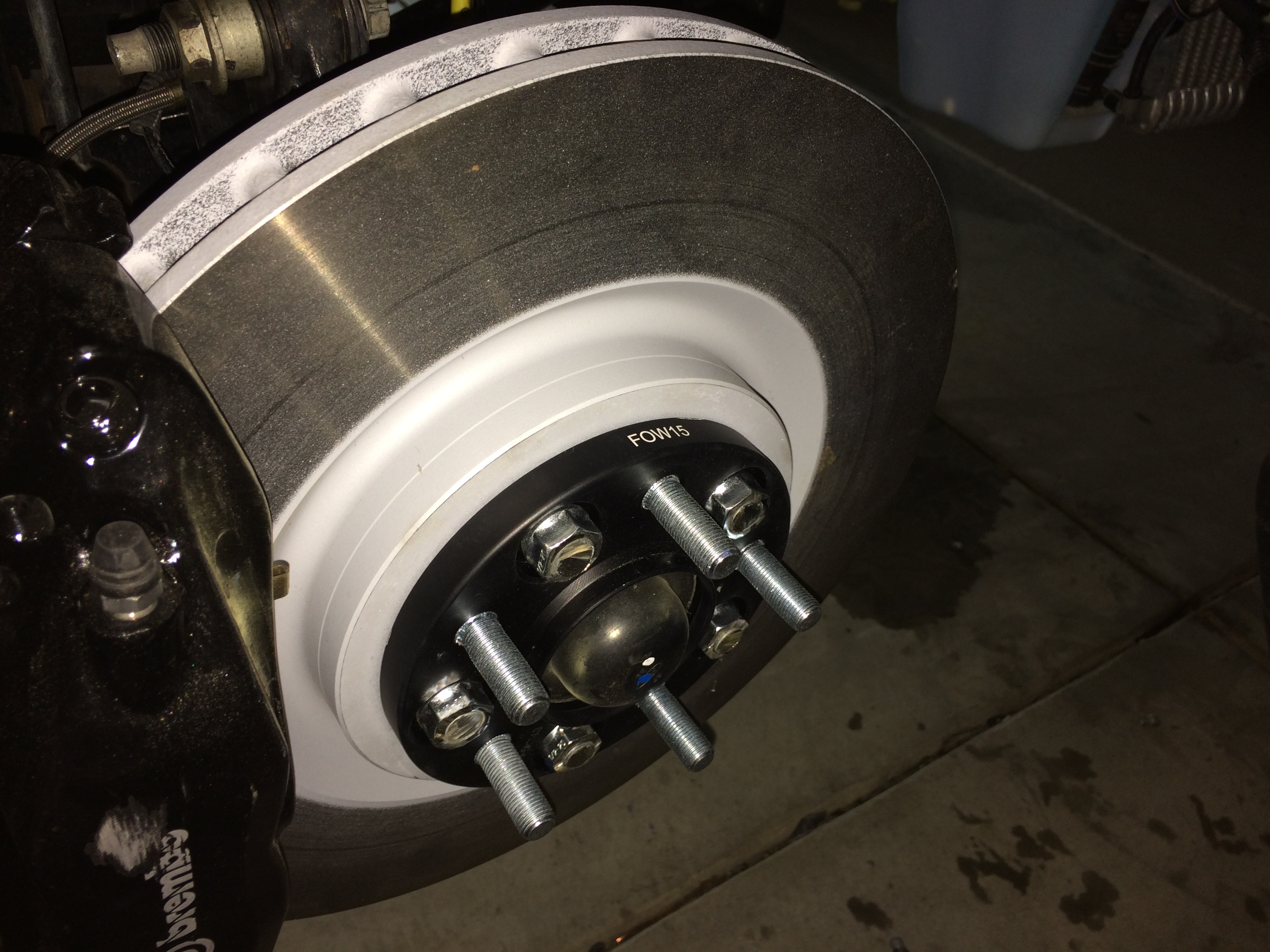

I used 15mm (5/8") wheel spacers to clear brembo brakes on a 2010 mustang with GT/CS wheels. The wheel clears the caliper by 1/16th or less. I had to cut off the ends of the factory studs to bolt the wheel up. Looks great

I just found these while deleting build pics
Attached Thumbnails Wheel Spacers/Adaptors-image.jpeg

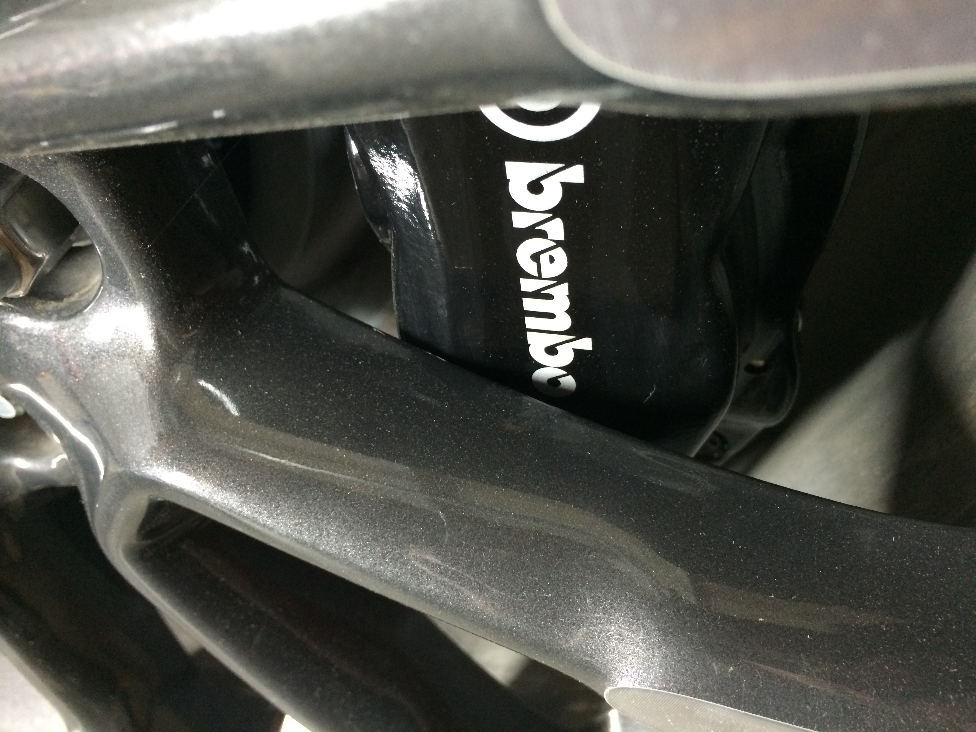

Pretty close but it clears

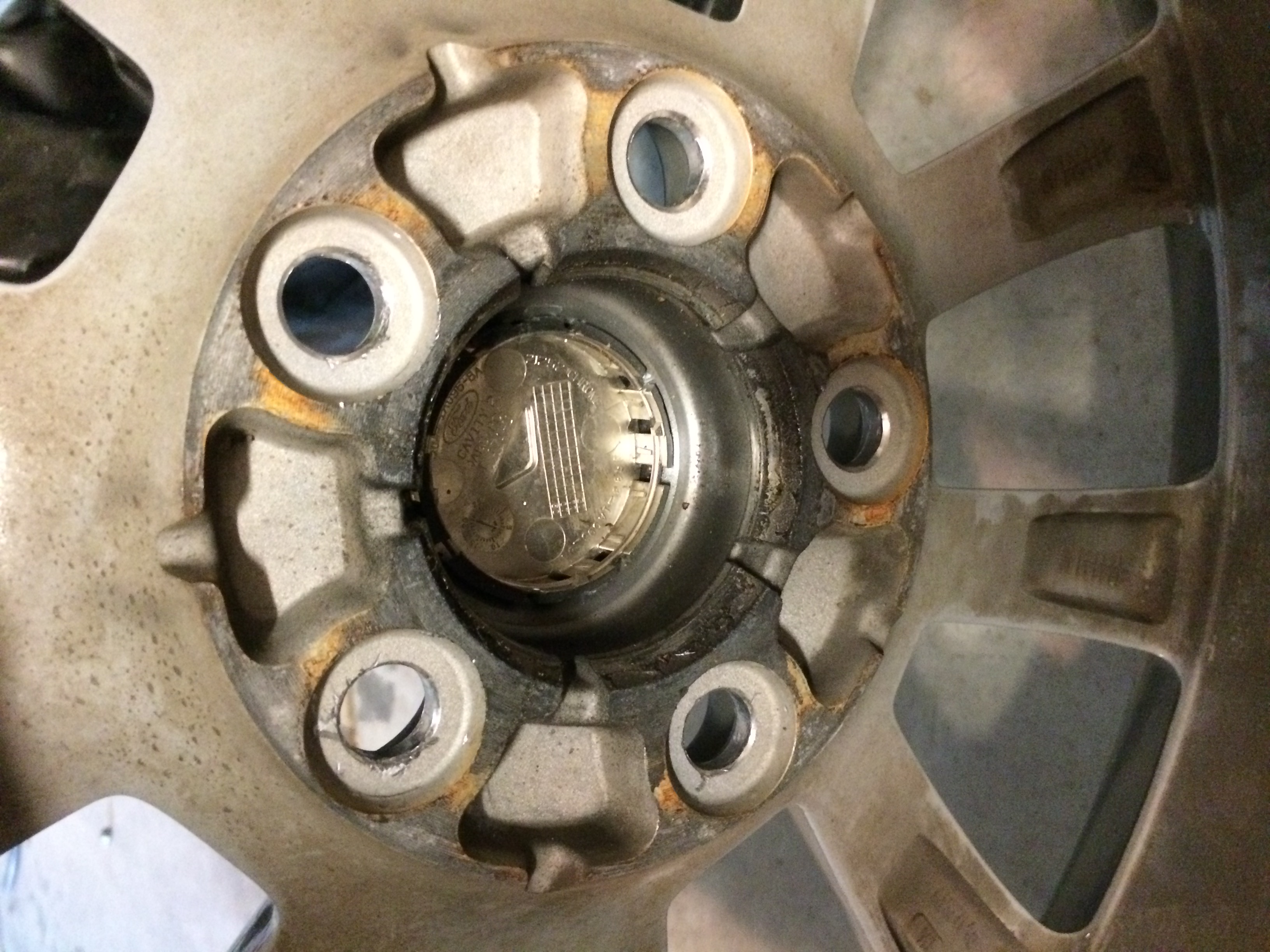

Wheels needs these pockets in the back to run the 5/8" spacer

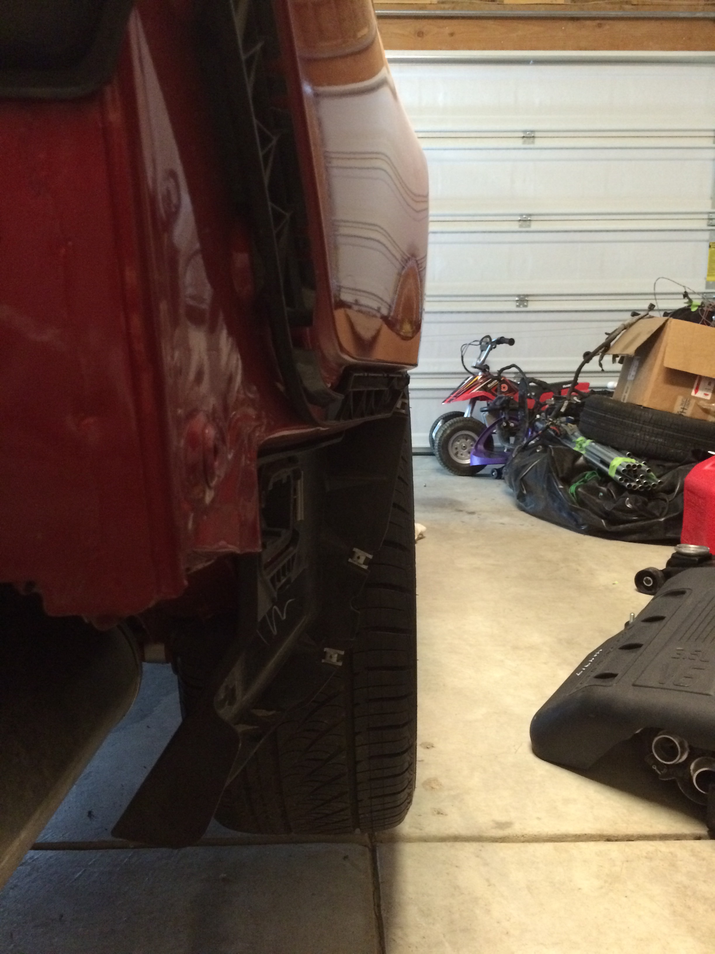

From the back, bumper is off the car. You can see it doesn't stick out with these wheels.
