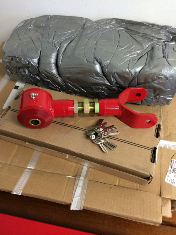

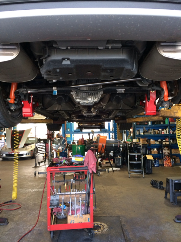

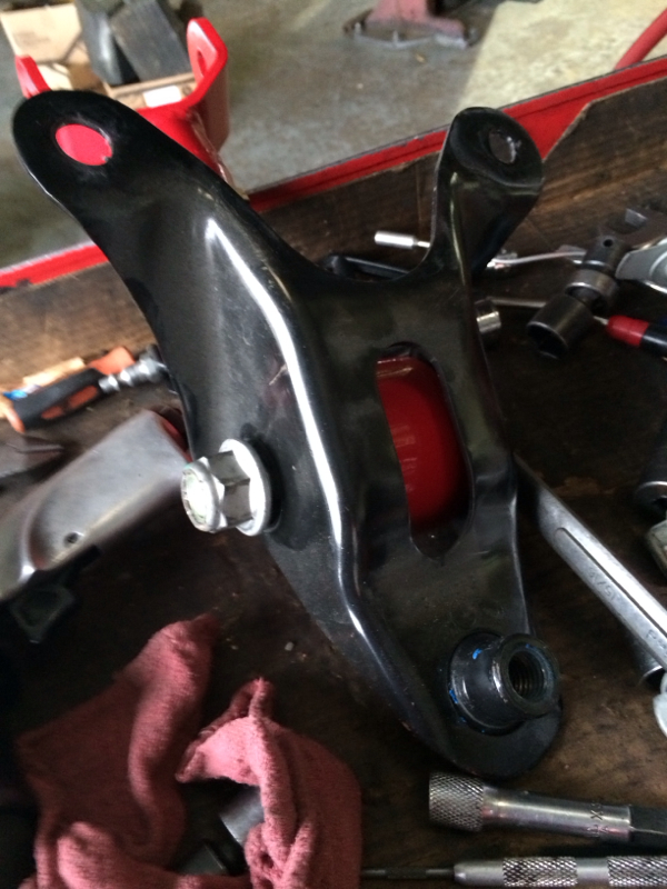

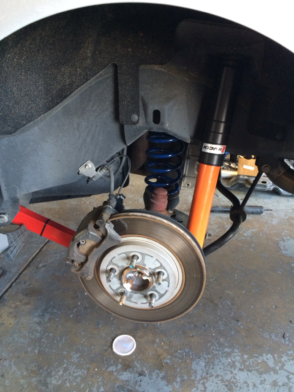

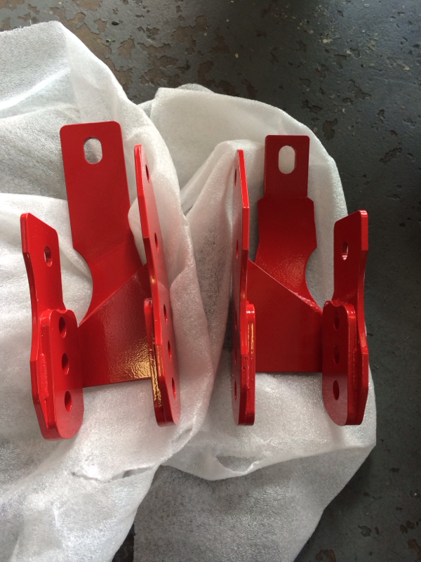

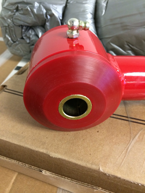

Our s197's have a 3-link rear end. The lca's are the 2 lower links, and the uca is the third. The overly soft rubber bushings in the stock arms are good for a compliant ride, but allow for a lot of play...which is wheel hop. The oem links are made of stamped steel which lacks rigidity and flexes relatively easily. This though, is not what causes wheel hop on the street. The mushy rubber bushings are the cause. By changing lca's, you are upgrading to poly bushings which allow very little play. Arms w spherical bushings are for track applications only and not the most suitable for use on the street as they have more nvh and will wear out faster than poly. Ok..so now you are not absorbing the movement in the lower arms, this means you are transferring that duty to the stock uca with its crappy rubber bushing which allows the axle to still pivot...which is wheel hop. You must change the uca along with the lca's to take advantage of the poly bushings on all 3 links..this is wheel hop elimination. The uca bracket is not necessary if you are breaking the rear end loose on the street w summer tires. Plus, TP cars already have a heavier duty bracket than regular gt's. However, if you are dumping the clutch at 4000 at a sticky drag strip with slicks, then maybe non-TP cars need the upper bracket. LCA relo brackets are only needed to adjust angle of attack for traction on lowered cars. Adj uca is needed only on lowered cars for adjustment of pinion angle to eliminate DS vibration. So to recap, if you are not planning to lower your stang, but want to further reduce hop, get a cheap non-adj uca with poly bushings. Bmr makes beast pieces and Jay@hypermotive is where I'd start. Here are some photos showing where I may have picked up a thing or two in my quest to kill the hop. I was successful, but this is somewhat overkill bc I do not frequent the strip
