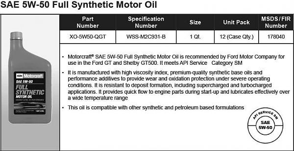

The way I read the owners manual is, the recommended Motorcraft 5W-50 (XO-5W50-QGT) does not need to have the API SN certification mark on the bottle label.
Any other brand will need to meet API SN requirement and have to display the API Certification Mark for gasoline engines on the label.
You should be just fine with your warranty using Motorcraft XO-5W50-QGT.

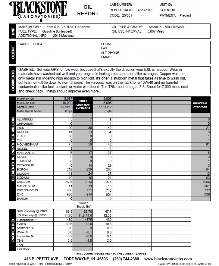

I'm using Amsoil 10w40 XL full synthetic and love it.
6-7k in-between oil changes, no oil additions needed/done, and the Used-Oil Analysis from Blackstone Labs came back great.
This is an older test, the first one for the Amsoil:
Attached Thumbnails Track Pack Engine Oil Confusion-2013-04-29_amsoil_10w40xl_no-info.jpg
