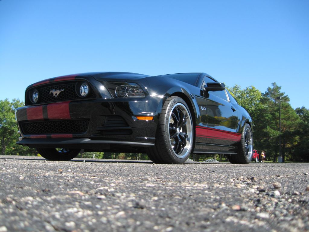

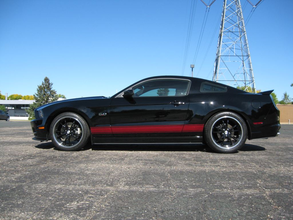

Originally Posted by MJJ
I have steeda sports.
So do I....
Attached Thumbnails Stiffest springs recommendation?-003.jpg   Stiffest springs recommendation?-004.jpg
