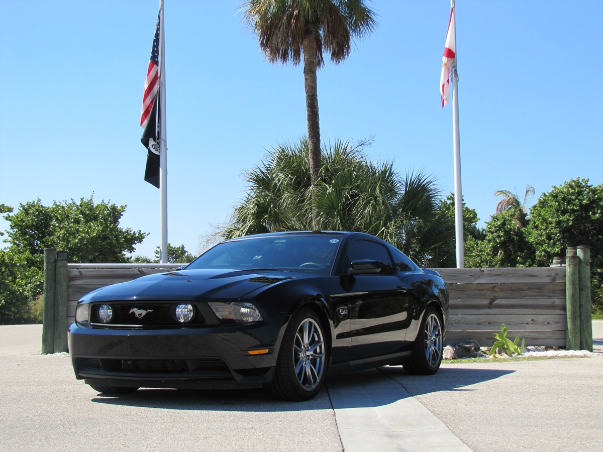

I'm am almost certain that you will LOVE the Steed Ultralites. That's what I've decided on and these springs have not only improved the looks and stance of the vehicle, but have certainly improved the handling, without the loss of ride quality!
If I was given the choice again, I wouldn't change a thing and would go with Steeda over and over again. Hands down!

So just the Ultralites and nothing else? You left everything else stock? Mounts etc.?
I think I want to do that rout as well. Does it eliminate the highway bounce the brembo comes with? lol

Everything is stock, except of the Steeda Adjustable Panhard Bar. In order to properly allign the car when lowering, I truly felt that this was a necessary accessory.
