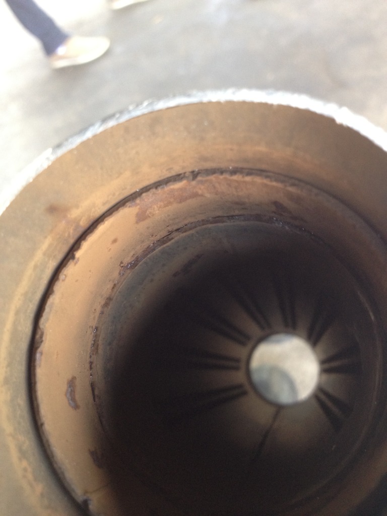

They are mainly for sound not BP. Here is what one looks like on the inside.

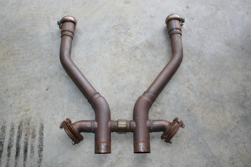

Not really, most catbacks for our cars include a mid-pipe (usually 3" X or H), OTA pipes (usually 3" and mandrel bent), and axle-backs that will connect to their own OTA (usually slip fit unlike the ball clamp joint of the stock system).
If you look at the stock H-pipe it kind of necks down at the bends down to 2.5" IIRC, so most of the gains of a true catback will be in completely better exhaust flow from the cats back...

The stock Boss H-pipe has the same neck down issue the GT/Coyote does; although no doubt it flows more with the side pipes open.

Originally Posted by Azrael
Pretty much, is it the stock Boss H-pipe with the side exhaust? IIRC they neck down too, but not sure as I type this; I will have to go find out.
The general idea of a catback is that it works well throughout its replacement of everything from the cats back (hence the name). Generally though resonator-deleted or aftermarket OTA pipes tied in with an H-pipe will basically be the same thing. That is what I have done, MBRP 3" H-Pipe with resonator delete...
Mine has the Boss Side Exhaust came off of the Boss302 Laguna Sega, took out the restrictor plates and resonators removed. GT500 single axle backs. Not sure H-Pipe on these are 3" tho.
All the images I see about Catback systems show straight OTA pipes with Axlebacks attached at the end, so was curious if I ended up creating the custom Catback of my own. Sorta.
I might replace the GT500ab with something else down the road, possibly Corsa Extreme. Love the exhaust sound on Mustangs hehe. Louder!
Thank you for kind advise!! Guess I'm stuck with these though, love the side pipes
