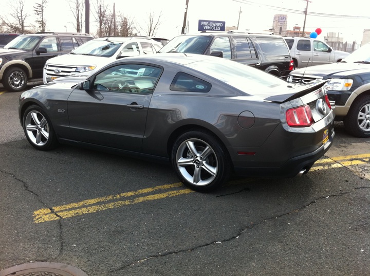

Yea tell me about it... with the excitement of getting my 1st brand new car I totally missed that this car had prior bodywork, I realized it a few days later... I snapped after I found out and took the car back... I highly recommend anyone taking delivery of a new car to do it in daylight
What body work did you find?
Look at the paint difference between the door and 1/4 panel!

I figured that was just the picture or glare from the camera.
Yup :-o!! I never been so mad in my entire life!!! Lol I found out when I took it out the garage in the morning, called out of work and took it back to the dealer... they offered to fix it and I refused and told them they can keep it and I'll seek legal action... general manager said its registered to me now so I left the keys and said "tow it then, I'm not putting that back in my garage" 2 days later they call me 2 days later they call me saying they found a similar Race Red so I went with that... I was more upset with myself cuz I do paintless dent repairs for a living. But I guess the excitement of my 1st new car blinded me :-/
