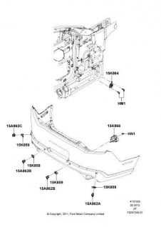

No direct experience, but from what I'm told you can paint the bezel around the actual inner sensor itself but not the sensor. But a body guy I spoke to said they could paint the sensors as well but they need to disassemble them and paint the bezels In normal fashion and the sensors themselves can be painted but have to keep the paint to a certain thickness (15 or so microns thick). This will probably cost money.

As per Ford Parts cataloging the RETAINER or BEZEL is Paint to Match. It is separate from Actual sensor so you need To Remove sensor and Simply Paint the Retainer.
