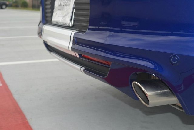

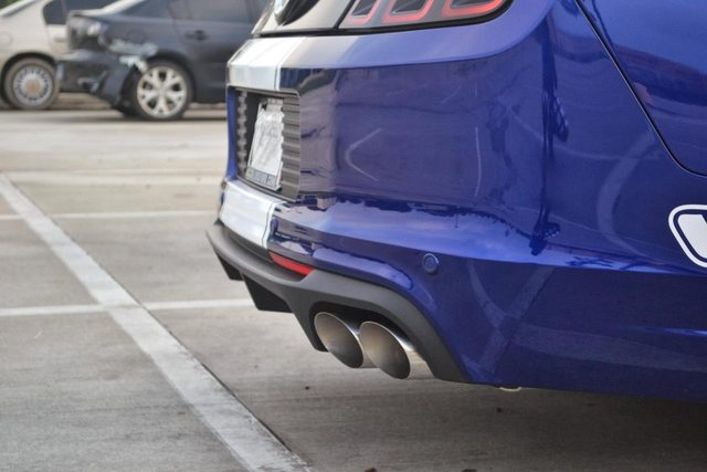

you would need to buy a rear valance from local ford dealership for 199, part number DR3Z*17f828*AB. Worked well for my 2013. i had it installed by dealership costed me $224, i m not a good DIY person. but there are several people on this forum who have done it.. it involves some cutting..
BEFORE

AFTER

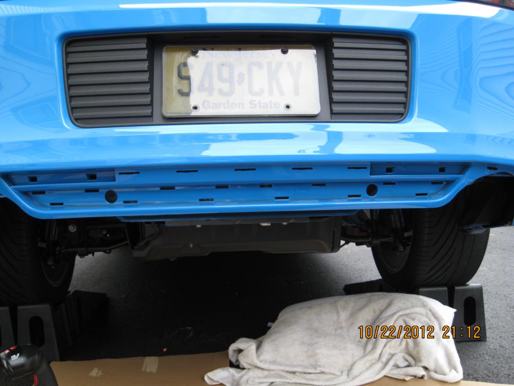

This is what you have to cut.

That looks great. Did you also order the exhaust from Ford? Any mods to the exhaust or just a swap?
Thanks. I've done a few projects but I don't think I'm up for cutting the car myself.
Yes I ordered it from FRPP, it is just a swap.
