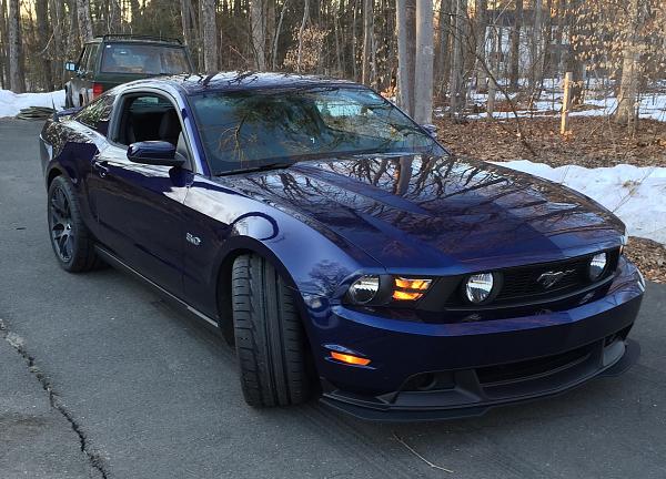

285/35/19 all around...nearly identical to stock diameter, good tire choices in that size, no rubbing.
You'll need a 9.5" wide rim minimum.
