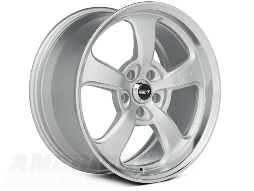

By "classic" looking what do you mean? Unfortunately Brembo cars will not fit many low offset dished wheels (bullits for example) because of the caliper...
I'm in PR by the way!
edited:
try americanmuscle.com, they should have a 5 spoke wheel in 18" that should fit.
Mickey Thompson SC-5 (18") - says that they'll fit '13 Boss (which has our brakes)

King, by classic I meant wheels with thicker width spokes like the SC-5 not thinner spokes like the Forgestars. I had looked at the SC-5's but Silverstate777 mentioned in this thread that he did a test fitting and they cleared the Brembos by 2mm which is really very little clearance IMHO. He suggested a spacer, but I'm still researching safety issues on those. So far the SC-5's were my first choice. Is it OK if I PM you?
