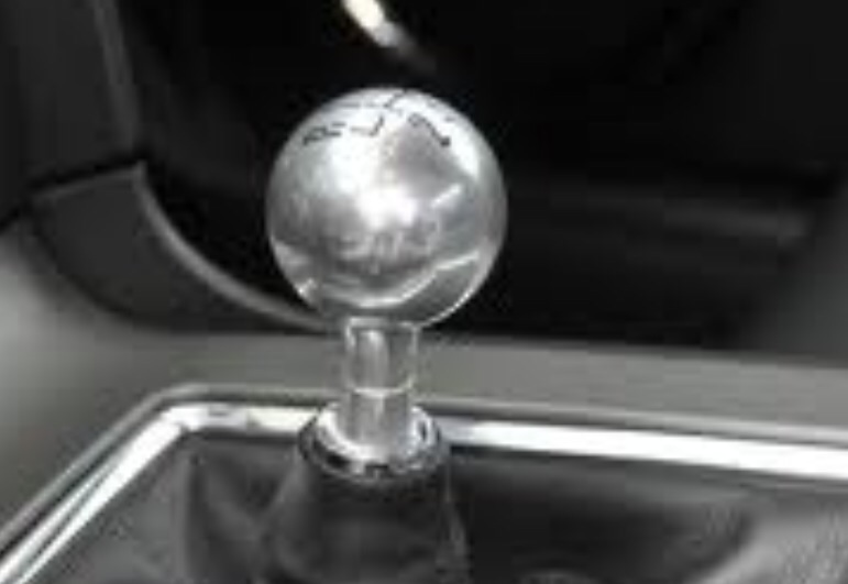

So, I am very seriously looking at making the leap. Just curious, I have the 401A interior and really like my aluminum shifter ball. Will it fit on the MGW shifter? Can you use the stock boot?
For the love of GOD pull the trigger, you'll wonder why you didn't do it sooner once you drive it. You reuse your stock boot and when you call and order just tell them you want to reuse your stock aluminum ball and they'll make sure you get the right stick. When I ordered mine they didn't even ask about threads but I had ordered their white ball.
