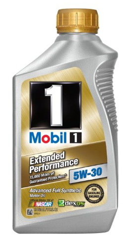

I'd like to share my thoughts on this. I am no mechanic by any means, but I came to conclude that our cars are very sensitive to kind of oil used, and this ticking issue we're experiencing is the result from it.
Why should we even have the noise in the first place is a BIG mystery, I have never ever encountered such an issue NOT from as simple as basic car maintenance like an oil change, until I own the Mustang that is.
1st Oil Change @ 6K-ish:
I asked Ford dealership specifically for a 'FULL SYNTHETIC' (just because).
So this was Motorcraft 5W20 Full-Syn.
No tick, I was not aware of the issue at this point.
2nd Oil Change @ 12K-ish:
Did the same at Ford Dealership.
I got the tick immediately.
Noise ultimately did go away.
3rd Oil Change:
Ford Dealership.
Asked for Motorcraft 5W50 Full-Syn (not a track-pack car).
Noise came back and it was LOUDER.
4th Oil Change:
Dealership does not have a CLUE what's causing it or what it is.
Went to Walmart and bought MOBIL1 5W30(!) Full-Syn 'EXTENDED MILES'.
I asked Ford Dealership to put this instead.
Noise has disappeared(!).
The Engine sounded/felt different after 4th Oil Change. It was Smoother. I've never felt this way on previous three occasions. The noise was still there but it was quickly fading away after some miles. Now I do not hear it anymore.

I use this oil, except in 5W20, and still have the tick. I really don't think different oil will solve the problem.
Maybe not, maybe yes. It was a 'yes' in my case. Not sure if this particular oil is just masking the noise or whatnot, but I'm happy that my ticking is gone, for now anyways.
Is your next oil change due soon? If so, I wouldn't hesitate to give another try for different oil. You already have the tick, what have you got to loose. Btw, what you're using and what I used is DIFFERENT (Yes, they are the same Mobil1 brand). Mobil1 EXTENDED PERFORMANCE 5W30.
I will note this again & again. Our cars are VERY SENSITIVE. Also, I did NOT pick up 'extended performance' crapp so I can have longer intervals. I bought these because the 'regular' ones were out of stock at walmart LOL! As for 5W30 viscosity, yes I chose them purposely over 5W20 (or 5W50). It seems my car likes them so far.
