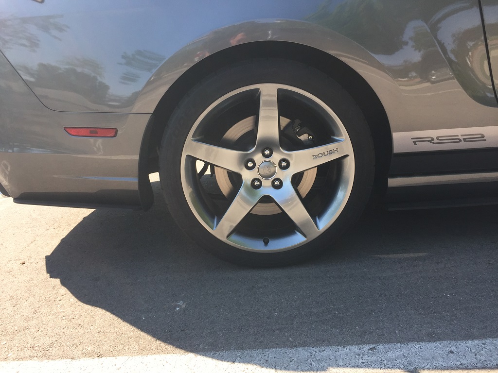

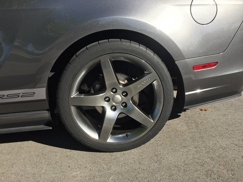

Well it is done!
Got the parts installed today by a neighbor of a friend who just happens to be a Ford Master Mechanic. I consider him a friend now too. Great guy. He did this basically for a personal favor for very cheap. I think he really just wanted to take my car for a drive. It took him about 3 hours. Cost me less much less than expected for parts, labor, fluids, and everything.
Since it was completed earlier today, I have put about 70 miles on the car. Nothing that would really stress or put the new config to the test. But in daily driving I noticed no significant difference in the operation. Maybe some less nose dive, but did not do any real hard braking. Just some stop and go freeway braking and some normal run around town driving.
But boy I am happy with the results, it really does it look much nicer. Here is a before and after shot to give you an idea.
I will update more once I have put a few more miles on the car. I am very happy with doing the OEM brackets and parts. And I am very pleased with the looks, so much better with those big 20" rims. These pics should give you an idea of the change in looks. Very please. Great Upgrade.
Oh and did I mention that I am very happy with the results! Now the rotors match-up very well with the 14" brembo's on the front.

Looks great! I kind of want to see both the front and back in one and how they look. Any tips on the install? How was removing the axle, what did you use for differential fluid?
Could you also please list all the part numbers used, I understand you chose to replace every bolts?

Well done! Looks great. Just an FYI...I doubt you will see any improvement in stopping distances or pedal feel - especially for street driving. The real improvement comes during autocross or road coarse driving, where the larger rear rotor surface will dissipate heat better (much better).
Joined: July 7, 2013
Posts: 3,191
Likes: 1,350
From: Idaho
Agree, after doing piles of research the only real mechanical improvement will be the dissipation of heat to the rear rotor. This could help prevent brake fade during times of excess braking like you mentioned. (i.e. autocross, road courses, and possibly road trips with long down hill travel.) There are a few of those very steep, long down hill grades close to my neck of the woods.
But my primary reason for this upgrade was to get rid of that wimpy looking rear rotor. Goal achieved!
