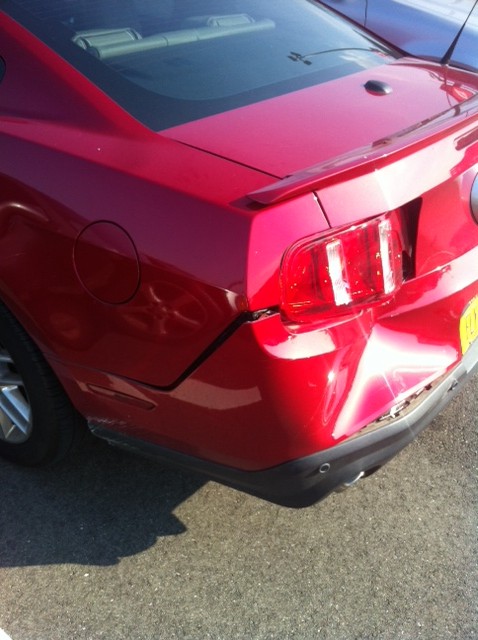

Hi, this morning I got into an accident in my mustang. I was backing out of my driveway when my father's car suddenly pulled in. His car was stopped and I backed into him at about 8mph more or less. The rear sonar doesn't work anymore. When I put my car into reverse it no longer beeps when an object approaches. The lower black bumper has a small crack in it. The upper bumper has a big dent but I think the mechanic can heat it up and push it back out. The metal part of the trunk that extends down is bent a little bit. Maybe they can bend it back out. The lights all still work but the outside plastic is cracked. My insurance doesn't cover this because i don't have full coverage. According to the pictures is anything else messed up? Please let me know what I have to do to repair this at a low cost. Any suggestions will be appreciated. I don't have a lot of money right now.

First off, I'd immediately pull the bumper cover off and pop it out.

If you're lucky, it'll just be a new bumper cover, new tail light lens, and the plastic molding behind the cover. Next guesses are the reverse sensors are either broken or disconnected. You'll really know once you start taking it apart to see.

It's impossible to see what else was damaged until you get the damaged parts off.
0) Take the bumper cover off and pop the dent out (it's just plastic, so this should be easy), but if the bolt holes were ripped out, it's not salvageable.
2) You definitely need a new light.
3) The decklid can probably be repaired, but it might be cheaper to get one in the salvage yard.

Ok well I am not going to mention the insurance issue but will address the bumper. I backed into our bike trailer and dented our expedition body - similar type of plasticky material as it appears your bumper is (smaller dent) - and it kinda separated from grey bumper too like yours.
Anyways - I took a large crowbar we had LARGE and "hooked" between the two bumpers where the hole was and worked it around and bent it back (pushed it) from the inside back out. Worked like a charm. You can still see the distress marks from the bent plastic but at least it's not a dent anymore. Essentially find a way to get something up behind the bumper inside and pop it out. Our sensors went out too for a couple of days. It some I fixed this and checked the connection they started working again.

I would expect damage to the bumper material under the cover. If not repaired properly, it will just be worse next time it happens.
