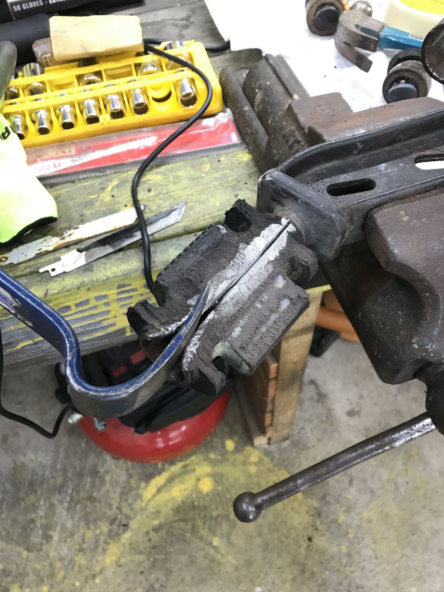

Just to close the loop on this old thread -- I did finally complete the bushing replacement in my front A-Arms . . . this was one of those "easy" jobs that took forever, and I'm not really sure yet if it was worth it or not.
I was plagued by many small issues, like not having the right depth sockets, combined with not devoting enough time to the job. For example, one thing I discovered, is that the ball joint part number (and a-arm design) were changed part way through the 2010 model year, and most on-line parts places list the new ones . . . but of course I have the old ones, so I got the wrong parts.
The biggest issue is removing the old bushings. The best tip for that, is you need a press. I got the smaller one that Harbor Freight sells, and it worked OK; the larger one would be even better because the frame is bigger and would give more room to get things at the right angle. (I went with the small one due to space limitations in my garage, the big one is only a few dollars more.) If I was doing this over, I would first drill some holes in the bushings and let the oil drain out, them press the arm out of the bushing (see photo) . . . I learned just after taking the photo that the bushing will pop and spray oil all over the place, if you don't drain the oil first, LOL

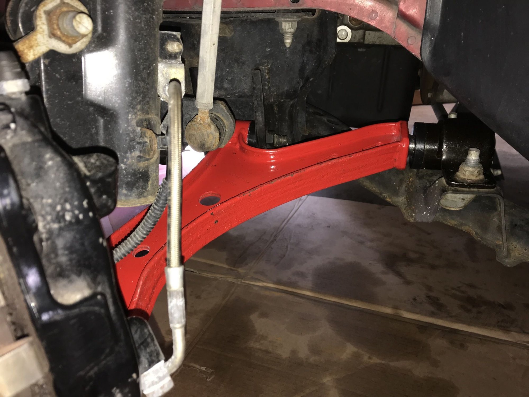

After all this work, I wanted them to look different when installed back in the car, so I painted them red!
Here are some pictures, in case anyone was wondering what is inside those bushings
PS/EDIT -- kinda strange how the pictures posted, I didn't mean to do that, I just uploaded them the normal way (drag and drop) and usually they show up at the end of the post, not the begginning
