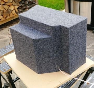

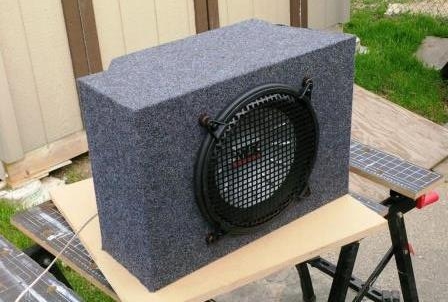

Back in the spring I did a similar installation - an amp and a 12" sub in the trunk, and I replaced the door speakers with MB Quart separates.
My car has the base (non-Sync) system so there's no amp. In order to hook up the sub amp, I ran the 4 gauge wire to the trunk, wired an Audiocontrol lc2i to the rear speakers (to get a line level signal and a trigger wire to turn on the amp), then wired up the amp with the low pass cutoff around 100hz.
For the sub, I built a sub box that tucks in the corner of the trunk out of 3/4" MDF and used an old MTX Thunder 8000 sub.

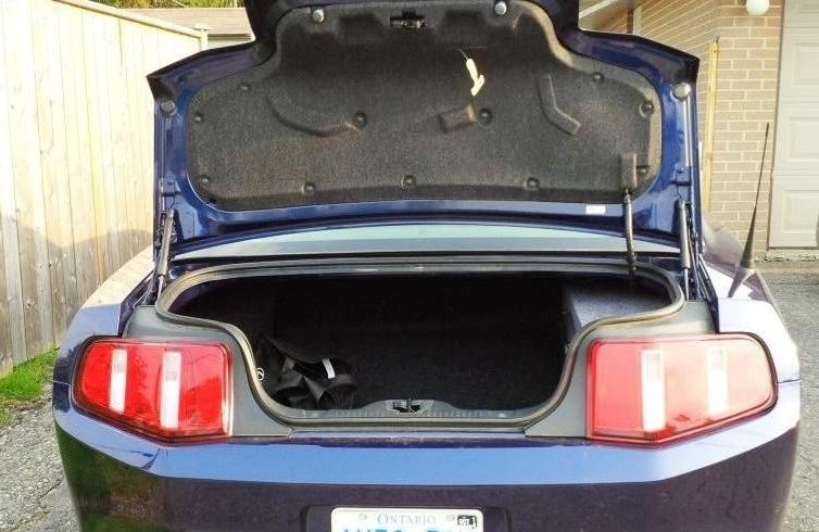

I mounted the amp and lc2i to a board on the underside of the rear deck so the whole setup takes very little trunk room and the system turned out great.

The sub is so powerful that I have it turned most of the way down all the time. I have now built a smaller box for a 10" sub that will tuck much, much farther into the side of the trunk (I have to wait for spring to test that one though).
