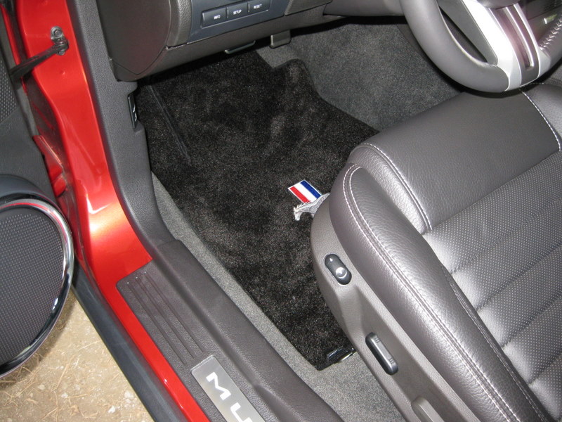

See the slit on the Lloyds drivers side carpet?

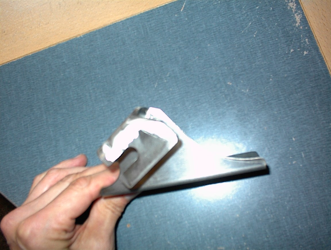

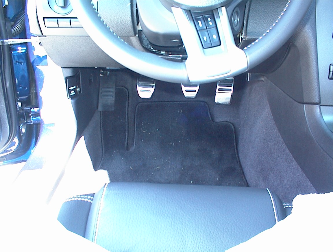

Here's the CDC Dead Pedal and Lloyds mat in my 2011 V6.
Had to modify the CDC D-P though to get it to be parallel with the carpet platform. The inner rocker where it bolts up changed slightly (assume in 2010) so the bottom edge of the pedal was digging into the carpet platform not allowing the Lloyds mat to slip underneath it.
A quick slice off the back corner allowed it to to tip back enough to where it was now parallel with the carped platform allowing the mat to slip underneath.
As others have said, the CDC pedal COULD be a little bigger. But I find it combined with the Lloyds mat gives me the full carpet protection I was looking for.
Had read that some owners were complaining about the Lloyds mat dead pedal platform extension not staying in place (curling down maybe ??), so the CDC pedal definitely stops this from happening too.
