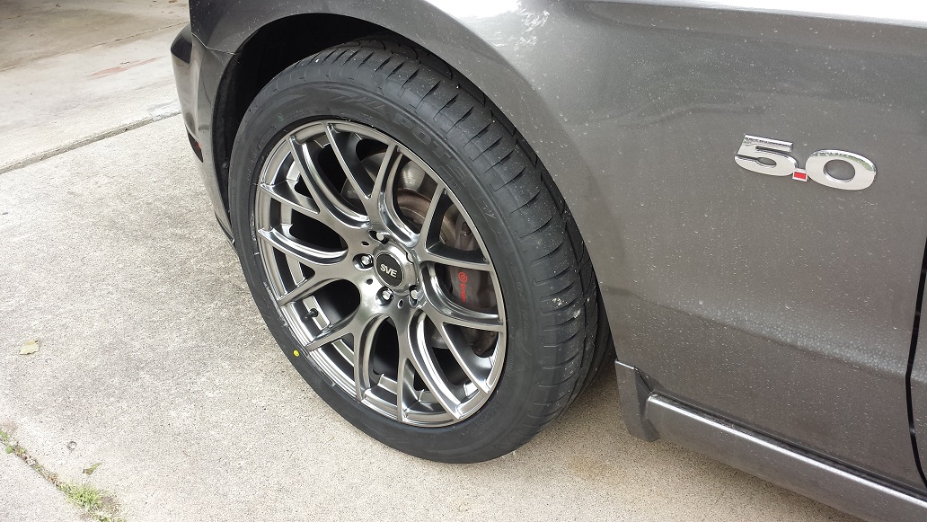

For some reason a lot of people are skeptical about putting 285 tires on the front, but I'm here to say 285/35/19 fit and do not rub what-so-ever.

Yes, it's been done by others, and they look great. Are the rims 19×9.5" ?

correct

Is that how high your front end sits or is it still jacked up?

Yes that's more or less how it sits. It was on a hill in my driveway that sometimes makes it flex.

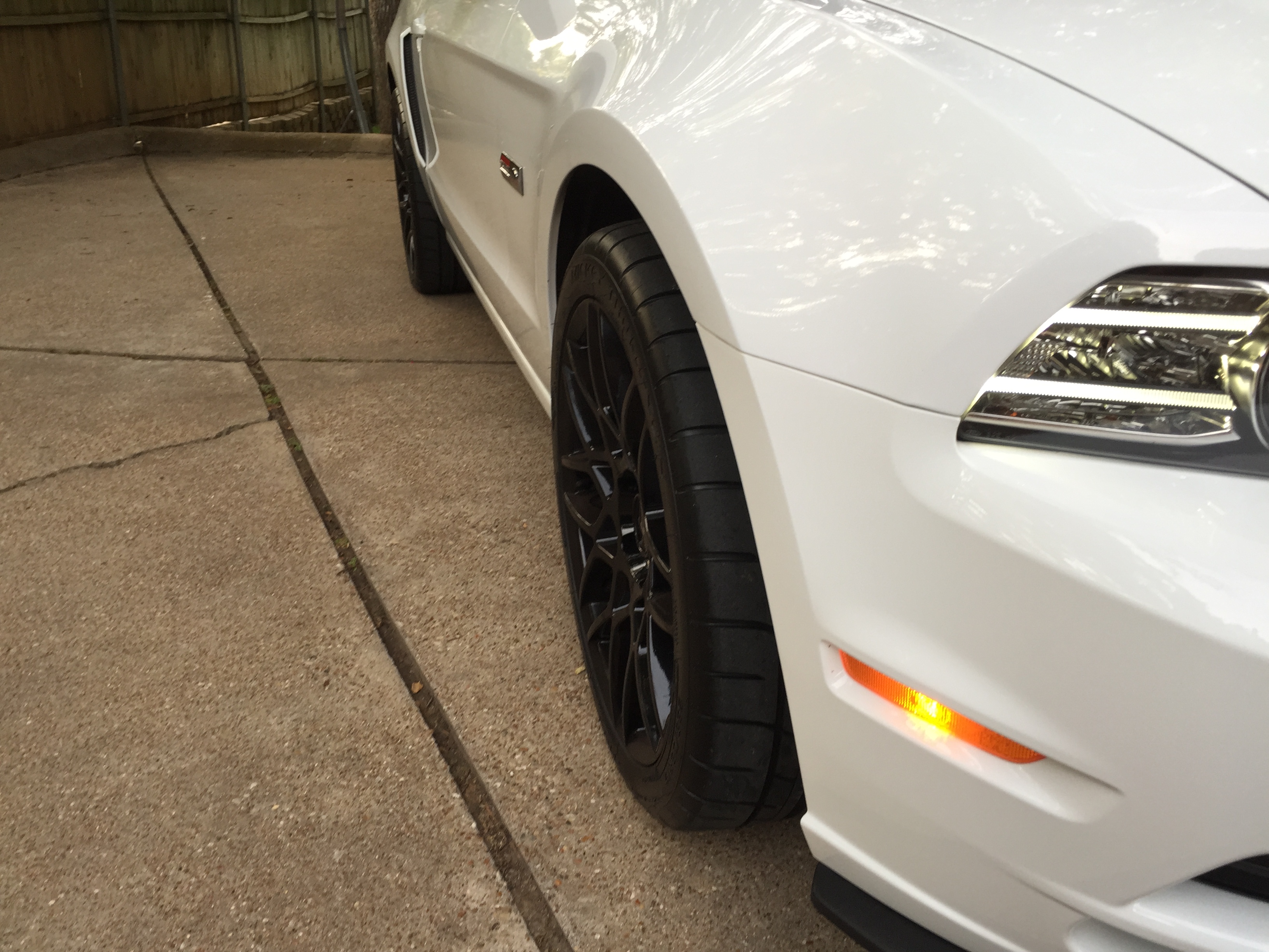

275/40-19s also fit on stock suspension. They are 0.8" taller that 285/35-19

I think most people are concerned with 285's up front when their car is lowered. At factory ride height, it doesn't look like a problem.

Looks good. As to the issue of lowering. I have the Ford racing springs(Lowered 1.25" I believe) with RTR 19 x9.5's all around. No issues whatsoever.

+1 to the OP.
I'm lowered abot 1" in the front, 1.5" in the rear (Eibach Pro) and 285s fit perfectly all around on mine as well.
I don't even know how I drove on the stock Pirellis. No traction = scary!

I should mention that like you, I have the RTR wheels with the +33 offset. They stick out farther than stock by 7mm...
