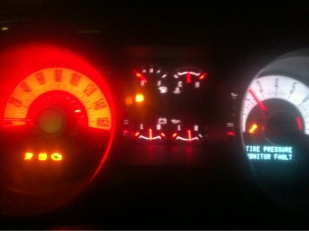

Thanks guys.
The check engine light is on and reverse light isn't working. The little wrench is on too.
The car is on fail safe mode. I went to D and D performance and they said that I need a part from Abbot. I asked him if he can take a look at my car and he did. He said that I should bring it in on Tuesday. They're the only shop thats gotten the speedo to work on a swap like this.
I hear this sound with this trans like a fan but as soon as I hit the clutch it stops. The DD guy said it's because of the twin disc clutch that I can hear the trans spinning. He said another type of clutch may dampen the sound a little.
The MGW shifter is awesome. My car just feels kinda slow because its in fail safe mode.

Your car is probably in failsafe because it doesnt have the proper vehicle speed data to correlate to wheel speed with the ABS system wheel sensors.
Getting your speedo working should fix that as long as its calibrated properly. If the speedo works but its off by a large amount it may still set off the same failsafe.

So I went to D and D and bought the parts needed to get the speedo working. I have an ERA being over nighted to me. Can't wait! It should work now for sure!
So tired of failsafe mode. The car is soooooo slow right now.

D and D. Walsh Motorsports in Wixom MI fixed the wiring!!! They're the only ones in the country that can do it! They even dyno calibrated my speedo! Everything is working perfectly! They did a nice clean job and they did it in one day!
The end of 2nd gear is about 90 MPH LMAO.
4.10 gear or 4.30? Let me know guys. Thanks!!
