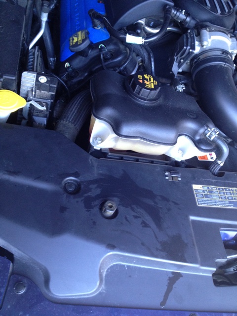

So yes, I am a little OCD when it comes to my property which is why this really annoyed me when I got home later and checked the oil. By the way though, my dipstick was reading full. So, I suppose all is well.
Oh, and they ALWAYS turn my fill cap upside down... ALWAYS! Why? There was also oil around the dipstick... just annoying.

Haha I hate it when I see them upside down. Looks like they set their messy oil can down...real nice I never set the oil can on anything but the ground and I always wipe up anything I drip so the cars that leave the shop don't go out looking like that. Some people don't care and most lube techs are just people off the street with minimal car knowledge. The GM dealer I worked at hired 2 quick lube people who didn't even know how to change oil when they started lol
