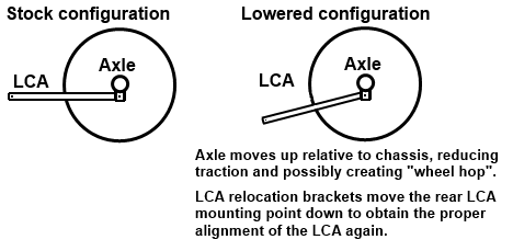

I love my lca relocation brackets. I added them after lowering my car and rear traction was much better.

Have a look at this diagram of lca bracket location:
http://unclenard.com/Pics/Mustang/Fo..._Explained.png

IMO go with adjustable so that you can square the rear suspension up if you plan to lower the car, and if you plan to lower the car depending on how low you may require relo brackets.
