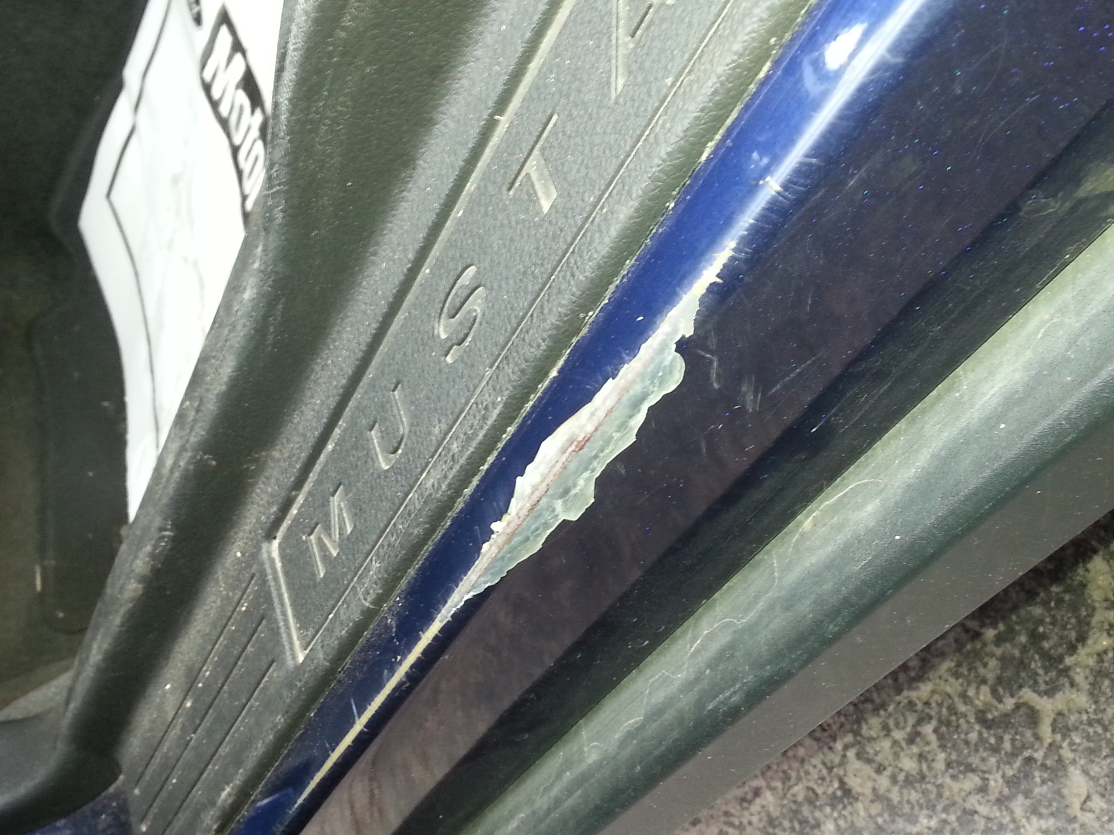

Here is a photo of the door sill. Sorry so close, i had to make the picture smaller to be able to post it.

Thanks for the reply Jazzman. As far as paint goes, I've never owned a car that has done something like that, new or used. My 04 Honda Element with 144K door sill's still look fine. Sigh...

That picture makes it look like the door is hitting that area. My '14 has a paint defect on the trunk, Ford is taking the car Friday to do the work and the dealer is giving me a loaner.

Why do you drive with cleats on?

Great to hear you are being taken care of properly. Yes I basically felt the same way in regards to my door. It all started as a white line, as if something was rubbing and then grew from there. Happy it was taken care of, but disappointed that Ford Service said it was not their issue.
