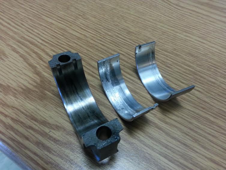

** pic won't upload, will have to try from another computer later.

Picture of the rod cap and bearing shell's should be attached.
Attached Thumbnails 24,000 miles-----motor done--need advice-mustang-rod-cap.jpg

Ouch!! Pretty scored. My main bearing wasn't scored. He just said it was out of spec. Go figure..
