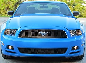

It seems my LED Fog Lamps irritate oncoming drivers when used with my headlights. I am wondering if they are aimed to high or if oncoming drivers just assume my brights are on because there are 4 headlights on my GT at that time. Are there any Fog Lamp adjustments? Does anyone else experience this?

Its because the grill mounted lights are NOT fog lights. Fog lights are small, mounted low, so as to see under the fog.
You are turning on the driving lights - which is blinding to oncoming traffic.

Have you turned those lights on in a fog bank or blowing snowstorm? They'd be worse than high beams. Fog lights are low to cut under the cloud bank.
Regardless of Ford's adopting the 'fog light' tag in the OM that the current crop of Mustang owners keep pushing, they are mounted high and aimed further so as to see waaaay down the road at high speed night driving. Think LeMans.
That's why you're getting flashed by oncoming drivers. And compare the location of fog lights with every other manufacturer. Fog lights are always mounted low and less bright than headlights (and driving lights).
The grill lights have never been fog lights since they were introduced back in the day.

They're not truly either one. They strike the road surface too close to the front center of the car to be real driving lights, and are not mounted low enough to be effective fog lights, but they look cool so I tinted mine yellow.

I was just informed: "Yes, there are height adjustments on your fog lamps. Pull the large plastic radiator cover and you should see an adjustment screw on each lamp housing. Park about 8' from a garage wall or other surface with your fog lights ON. Adjust lamps by turning adjustment screws equally. It shouldn't take many screw adjustment revolutions to drop them to a less glaring level."

I've driven through heavy fog a few times, they are remarkably useless as actual fog lights. But they are nice when you're driving on a really dark road that has no street lighting. A dark road is something I encounter much more often than fog so I like them just as they are. Plus I think the lights in the grille look good, I don't like the GT with the fog light delete grille.

Yours must be adjusted differently than mine, because mine are aimed very low and illuminate the area right in front of the car.

One thing that I didn't see posted, in many states (like here in Oregon) the fog lights are treated like headlight high-beams. They must be turned off when approaching oncoming traffic. So if you have them on you'll often get flashed by oncoming traffic. Also, I got pulled over by a traffic cop for having them on, so take notice. I had no clue. I just got a warning and the obligatory 'I used to have a mustang' story.

If they truly were "driving" lights then they should work with the high beams. Ford intends them as "fog" lights and as such only work with the low beams.
Either way, they are mostly cosmetic.
