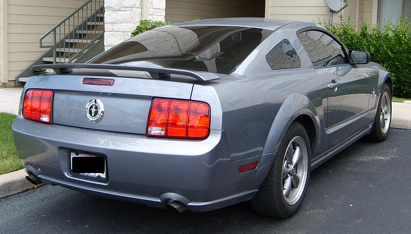

I had a 2006 V6 Premium that I added all kinds of aftermarket parts too from the GT and so on. I literally had people that worked at NTB asking me how I liked my GT - NO ONE could tell it was a V6 - even with the pony badges rather than the GT ones. I didn't want to make it too much of a poser, so I left those on there - haha
These are all the mods I had on it - cost me a couple grand, but was WELL worth it
Rear springs (2 inch drop - remove rake)
14" shorty antenna mod
Black/clear turn signals (front)
GT take-off dual exhaust & GT bumper
Ninosport dual exhaust conversion kit (y-pipe/cat-back)
GT take-off side skirts
S&B Cold Air Intake Kit
Apex Throttle Body Spacer
