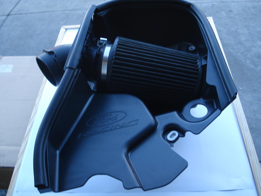

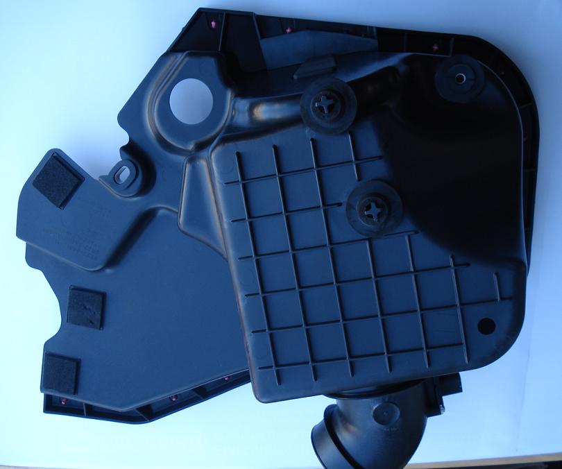

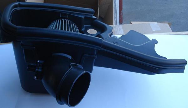

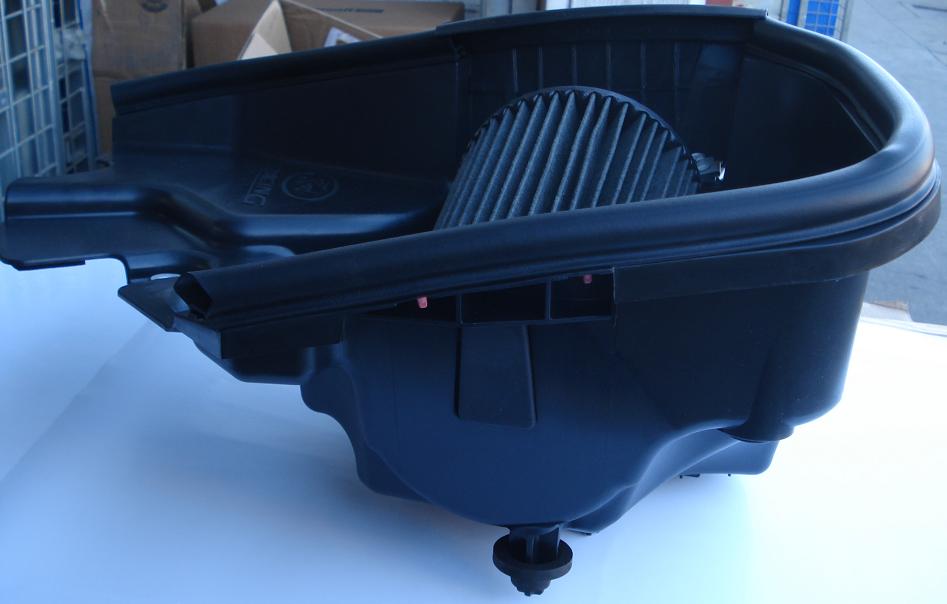

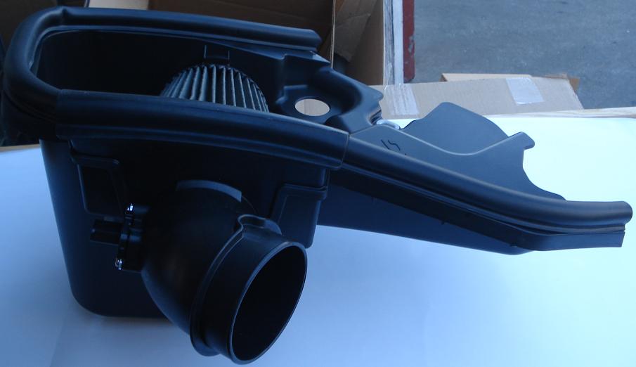

here Is The Long Awaited Bullitt Airbox! Should Be A Popular Retrofit! It Is A Stout Piece And Oe Quality! That Air Filter Is Paper Btw! I Am Still Waiting On The Pieces From The Elbow To The Throttle Body! More Pics When I Recieve! Btw The Other Intake Piece Has What Appears To Be An Intake Resonator Like The 05 Automatics Had. I Am Sure To Keep Intake Noise At Bay. I Would Guess Some Will Want To Eliminate That! Anyway This Is All For Now! AS USUAL YOU SAW IT FIRST ON TMS!
enjoy
kc

Doe it have any "adjustability"? Would it work with a Steeda elbow? anyway to check?

i wonder if this would work with a jlt intake???
that would be a cool retrofit

It certainly would be. I find aftermarket airboxes "cheesey" at best.

Nice factory piece no doubt.

A Few things to Take into consideration is this is a Stationary Box. Most if Not All Aftermarket are Floating to Some Extent. That is they Move with the Engine. So in Order to Use on one of those Systems the Filter Itself Can Not Be Totally Bolted to the Box Like the Factory Setup. Some Variations will Have to Be Addressed to get the Most out of the Box Setup. I would Be Curious what would Happen if the Complete Intake Setup were Merely Bolted On to See What would Happen as Far as Power Increase. Then a Tune For Optimization. That would Be Valuable Info Indeed! Of Course The Main Advantage Would Not Be Really Reflected on the Dyno which is The Inlet temperature Going down the Road on A typical Cai vs the Box Setup. Time Will Tell!
KC

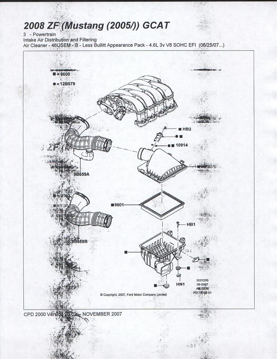

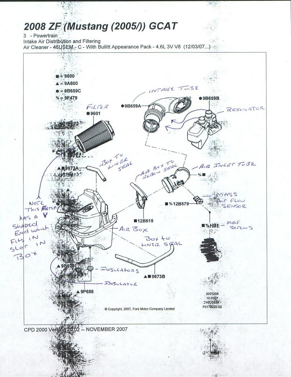

Here is the Parts Breakdown. Sorry For Our Lousy Printer. Some Components are Available Seperately or In Sub Assemblies and Combinations Thereof. I added Descriptions for Some Clarification. Non Bullitt Setup Also Shown For Referance.
KC
