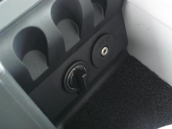

I apologize for my ignorance, but what type of cable does it take to connect the ipod(nano) to the line in jack? A cable with a male mini-jack on each end? Thanks.
Attachment 4458
Attached Thumbnails Factory MP3 plug-in for 07's. Can I get one for my '06-auxjack.jpg
Old Jul 10, 2006 | 07:01 AM
05fordgt's Avatar
Joined: June 19, 2004
Posts: 6,840
From: Phoenixville, PA
Attachment 4458
No apologies necessary friend. Yeah, a male plug on each end is required. I got one of these with my clock radio, as it is Ipod friendly. It just isn't long enough to reach the socket and keep the Ipod ini the cupholder. I'm sure you can go out to your local Radio Shack, and find the one your looking for.

So all this does is allow you to play your Ipod though a hardwire setup, but not control it, correct?

I have an '06Gt that I would like to get the Aux port functioning for my Ipod.
Can you tell me what is required?.. Ford or other part numbers Is it just a harness to the radio? or is an interface unit, like the PIE required?

The wire thats on the picture that KC posted would cost way too much. The reason being, the aux wire is wrapped into the same loom as the power point. The bad thing, is the restraints control module also comes attached and this part controls all the safety items in the car. This part makes the loom cost well more than the PIE or Peripheral units would. So for now, the factory ipod connector on 2007's aren't able to be added easily. I am looking into taking apart another '07 we have, to get the part numbers off the plug on the radio, and console, and making my own, maybe.
You would be able to control you ipod normally would, using the click wheel. The difference between this and the FM modulator is that this is digital and no static.

Hey Chris. whats required to make this work is the wire that goes from the radio, to the center console plug hookup. In the console of 2007's is the female part of the plug. The only problem, like I mentioned above, is that the wire isn't available by itself. You have to buy the whole wire loom, and with that comes the restraint control module, which jacks up the price a whole heck of alot. If the loom only had the power point and the aux wire, the cost would be a lot less, and all you'd have to do, would be to cut the tape that holds it all together, and install it. There has to be a way to get this in our cars. I may be taking apart another '07 we have, and getting the part #'s of the 2 plugs, and making my own, maybe.
