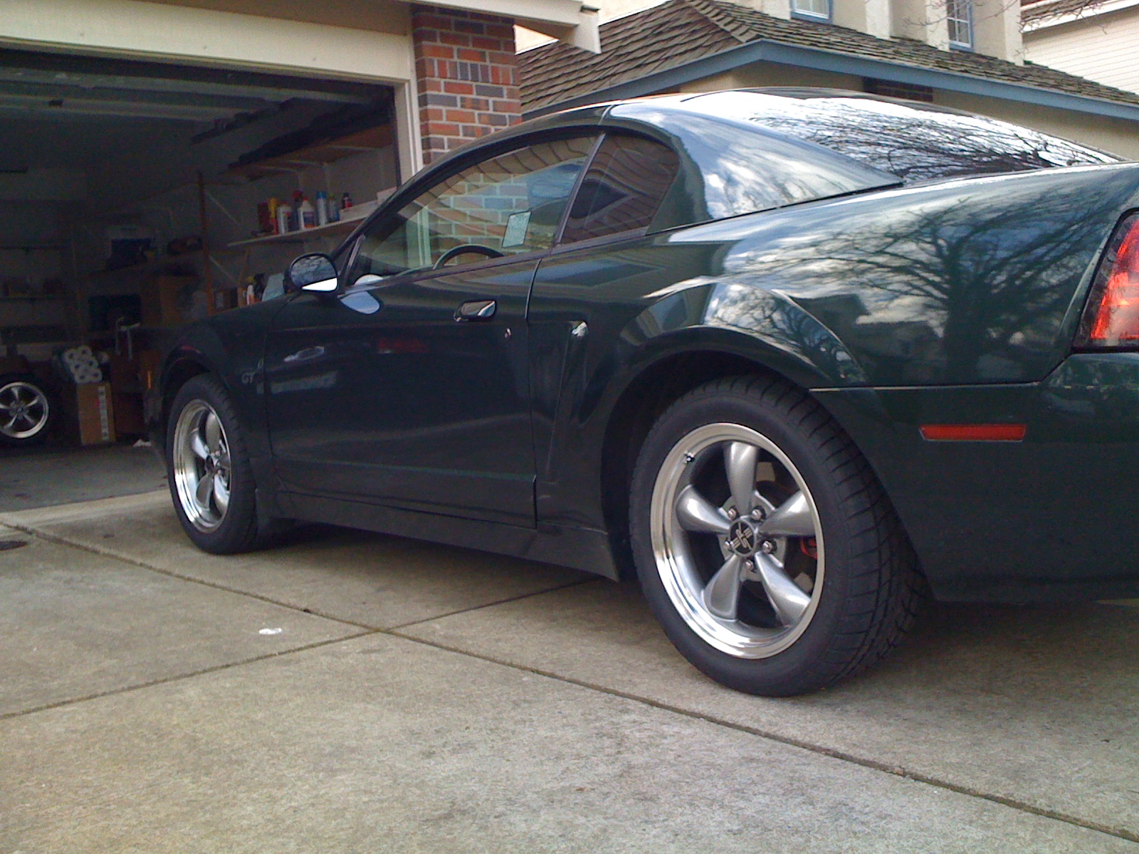

Finished
OK, I finally got my proper SN95 wheels . . . . . . . recall the previous owner left me with S197 Bullitt Wheels/tires . . .. . . this caused (1) front wheel rubbing noise when turning (2) A strange look (rear wheels WAY inboard) . . .. . this is all caused by the 0.5 inch backspace difference between the S197 and SN95 wheels . . . . . I think the car looks great now with the new 17X8 SN95 Bullitt wheels I just bought from americanmuscle.com with Sumitomo tires. And I was also able to sell my S197 Bullitts on Craigslist!

Nice!!

Much better looking! Now nothing is wrong with that bullitt
