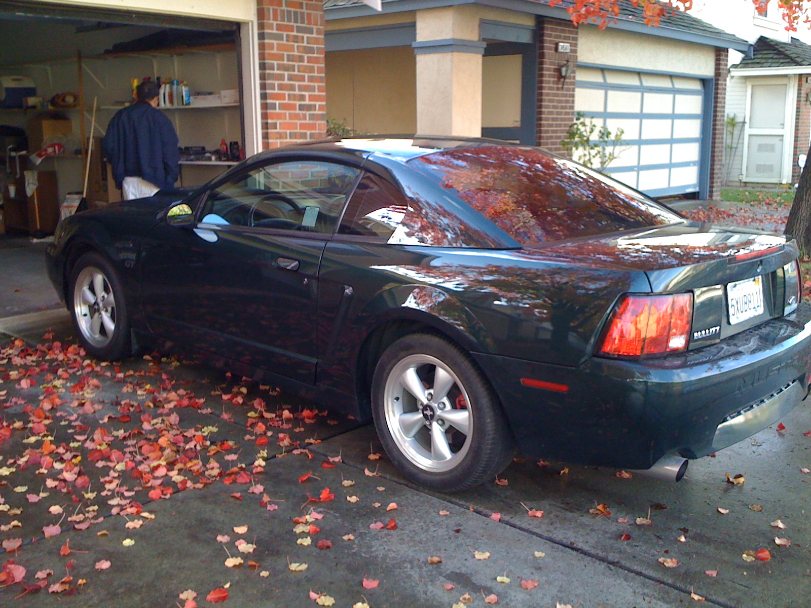

Can anyone see anything not correct on this Bullitt? Not correct as in not stock . . . . This is a good test of your Mustang knowledge!

Wheels look silver instead of gray? Exhaust tips are supposed to be rolled too I thought?
Edit: Duh, you have magnaflows.

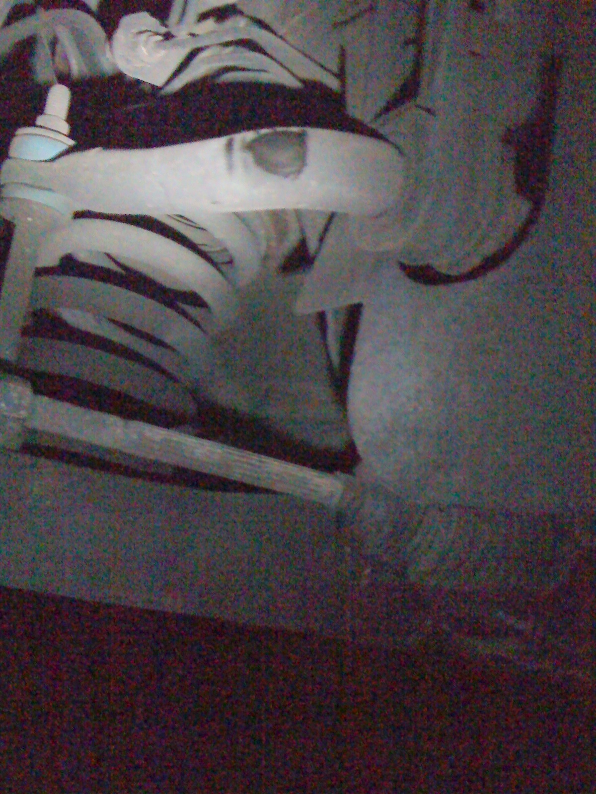

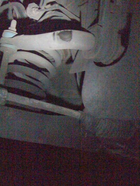

I have been scratching my head on this clunk I have been hearing when I have the wheel complete turned since i bought my Bullitt last month . . . . . .today I FINALLY figured it out with a guy from a tire shop! I have S197 wheels on my Bullitt without the proper spacers! This also lead to a rub marks on my suspension arms (see pictures). I am going to buy a set of spacers today from New Take Off . . . . . . Some one in another thread said these come untorqued quick . . . . . . .Are spacers the only fix? Other than buying new wheels?

Time for some DD's.

Why not obtain a set of proper Bullitt rims (or replica) with correct offset instead of spacers?

Should I get 17 by 9 s or 17 by 8 s . . . . I am leaning towards 17 by 8 s . . . I am trying to get this car back to stock handling and fit . . . . I am thinking about the black bullitts from from Ford Racing ($180 at tirerack).

17x8s are OEM size. You just need to decide if you want FRPP, some used OEMS, or aftermarket.

What is "wrong" with this Bullitt??
It's not in my driveway.

and i was going to say the side skirts.

I was gonna say either the exhaust tip or the red caliper

OK . . . .. this is what I am going to do . . .. . find some used OEM 2001 Bullitt wheels, then sell my Ford Racing S197 Bullitts . . . . . any takers????

Exhaust tip is a magnaflow . . .. . the red calipers are stock Bullitt

I believe the side skirt is stock . . . . .

ah, i was thinking the bullitt came with the standard GT side skirts.
Well then I win
It's not stock bullitt

The exhaust isn't OEM, that's what wrong
