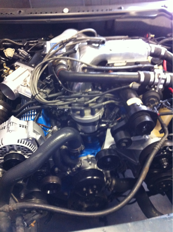

Just installed mine in 331 stroker used an earlier block higher nickel can be adjusted, by switching pulleys from 6 to 12 pounds of boost!
